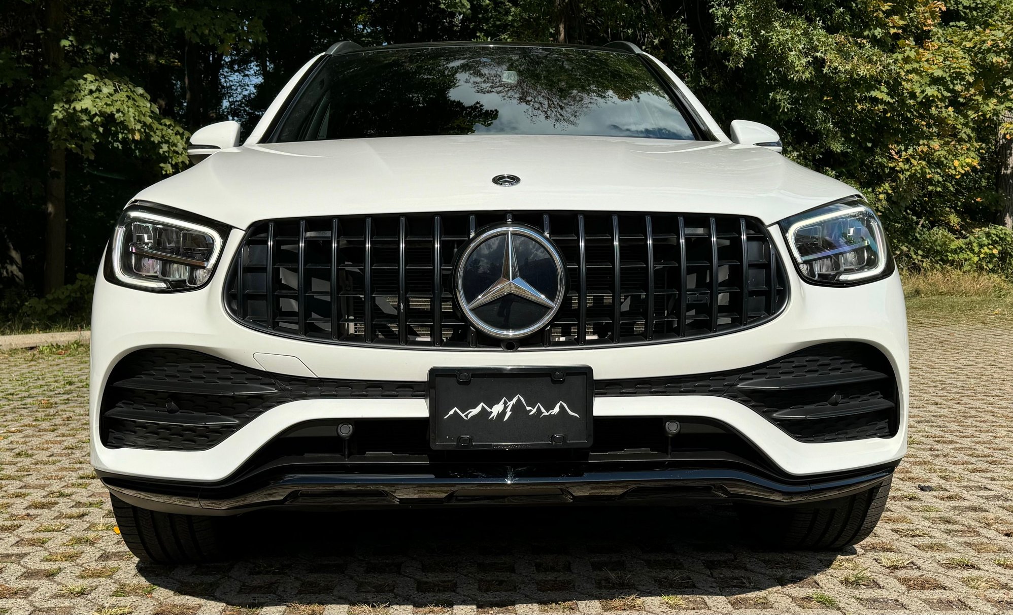

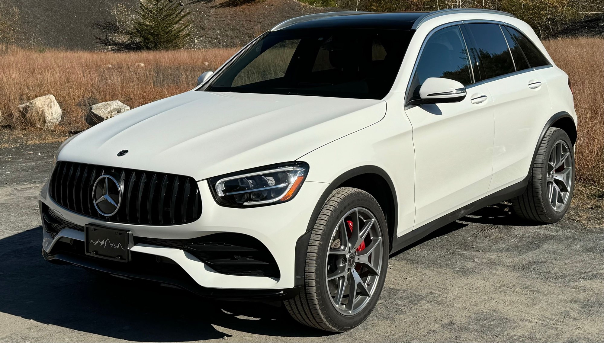

I can confirm the conversion in this thread can be done. I went with all-black but required an additional part that sits behind and above the three parts identified earlier. The parts included:
Part Number Part Name
253-885-25-04 Trim Molding
253-885-26-04 Trim Molding
253-885-28-04 Trim Molding
253-885-13-04 Cover, Bumper Area
I had the work done by Mirror Image Detailing in West Orange, NJ (https://mirrorimagenj.com/). The owner, Matt, a detail-oriented perfectionist, removed the bumper and said it was a simple swap but also said the additional fourth part had to be swapped-out as well.

Hmm, not sure why my post showed up twice; but to answer your question:
A local dealership wanted ~$700 just for the parts. I shopped it on the internet and found a dealership in the Northeast that sold them to me for 50% less. The parts were shipped directly from MB Corporate. I'm not sure how they could do it but I'm guessing the dealership gets a volume rebate or something.
Installation was reasonable but I think I got a volume discount as I had my detailer do a bunch of other stuff: ceramic coating; amg grill swap; and painting the calipers.
