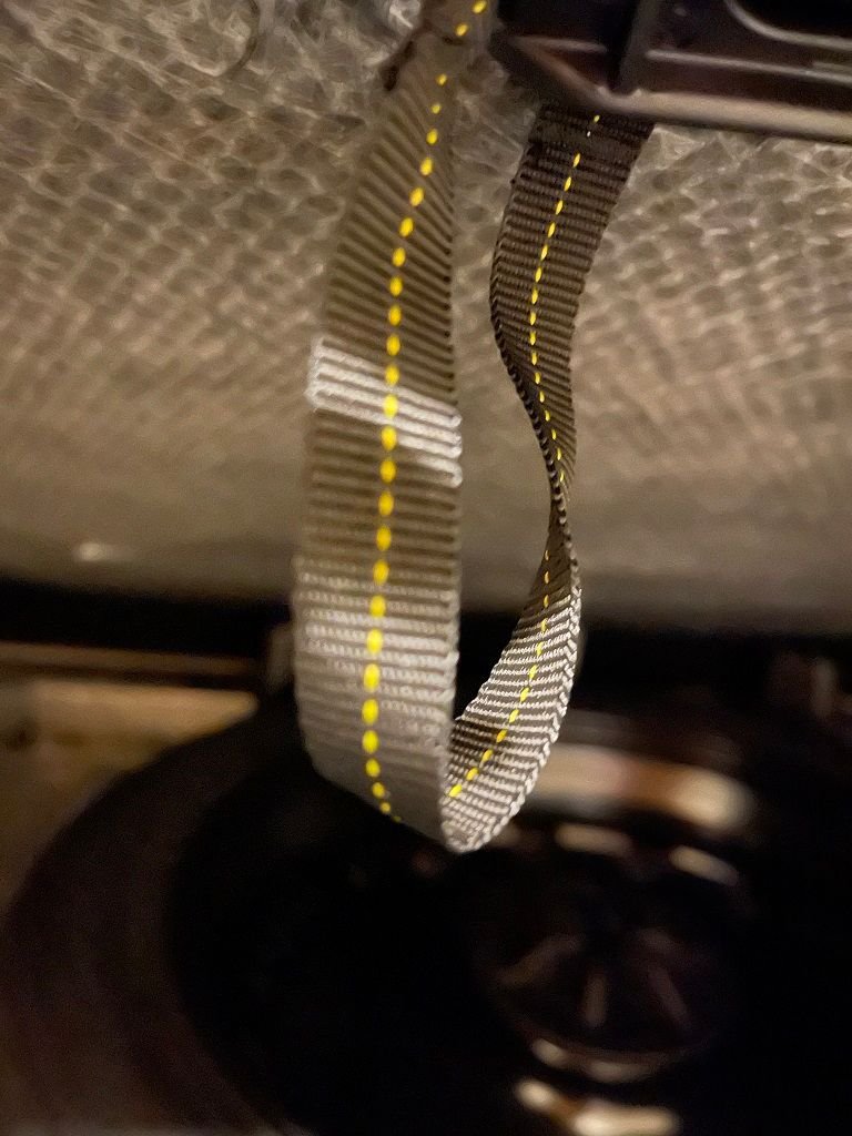

A short bungee cord should work - the strap is pretty cheezy on my 2020 - took a pic for you.

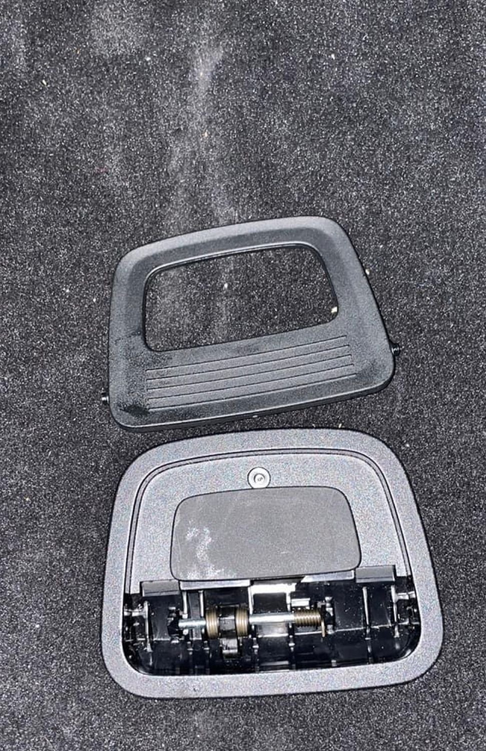

Cargo compartment floor handle broken
The cargo compartment floor mat handle is broken.
How can I open it now since I have the charging cable beneath? 😥
This handle is broken in my GLC 300E. How can I open it now since I have the charging cable beneath
Old Nov 1, 2022 | 11:49 PM
GLCDon's Avatar
Joined: Mar 2019
Posts: 32
Likes: 8
GLC300
use a screwdriver or pen to push down on the top of the piece just left of center between the coils. That will release the latch.

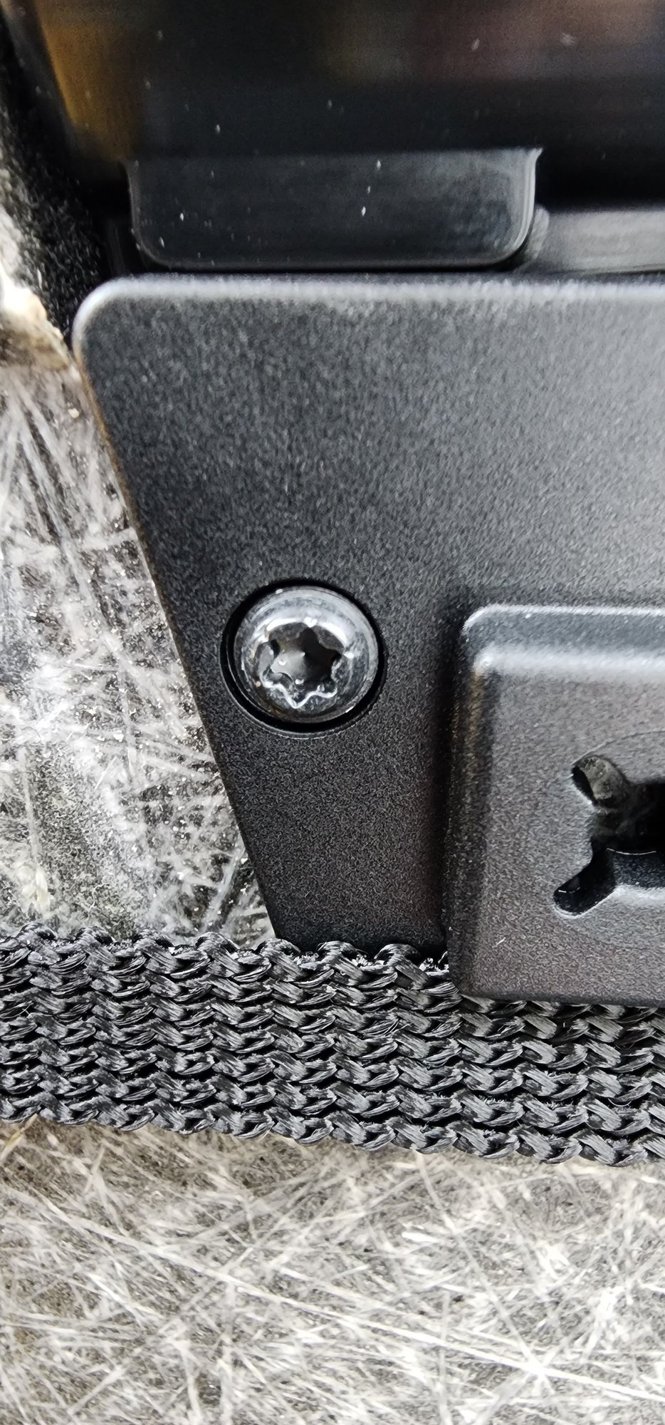

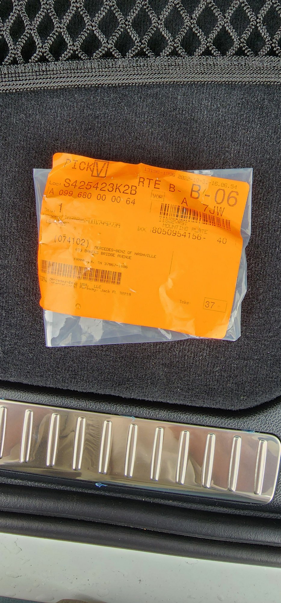

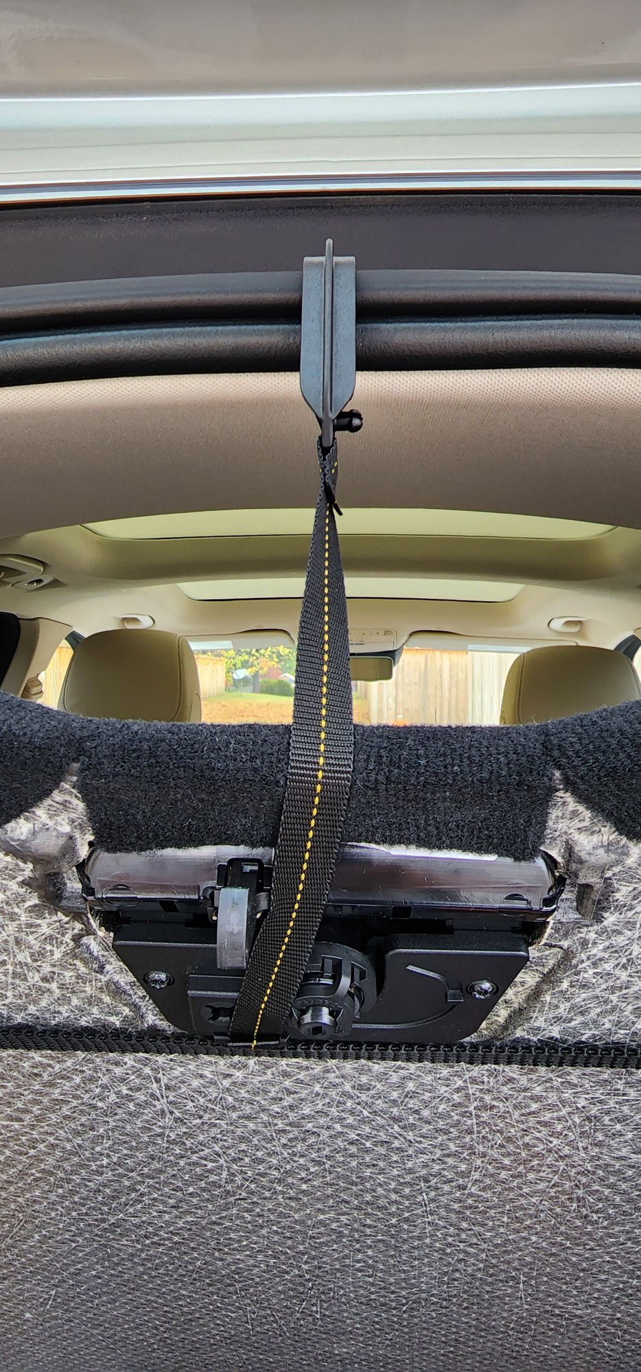

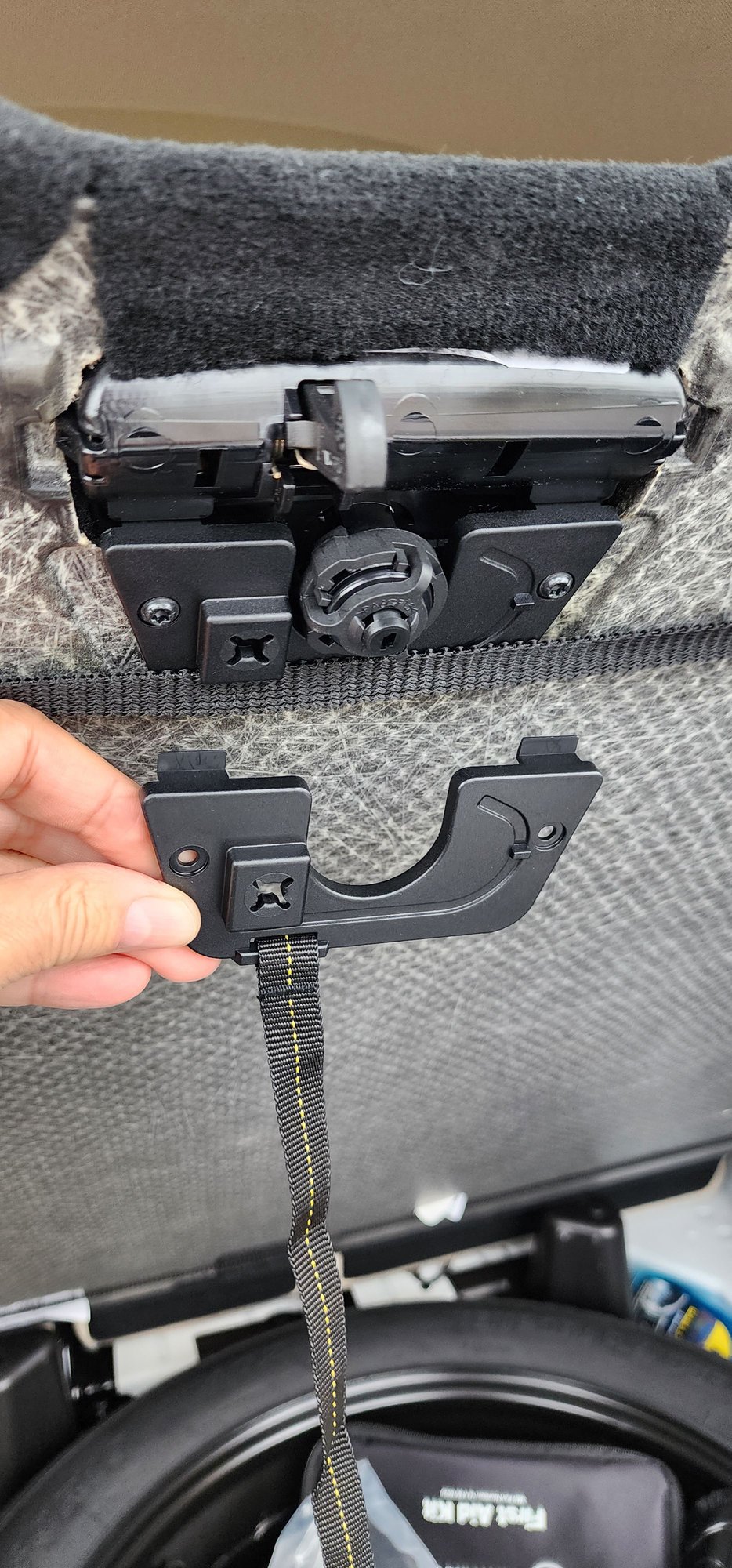

We own a new 2022 GLC 300 4Matic SUV; 'love the automobile. Nevertheless, it's hard to fathom that we're all spending our valuable time discussing a purposely omitted 2-bit Mercedes part...quite frustrating! This morning, $32.93 (including tax) later, I picked up the needed part. The strap and hook are sewn to a new cover plate; in other words, you have to replace the existing cover plate with the new cover plate + strap + hook. When stored, the plastic hook snaps into the cover plate. 2 torque screws hold the cover plate; you will need a torque head screwdriver. The retrofit is certainly convenient yet very cheap and low tech...grrr. This cargo floor lifting strap/hook debacle...Android Auto display issues...as a rookie first time Mercedes owner, such rudimentary basic problems are far beneath the Mercedes label...so I thought. Images attached...

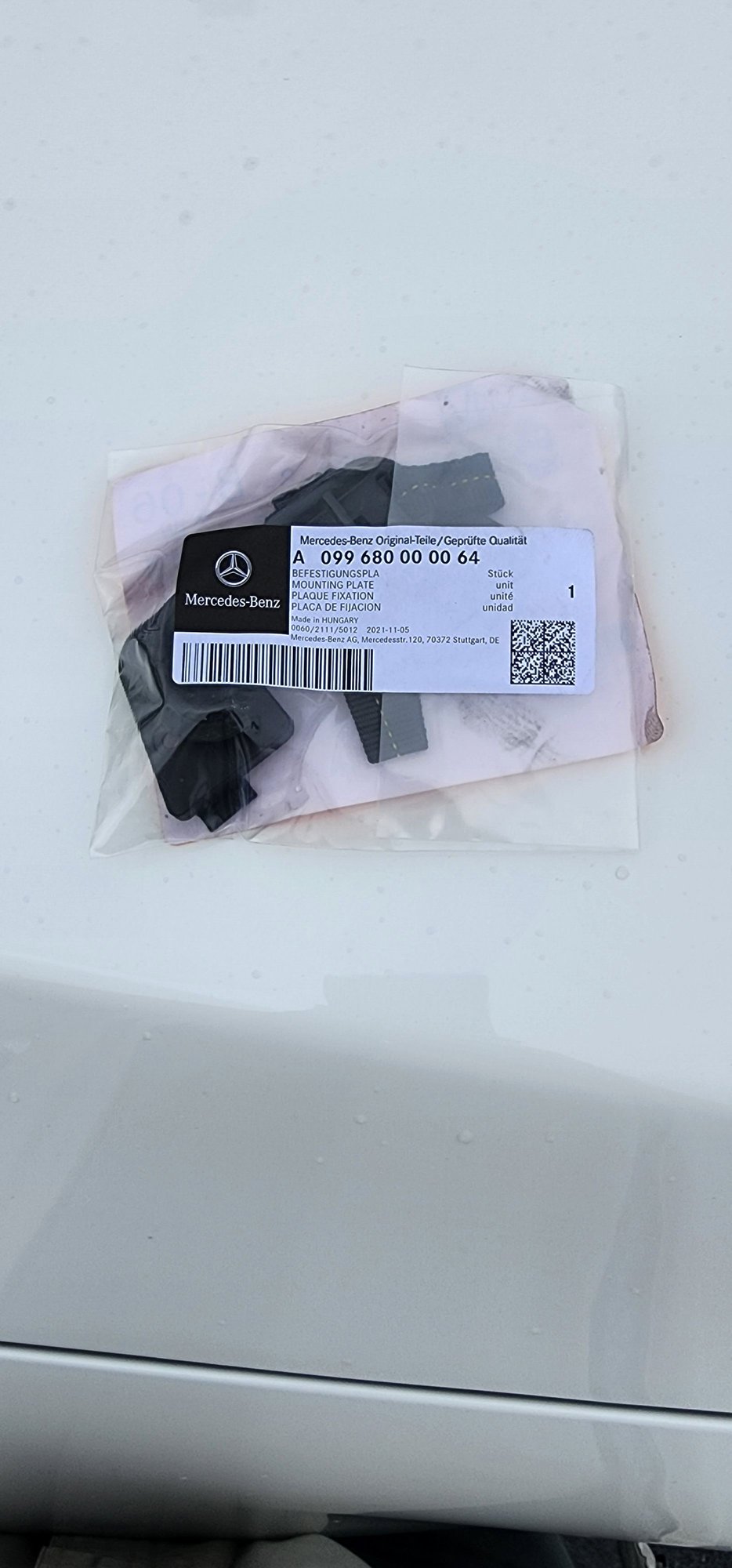

Why is your part # different than the one that others have referenced? They’ve said the part # is 099680011164 but your picture shows 099680000064. Based on the picture in the MB online catalog, the # on your picture looks like it’s for a different part.

Good question...I wish that I had a good answer. The parts department took a good 15 minutes or more, consulting with each other prior to locating the part on their MB parts site. All I know is that it works, and I must admit...very handy.
099680011164 is #9 in the diagram below, "Floor Cover Plate" @ $25 and MBParts says it fits my 2015 ML400 but not the 2022 GLC300; 099680000064 is #8 in the next diagram, "Mounting Plate" @ $29.50 (though it's on sale for $23.33 at MBPartsCenter) and seems to fit either SUV. Go figure.
