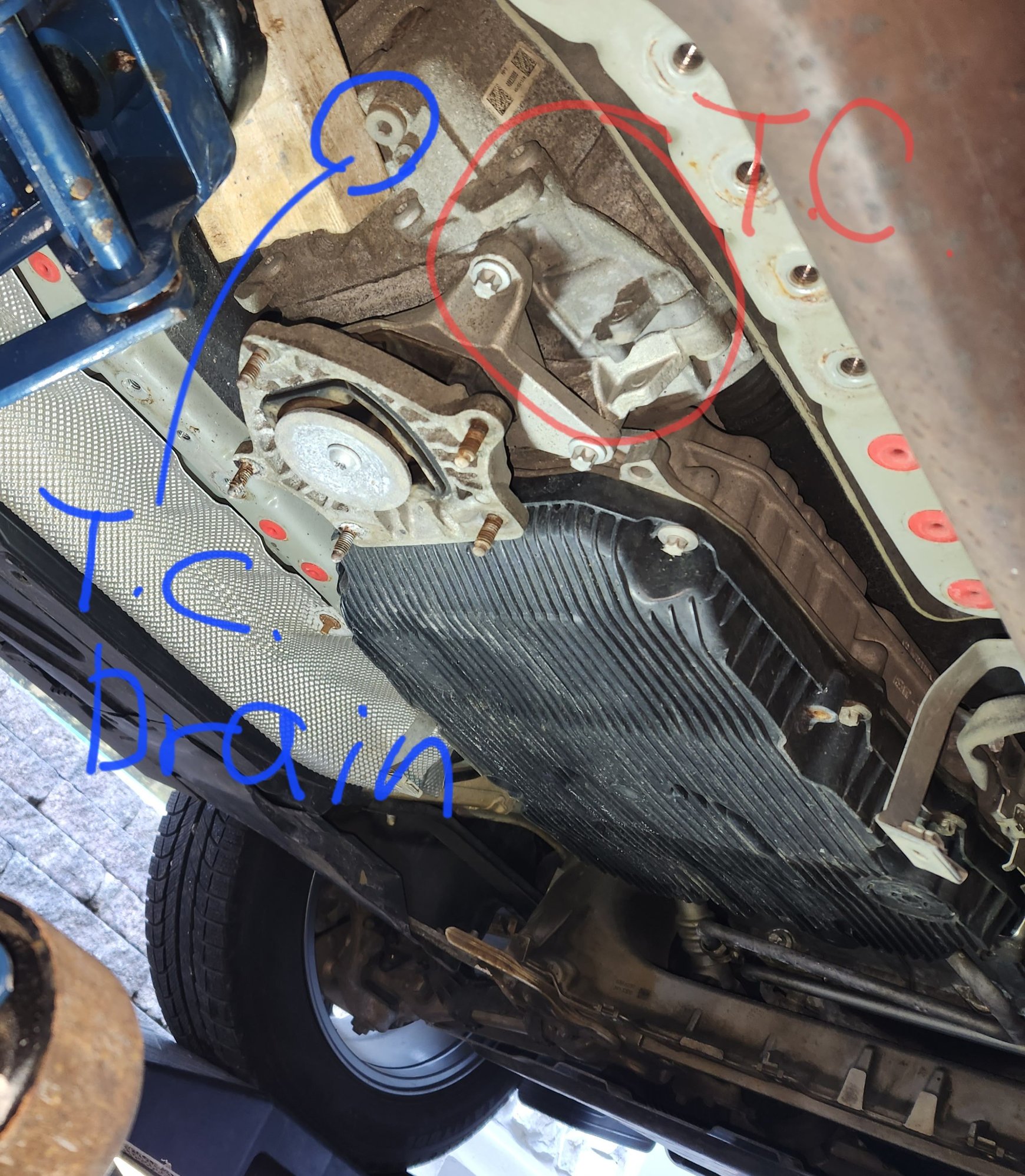

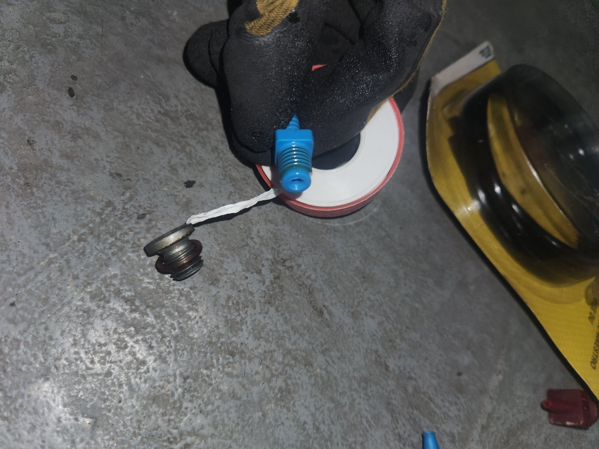

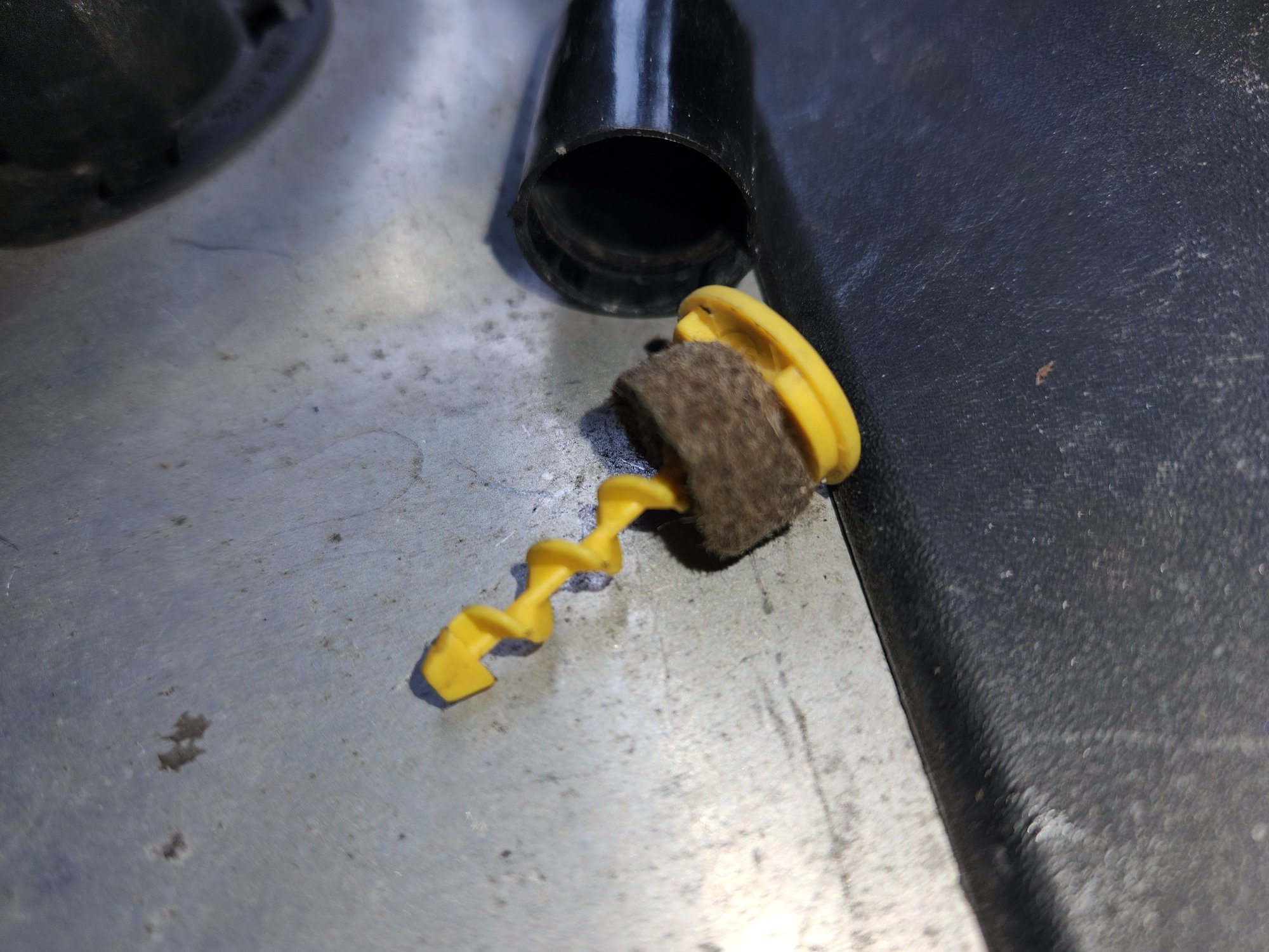

Finally I got time to replace fluid in transfer case, frond and rear diffs at 39K miles.
TC has similar concept as trany, there is a little tube you have to pull in order to drain the fluid, and use pump to get oil up in the case. Could be easier but not bad. Diffs are simple, except front I couldn't get H14 with socket, had to kick out the bit and user it without socket using wrench.

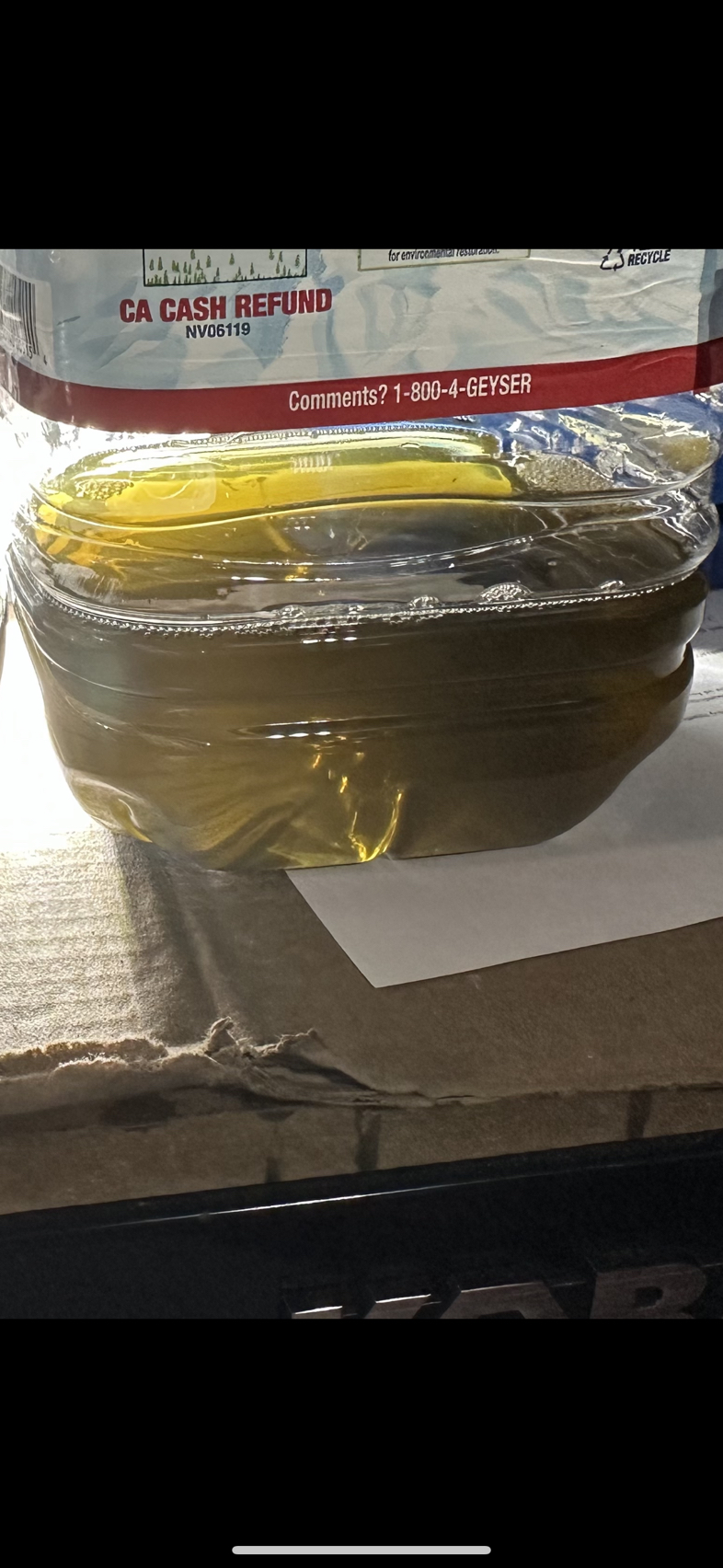

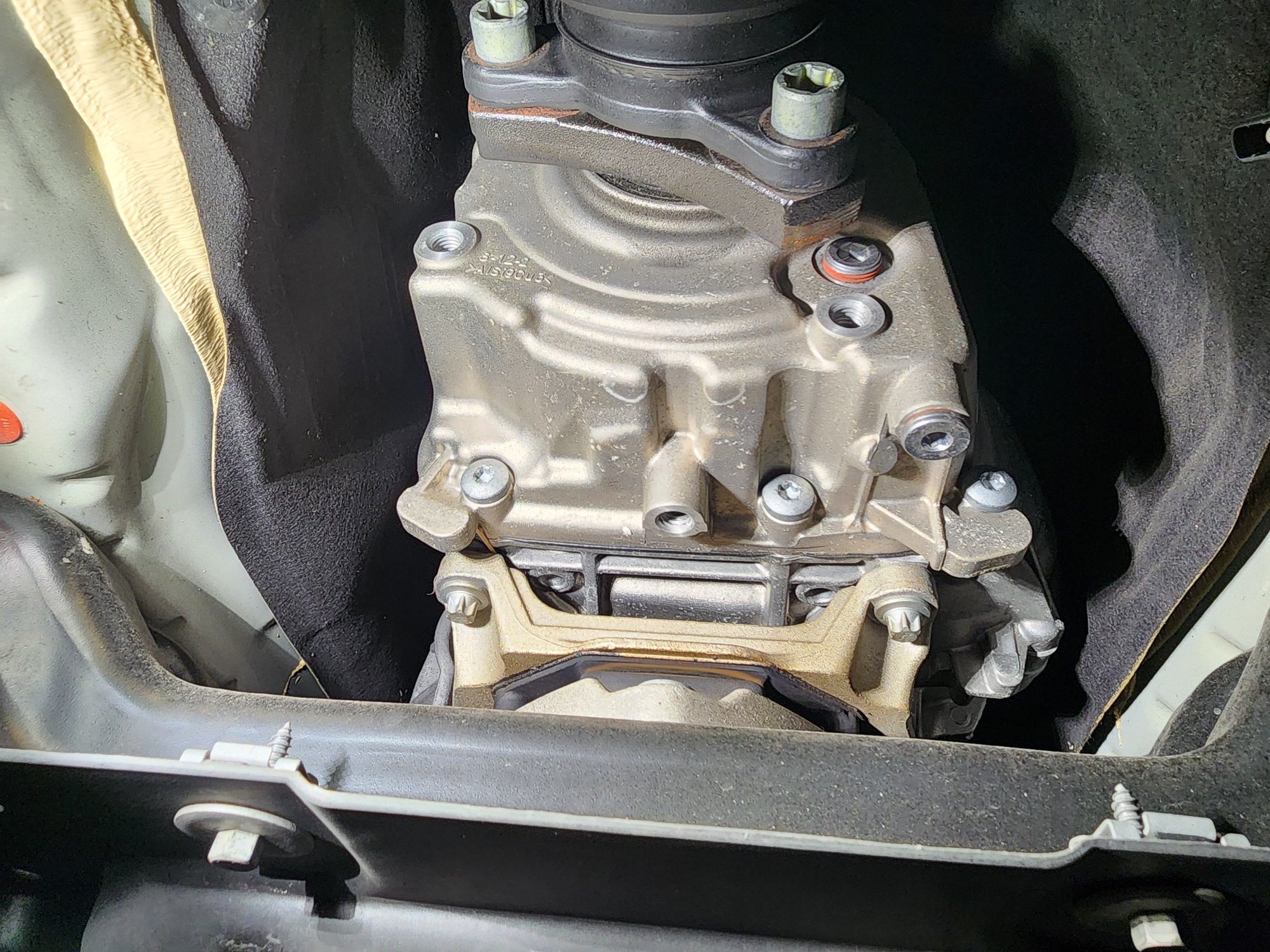

Old fluids:
Transfer Case
Rear diff
Front diff
In TC and rear used Ravenol, simply because I had 2L of it and it meets the spec

Transfer Case fluid replacement
What is the bolt with the orange thread sealant? Could it be a fill plug on the transfer case. The WIS calls it out as item 1 but doesn't describe or refer to it.
What is
What is "1"?
Old Oct 6, 2025 | 05:32 AM
sn202020's Avatar
Joined: Jan 2020
Posts: 210
Likes: 79
From: Canada
2017 & 2022 GLC 300 4Matic
What is
What is "1"?
That is the TC overflow plug (1) . However MB instruction document says refill thru the drain plug (2) like this YouTube
But when I did my TC job, I drained 150ml by drain (2), then I pulled out the plastic level pipe inside of (2), then it drained another 500ml. So total 650ml drained, which was the same new oil amount I refilled thru the overflow plug(1) instead of (2)
Old Oct 6, 2025 | 07:00 AM
no_mulligan's Avatar
Joined: Apr 2007
Posts: 311
Likes: 73
From: Richmond, Virginia USA
'12 E550, '10 ML350, '06 E350, '20 GLC300, '21 GLC300
Thanks SN202020. I think I will follow your approach. I noticed that I didn't have a level screw on my TC. That's what had me wondering about a fill bolt.
