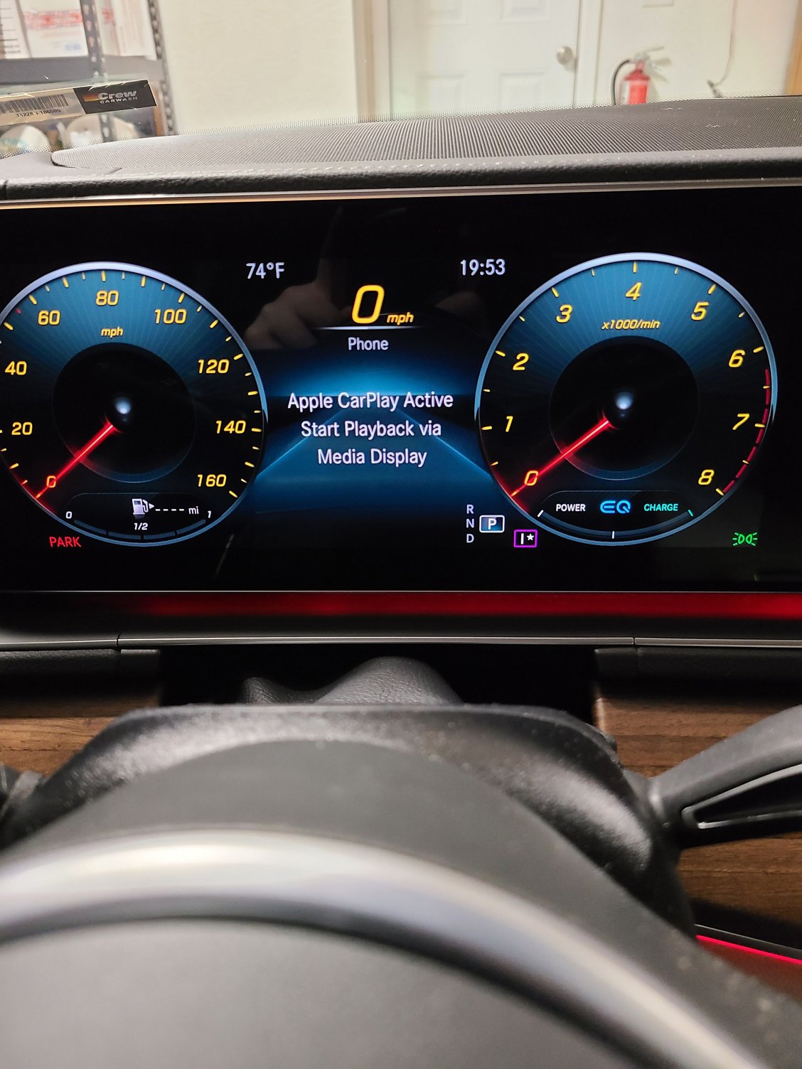

I tried the U2W carlink 4.0 and although it was nice to have a wireless connection, I'm not sold on the product. Why? I use the center portion of my GLE 450 gauge cluster as the method to change what is playing and to see what is playing. This device shows a static carpay verbiage, when I'm actually using Android auto, and it does not allow me to use the steering wheel buttons. I will return to using wired AA or something else

Originally Posted by Carlinkit Carplay
Q: Can't control the phone call or volume through the steering wheel
A: Please enter the background and turn on Sync mode. If it still can not control, please upload the log and send thescreenshot to the technical.
unable to get into the background. The browser says it took too long to respond and timed out. Although the wireless connection works, not only does the center gauge cluster not work, the controls on the main screen don't work as I do not have a cursor to select the available menu options.
Center gauge cluster Bluetooth connection
Center gauge cluster wired Android auto connection
Center gauge cluster carlink 4.0 wireless connection.
