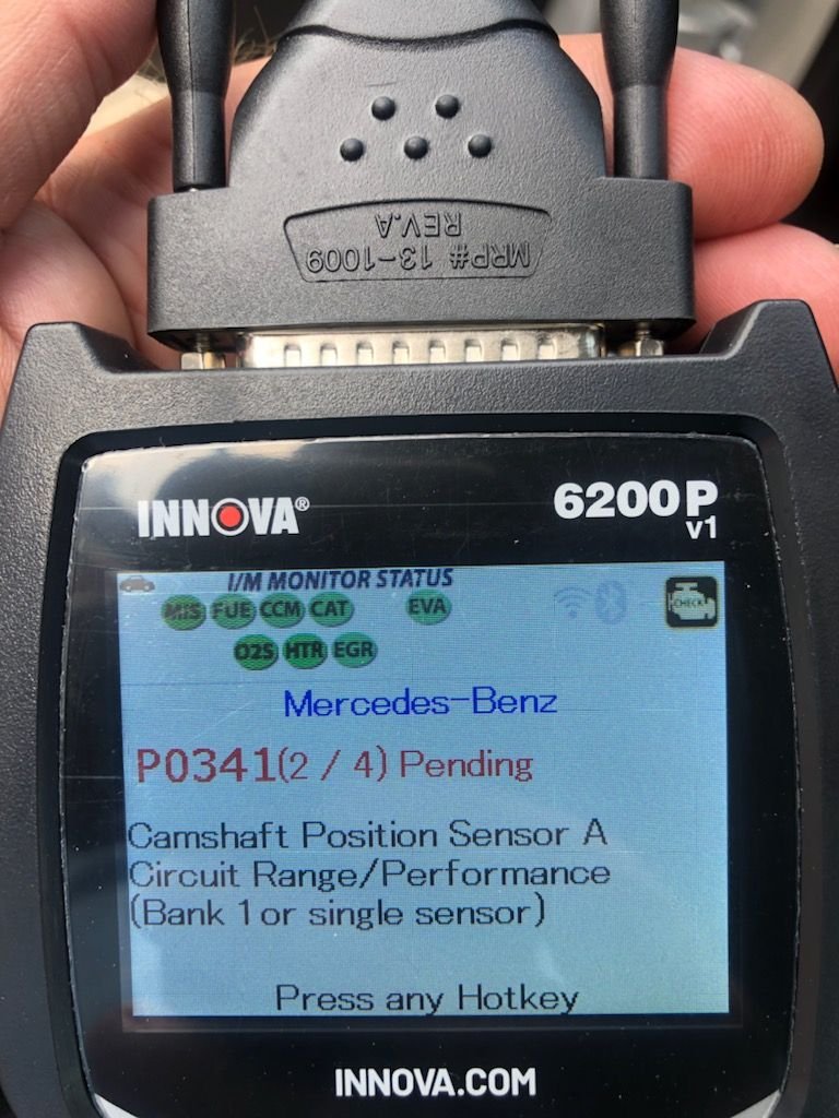

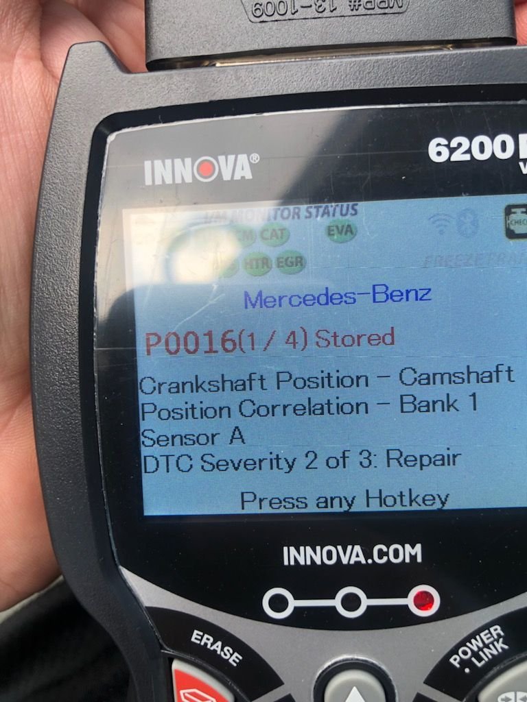

Beware!! Apparently this is a very common issue, so common that the dealership was able to tell me what was wrong with my car without having to even look at it themselves.
First, a grinding noise would occur when turning over the car from a cold start. This would last only 2 seconds but was bone shattering when it would occur. At first this was intermittent and quickly became persistent whether it was a cold start or not. Then the car started to turn over very slowly (almost like the battery was dying) once the car turned over the check engine light came on. It threw two codes about cam shaft adjuster and something else. I have attached the codes to this thread.
I was finally able to get an appt at Mercedes and they came back to me with a bill of $6k and that’s to start, if the cam shaft plate shifted then it would much, much more expensive. They claim it should not have happened to this vehicle since it only has 60k miles but it is otherwise out of warranty and even though this is a common issue, reported from Mercedes dealership and research of my own, there isn’t a recall.
the $6k bill includes replacing the intake CAM shaft positioner with control valve. Replace timing chain and positioner and stop plug.
For me this is not worth it. This would be the second repair on the vehicle since owning 12/2019. The first repair took place at 40k and I don’t remember the exact name of the issue, but the cabin smelled of gasoline and of course something failed and it cost me $1k to fix and repair, naturally the replacement piece only came with a 1 year warranty. Again only 60k miles and if I have this much to replace, I can only imagine what will occur a year or two from now. Unfortunately I am giving up my GLC300 and won’t be buying a new one because someone from Mercedes informed me that he has seen this many times with many of the Mercedes that have the same engine as the GLC. I am devastated, absolutely devastated. I truly thought I was purchasing a great and reliable car after having to Lemon Law my former 2019 Infiniti QX50 for extreme safety issues concerning electrical failures and persistent sunroof issues.
