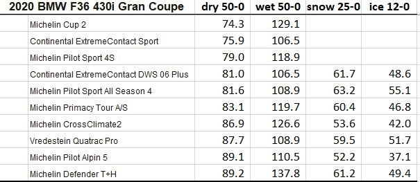

DWS 06 Plus is UHP A/S tire comparable to Michelin PS4 A/S equivalent. Both tires will be great for S California. They are harder tires similar to summer tires, but they are still good for snow. Crossclimate 2 will be better in snow and it is a softer tire comparable Michelin Alpin 5 winter tires. Crossclimate2 is a three peak mountain snowflake tire, but still you can drive them during summer in comparison to winter tires.
Important aspect of all tires for me is the stopping distance. Summary of stopping distances from tirerack tests using the same car:
