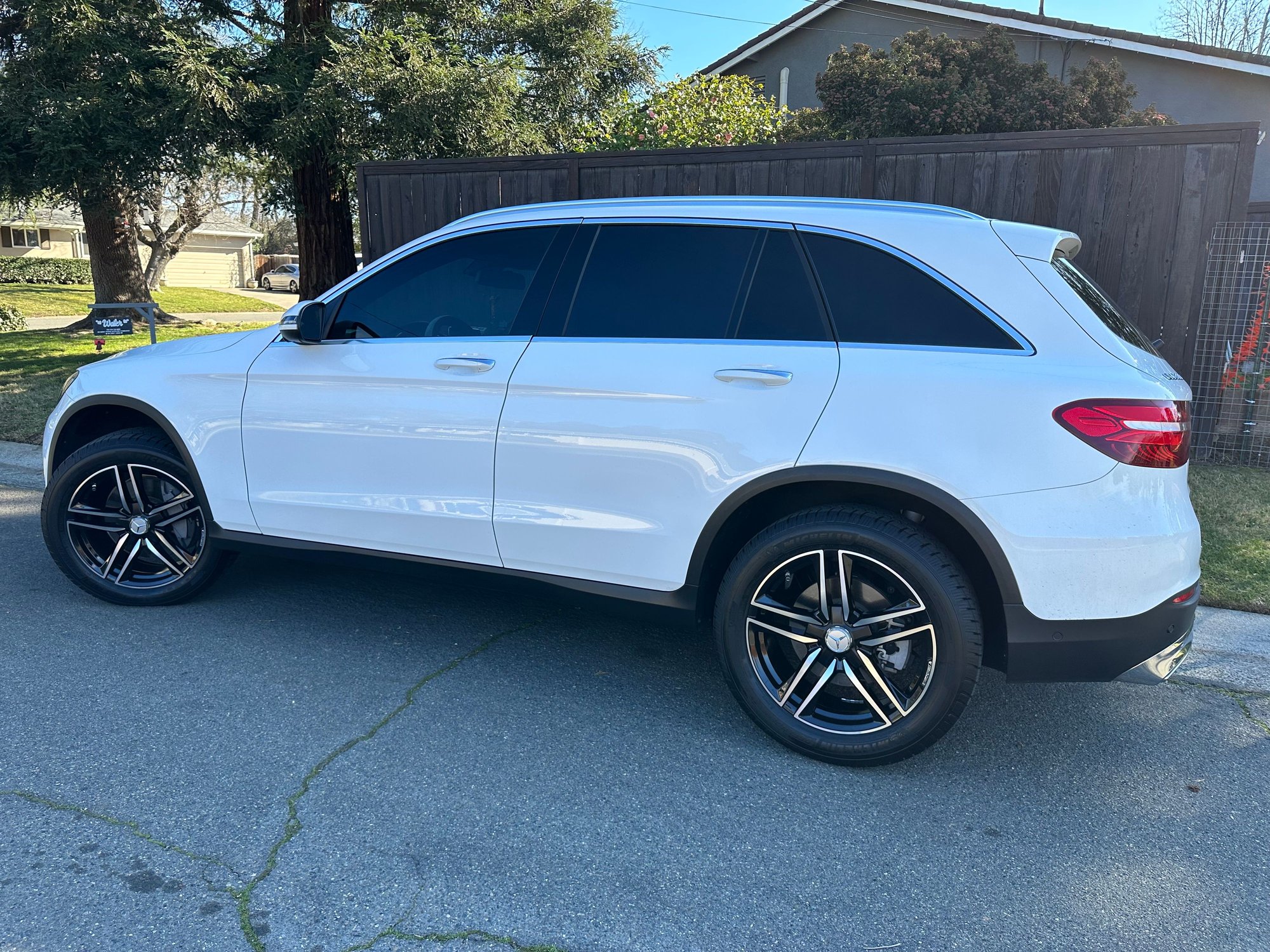

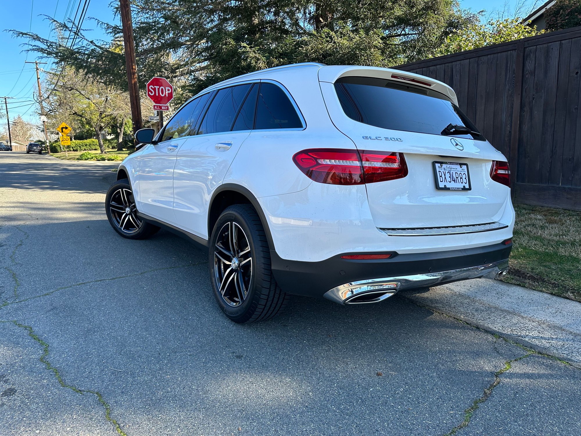

I had the same size tire as you and I went with wider wheels (with different offset) and tires, no issues at all, no rubbing, nothing! Looks much nicer as well and gives the vehicle a nicer, more aggressive stance (IMO)
2018 GLC300 4Matic:
- 8.5x19 with offset 32
- 255/50 R19 Michelin Defender LTX M+S all around.

how do the wheels fit? Are they flush or is there still room for spacers? Thank you
Old Aug 14, 2024 | 03:18 PM
S70Houston's Avatar
Joined: Mar 2015
Posts: 1,975
Likes: 265
From: Sacramento, CA
2018 GLC300 4Matic; 2008 ML550 4Matic; 2004 C320
Wheels are pretty flush and I personally would not fit spacers, but too each their own.
