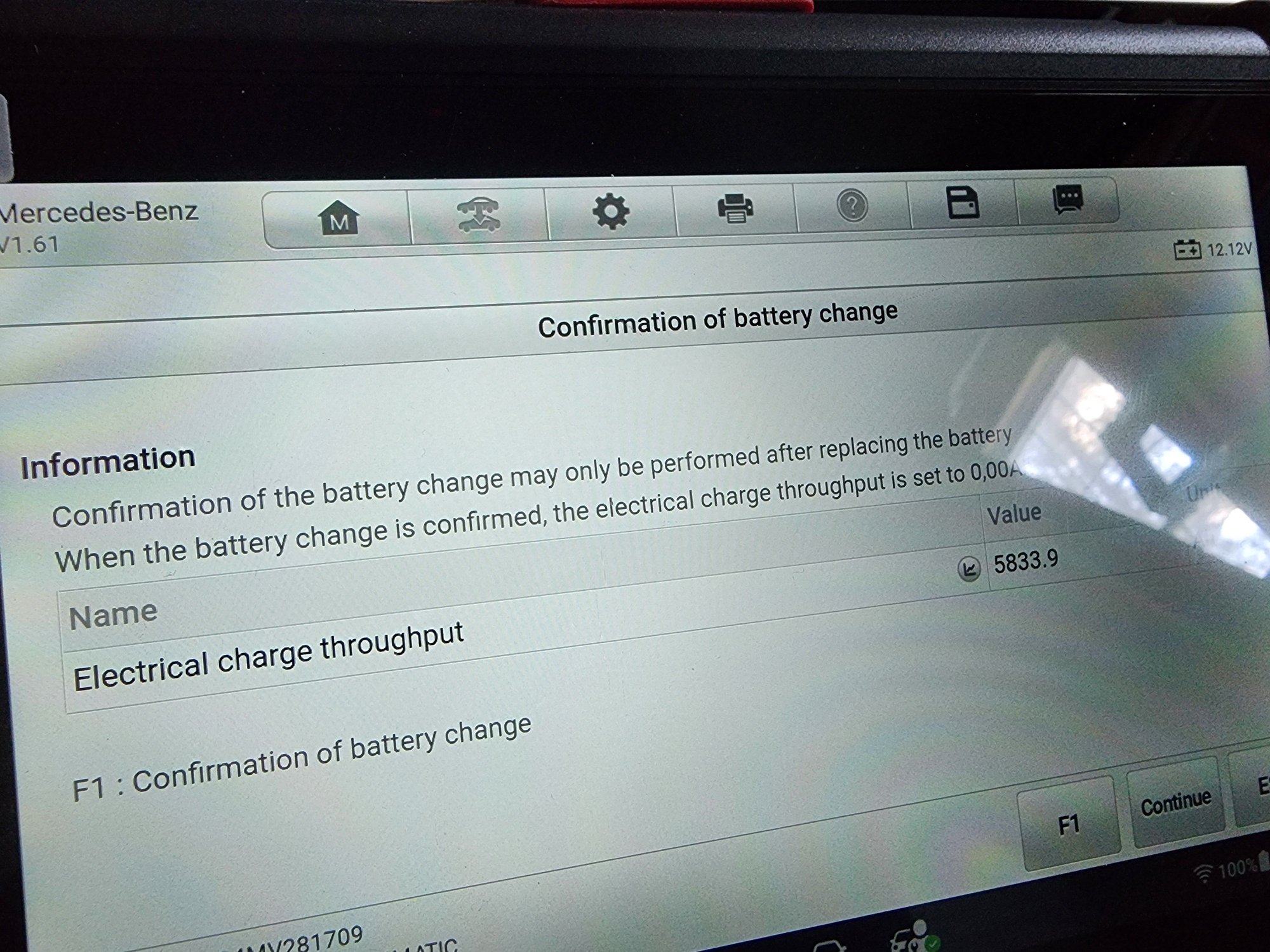

I have an Autel MX900. Go to Service>BMS>Hot Function.
Confirmation of Battery Change.
A lot of Autel models can do this. Mostly looking $400+
Some are discouraged on spending on thus level of scanner by saying it's not worth it. Maybe it isn't for them.
