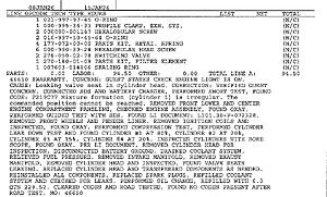

Yesterday we dropped my wife's '21 GLC 300 off at the dealer for obvious misfiring, yet no CEL. It was gradual, i.e. my wife might notice it when parking (which I learned later), but would not happen again for days. Two days ago I felt it for myself when pulling into garage. Next morning I pulled out the Autel (MX900) and started the car. There were 2 stored P030385 codes (see photo, sorry for sideways). Live data showed cyl 3 misfires as I revved the engine. Turned it off, did a little digging, found multiple differently dated versions of this Xentry document (attached), called dealer, and said we were bringing it in. I showed the doc, talked to the SA, and hoped it would be something simple--perhaps a bad coil despite no P0303 (which one would expect for a bad cyl 3 coil). Car still under warranty at 42K w/prepaid maintenance and typical driving habits. Only 93 octane gas.
Sure enough, it failed the leakdown test, and is getting a new cylinder head next week. I need to do some research to see if anyone has published, much less identified what the root cause is, b/c Mercedes knows there's an issue if there are multiple Xentry bulletins. My wife loves the car, and I like it too. This is the first car she's ever had where she wants to drive the wheels off. But it raises the question of keep or sell. Will the next cylinder head will do this again down the road? Bad design inherited from the M274 or new? Overheating exhaust valves/seats b/c of carbon? Hopefully I find out and can make an informed decision. I have a decent relationship with the dealer, who is the better of the two in Nashville.
Either way folks, if your M264 starts intermittently missing, especially at low speed, don't dismiss it as a bad tank of gas or wait for the CEL. If it starts to increase, get it scanned and look for this code. I thank God to have discovered it this way versus my wife having a major breakdown on the side of the interstate at night.

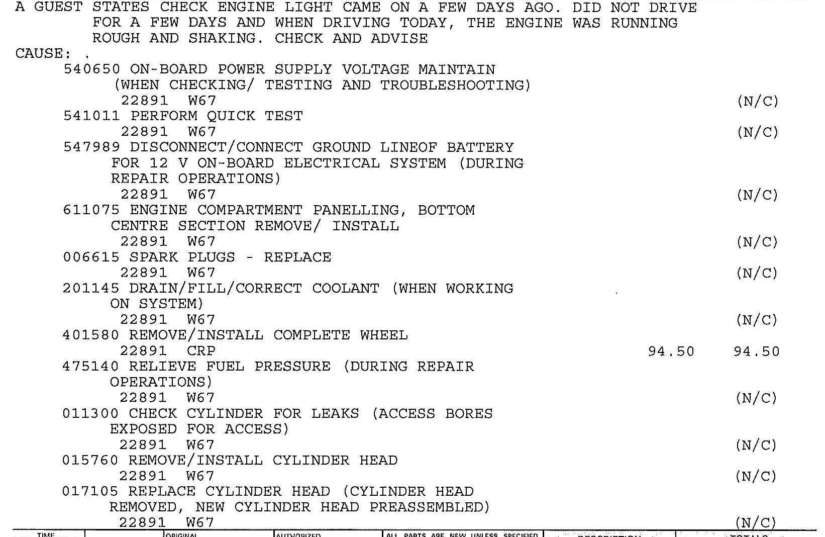

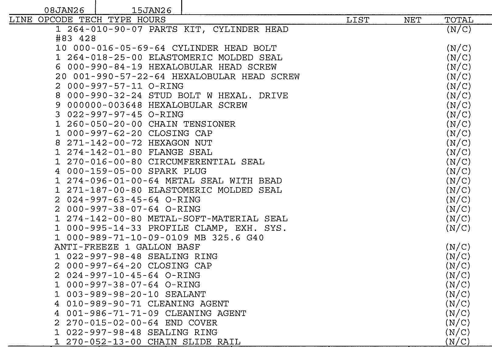

They are very much aware of it, our '21 GLC300 with 46,000 miles and 6 months out of warranty threw the CEL with all the right codes about 2 weeks ago. Took it to the dealer and started the negotiation for a goodwill warranty repair, and W140king's posting of the above letter was all I needed to get the repair covered under warranty. Picked up the car on Friday, all good (for now). Here are three pages of the invoice to show their workup (80% leakdown (!) on the bad cylinder #1) and all the parts replaced. Perfectly timed failure.
