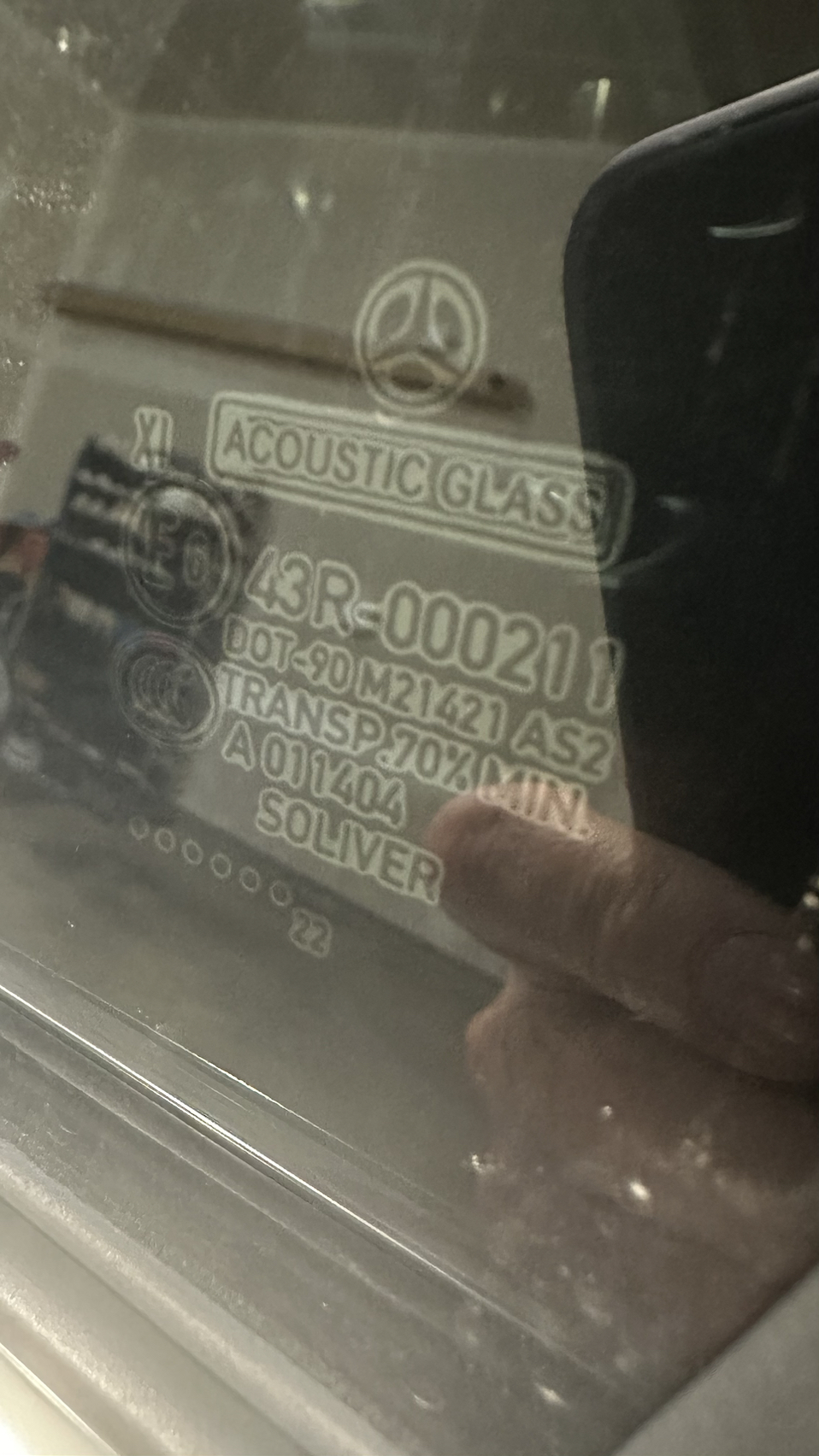

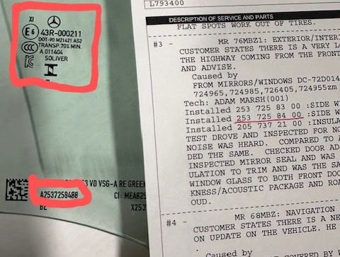

Looking for some advice. My front side glass was replaced several years ago at the dealership with acoustic glass due to wind noise, and the glass has the word "ACOUSTIC" etched into the glass along with all the other information. Someone cracked my front passenger side glass , and it now needs to be replaced. However the replacement from the dealership seems to no longer contain the "ACOUSTIC" label on it. The part number seems to be correct though. Could someone confirm that MB is no longer supplying the acoustic glass with that etching? I want to make sure it's the same glass I currently have. I'm a bit OCD when it comes to my car, so I know I'll notice it's missing every time I open that door. I've attached a pic of the current etching on my GLC, and of a pic they sent to me of my original invoice when it was initially replaced (highlighting the part #), next to the glass they received (that doesn't have the "ACOUSTIC" label), but all the other part information. Do the current acoustic windows no longer contain that label? If so, what would be the likelihood they could find one somewhere that does have it? Thanks in advance.

Acoustic is not always spelled out. Your new glass is acoustic. Indicated by the letter A to the left of the number above SOLIVER.
How to tell if you have an acoustic windshield?
A way to know if you have an acoustic windshield is by checking the bottom of the driver’s side windshield. It should state clearly “acoustic” or “A” or a symbol of an ear with a curved arrow if it is indeed an acoustic windshield. For some vehicle models such as Ford, they would have a sticker that states “Soundscreen”. Aside from the windshield, car windows may have engraved serial numbers as well.

Thanks for your response. The first picture I uploaded is from my vehicle. It did have the acoustic glass installed at the dealer several years ago after noting wind noise, so I know it fits. The part numbers you mention are the ones that were installed. Honestly, I think they did make a noticeable difference in sound deadening. The question I have is now that one of them has cracked and needs replacement, that the label "ACOUSTIC" is not etched on the glass they want to replace it with. Even though it's the same part number, is this the way the acoustic glass is being delivered now? .
Interesting, thanks for this information! So the A confirms it is indeed the acoustic glass. Do you know if this is the way all new GLC acoustic glass is being manufactured by Soliver or are they being manufactured both ways - with and without ACOUSTIC being spelled out?
No, I don't know. Acoustic used to be a novelty a few years ago and now it's fairly common. Soliver probably just simplified the etching. As said in the update to my post, there are three common ways to mark acoustic glass. The word acoustic, the letter A or an ear with a curved arrow below it.
