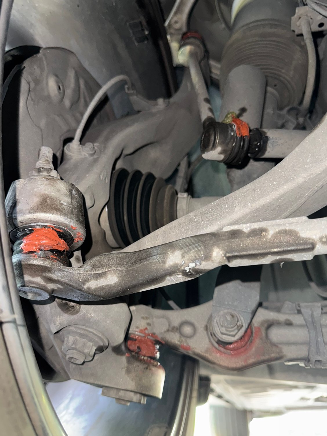

I saved a lower control arm ball joint, which was squeaking, now good working.
I injected all ball joints of Glc.
A narrow needle, like 1mm, is a little better to cover the injection hole with my polyurethane caulking.
Upper
Upper
Sway bar link
Sway bar link
Lowers, tierod
Lowers, tierod

Originally Posted by sn202020
This is true.
https://cimg8.ibsrv.net/gimg/www.mbw...3dbde69788.jpg
Upper
https://cimg1.ibsrv.net/gimg/www.mbw...8b2e217d09.jpg
Sway bar link
https://cimg4.ibsrv.net/gimg/www.mbw...aba32b37aa.jpg
Lowers, tierod
https://cimg7.ibsrv.net/gimg/www.mbw...cde631e857.jpg
https://cimg0.ibsrv.net/gimg/www.mbw...f8c1c592d8.jpg
Very nice, good job! Thanks for sharing.
