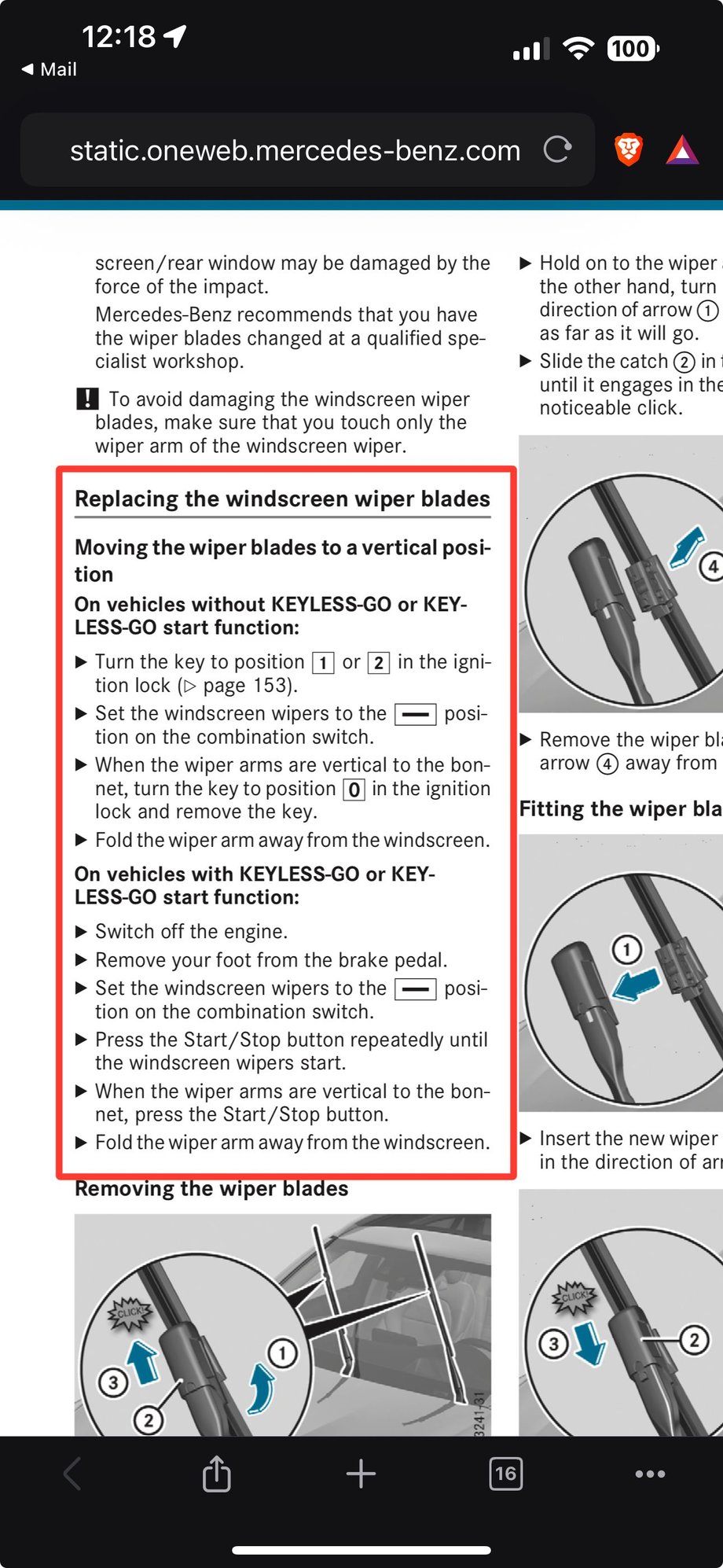

thanks to your link, I clicked on the manual again for my production year (2017 X253 coupe), looked at the manual and it seems I don’t have an automatic wiper service position?
Instead, I have to manually turn off ignition to stop operation of the wipers when they are at the top. Weird, I could have sworn I did the 3 seconds press to go to wiper service position previously when I changed my wipers. I must be delusional.
Attached screenshot of the manual.

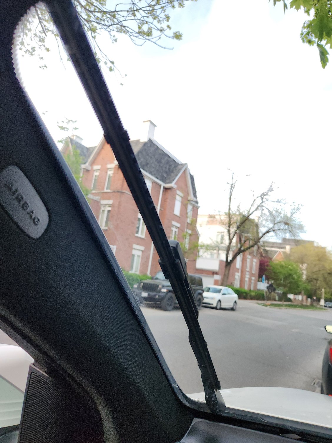

My 2022 GLC works for the vertical position by pressing the washer button.
2022 hood cover blocks the wiper, so I can not remove it at horizontal position without the vertical position.
But my 2017 has no problem to replace the wiper at the horizontal position.
Key on. -- key off -- push washer button.
2022 GLC.

Yup, i looked at the 2018 manual and it doesnt have this feature as well.
This feature only appeared on the x253 from the April 2019 manual onwards based on the online manual link that you provided.
2022 GLC.
Seems the feature only got implemented from 2019 onwards.
For my 2017, my wipers do not clear the edge of my bonnet if i want to lift them up. Is yours a coupe as well?
PS: Not sure if there is any relation, but mine is a RHD
Oh I see, I thought it was an option or part of a package, didn't know only model year 2019 vehicles and beyond have this feature.
Wait so LHD and RHD might be the reason?
