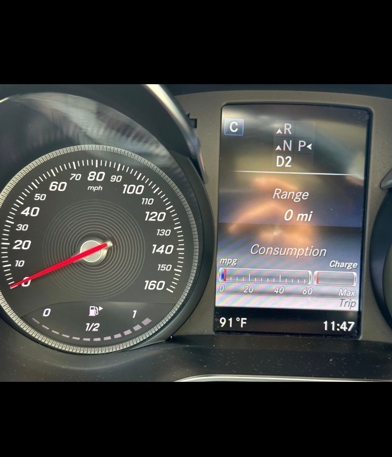

Hey am new here really need your help on this after so many attempts my 2017 GlC 300 Mercedes car has a full tank of gas but fuel gauge and range is empty. Theres no check engine light . The fuel does light up when I start the vehicle but went back to off Any help would be appreciated! I think someone had this issue before but I cannot find back the post on how to solve it I drink no issue but I have being using mental fuel gauge as I really don’t know what’s the issue

It happen on a rainy day when I was driving home looking at the gas tank to determine the amount of gas was in the tank I stop the car turn it off and turn it on back the lights come on, on the fuel gauge then went back off and from ever since I have that issue when I start it the car gauge light come on and then when to show the amount in the tank it goes off with no light even when I put full tank with the tank running over

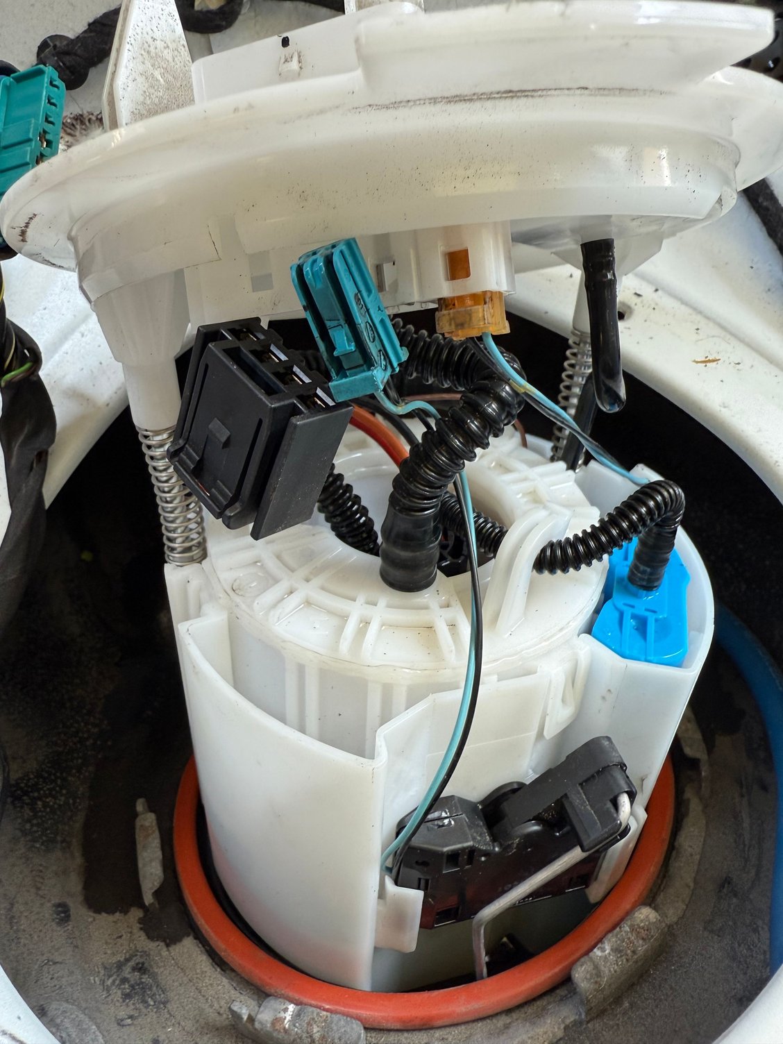

oooh so basically it’s the pump because I went to a mechanic yesterday to do a diagnostic he told me there’s no readings from both the sensor so he is saying basically seams it’s the pump or the pump cover needs to change so I guess am going to have to get a new pump

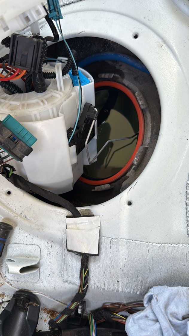

I pull the tank myself to inspect the pump it’s showing a bit of corrosion so am going to get a new one and install it thanks

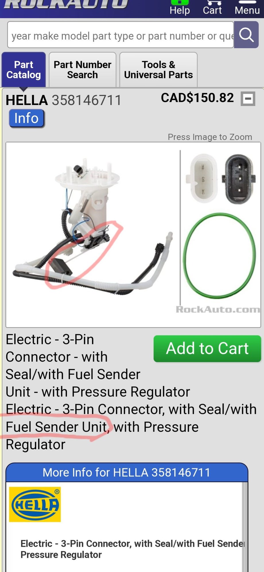

If you can start the engine, your fuel pump is working fine. If you're fuel gauge looks bad, then fuel sender issue.
Fuel sender is like a toilet float and sends the different resistance to ECU by the float angle. The plate resisters or the copper contacts worn out then wrong resistance to the ECU, and wrong fuel display happens.
If you can buy only the fuel sender, it's cheaper.
Don't just buy only the small pump itself without the housing which doesn't include new sender.
ooh ok I see
I pull it myself took out the pump which I tested it not sure if am doing the right testing way so I bring it to the mechanic he put a scanner on the car he saying there’s no readings coming from both sending unit which he may be thinking it could possibly be the pump cap that the fuel the both fuel sending unit plug into I don’t know
