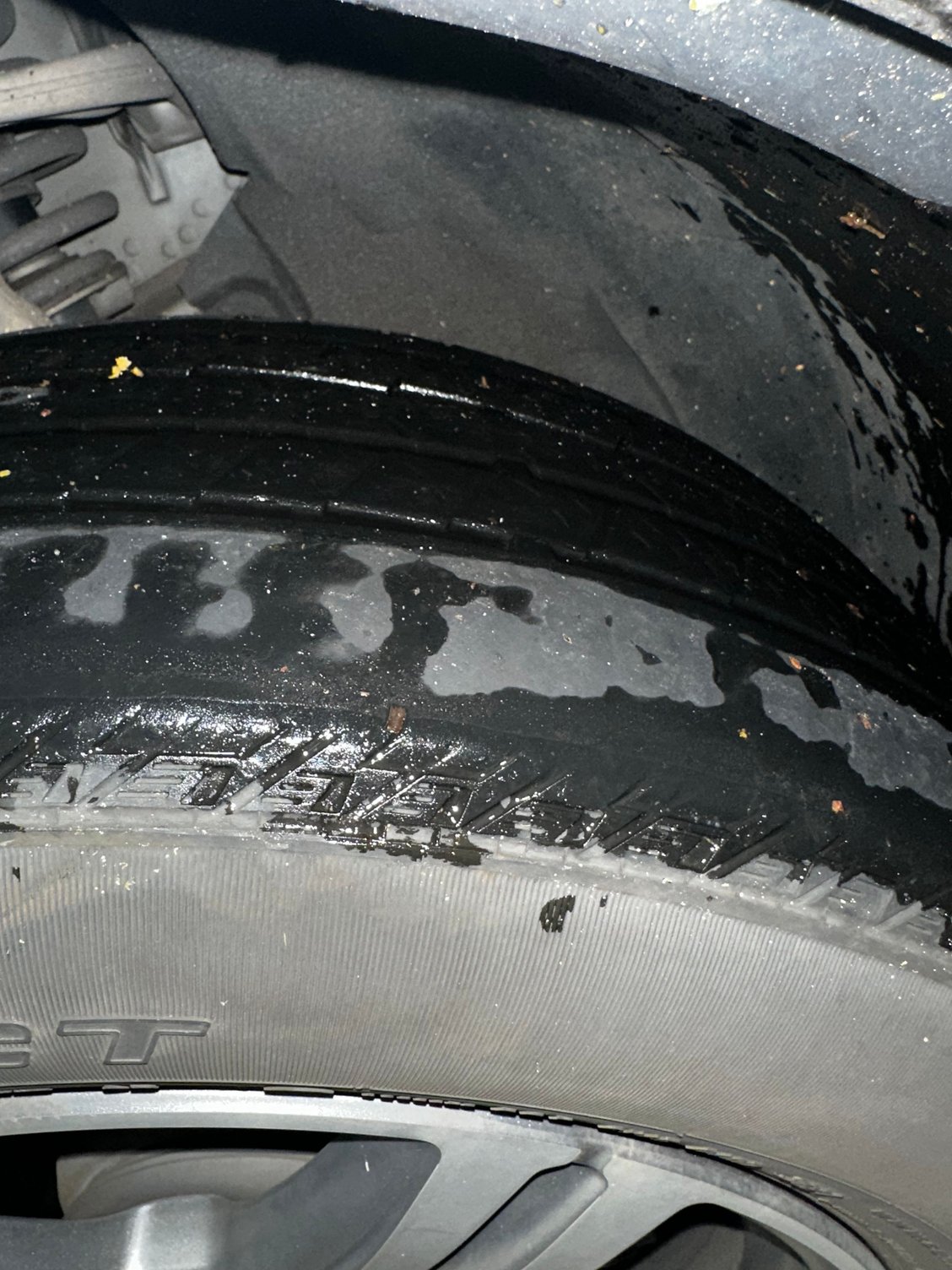

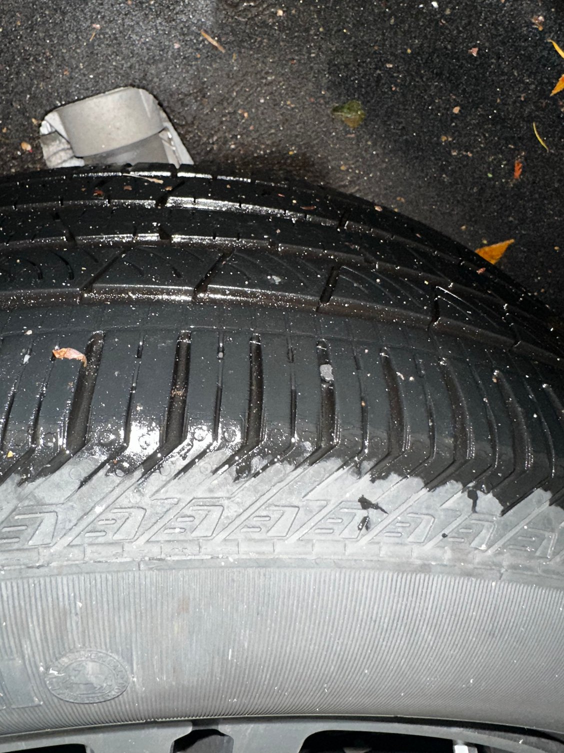

Hi all,
Noticed the front tyres on my Mercedes (GLC 4MATIC 2020) are flattening while the rear ones look fine. Is this normal, or should I get alignment/rotation done? Replace now or wait?
Miles: 51,863. Did a long West Coast road trip(OR to CA to Texas to OR) in 2024, so I assumed wear would be even.
Technician mentioned okay for now about the flattening stuff in last service, but I wanted to check with the forum.
Front one,
Rear one,
Appreciate any advice!

The fronts are rooted , I’d replace them and get a 4 wheel alignment done immediately. How many miles on those tyres. Are they a staggered fitment.

With my 4 matic, i always realize those rear tires wear faster than front.
Like, tire tread left:
80% at front vs. 60% at rear.
Front axle wheel alignment needed.

even MB 4 matic, still the rear wheels are the main driving power, so the wear at rear tire must be quicker, and it is normal.
However because your front tire worn faster, your front wheel alignment need to be checked if toe is bad or not.
if your outer tire worn than the inner side, then bad camber.
check all 4 wheels alignment, than just front wheels.
your front tires must be replaced. and rear tire can be used more.
And maybe put your rear tire to the front, and new tires to the rear, make sense.

The fronts look like they've been under inflated.
Check your tire pressure and inflate according to the gas flap (not the driver's door post).

Your tires aren't "flattening", they are wearing unevenly. Flat means loss of air pressure. Your tires are balding on the edge, wearing out the tread unevenly. Also, your different front to back wear patterns are due to both (a) bad or not maintained suspension alignment, and (b) failure to frequently enough rotate the tires to equalize wear.
