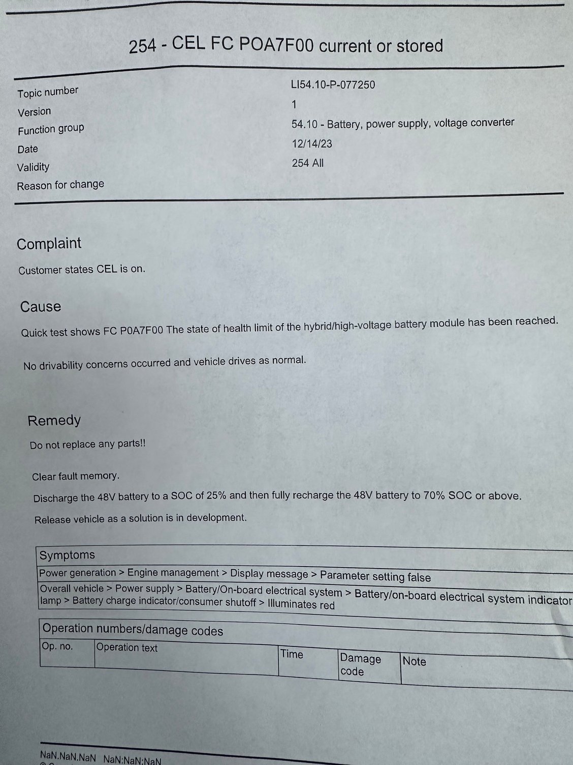

Also, it seems like MB had a service campaign bulletin https://www.startekinfo.com/service/...utside/227923/ available on this matter in June, 2023 itself. But why is everyone continuing to still see these issues? Does that mean the software update from the service bulletin does not help ?
Would really appreciate your thoughts, as I love the car with it's looks, drive and performance, but the issues and the experiences of the people on this thread are scary.

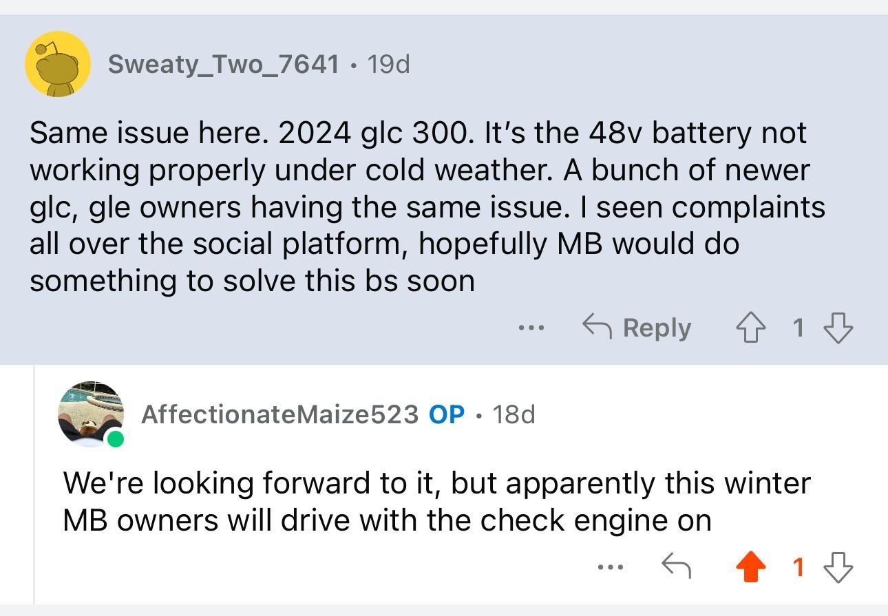

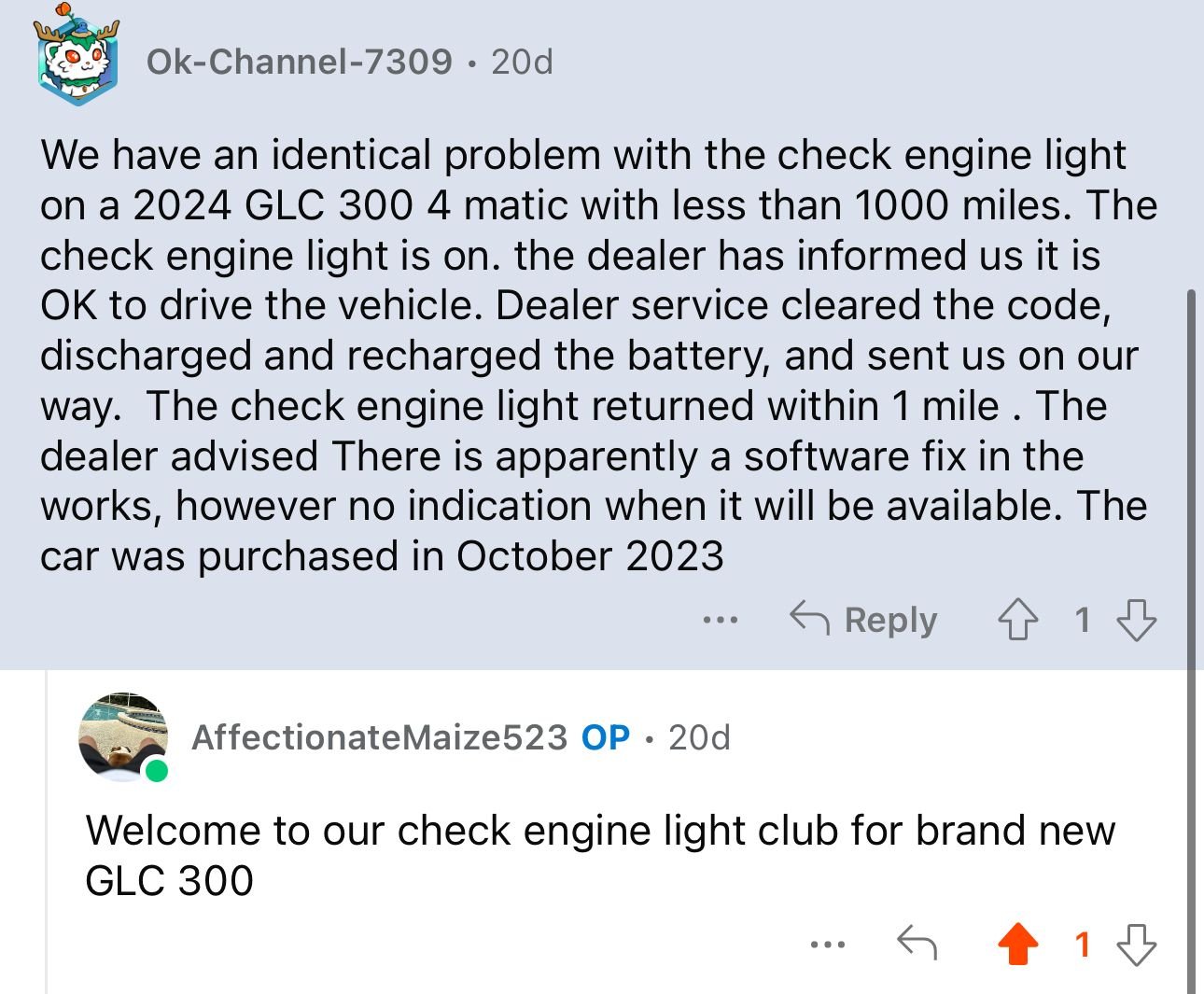

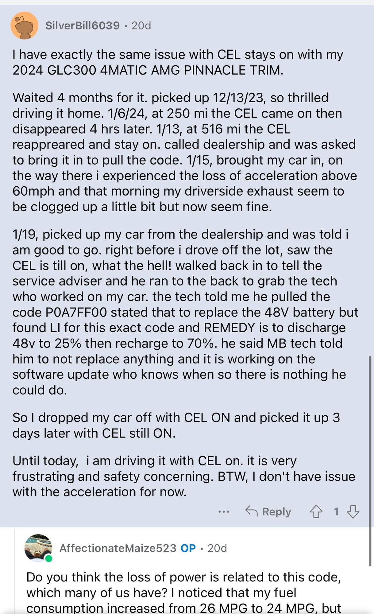

Hi,
https://www.reddit.com/r/mercedes_benz/s/yTWsW1aMJP
Here you can see the owners of the GLC 300 2024. The problems are still the same. The software is still under development. The car is very nice, it brings me pleasure, with the exception of errors that sometimes appear, but all the errors that appeared for me disappeared and did not affect the performance of the car in any way. So far it looks like a bug. The only thing is that CarPlay is terrible, and when you pass any places with radio stations, it starts to glitch. As for purchasing, buy at your own risk. You may come across a car with minimal problems, or you may come across a car that will take your time and nerves because you will have to use the lemon law. But the car is very comfortable, especially when fully equipped
GLC 300 4 matic 2023 15k+ miles

I created this topic on Reddit. And owners of GLC 300 - GLC AMG 2024 wrote to me with a similar problem. You can find them in the comments below the post via the link on Reddit
