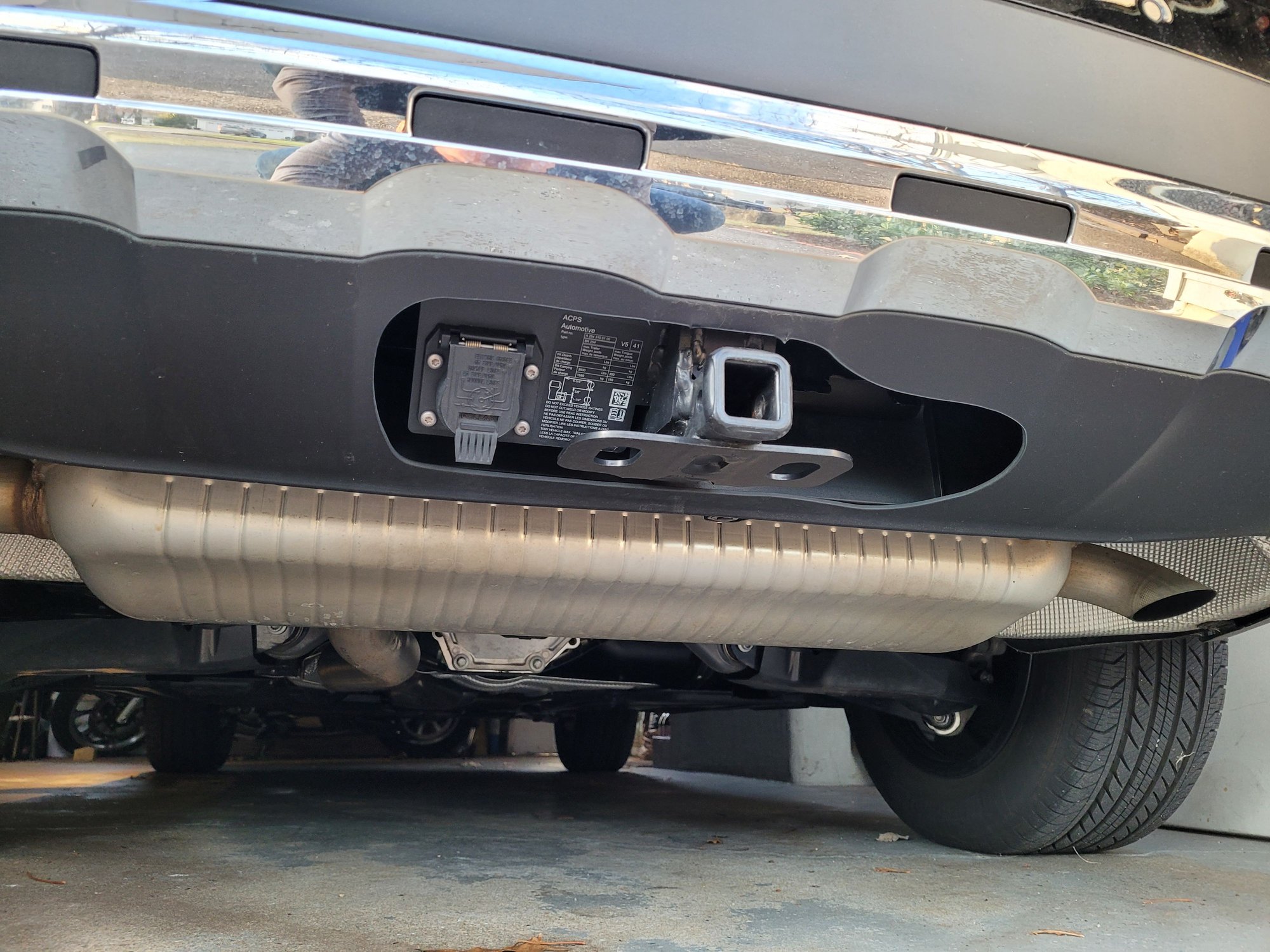

Happy New Year. I’m about to order a 2025 GLC 300 and I could use some help regarding bike racks (Please redirect me to another thread if this is old news.) i have a Kuat carrier that requires a 2” receiver.
1) What does the factory installed OEM hitch look like? Anyone have a picture of the installed hitch? (Yes, I would need to add a 2” adapter.)

Here are some photos of the factory installed hitch.

Very helpful. Thanks!
