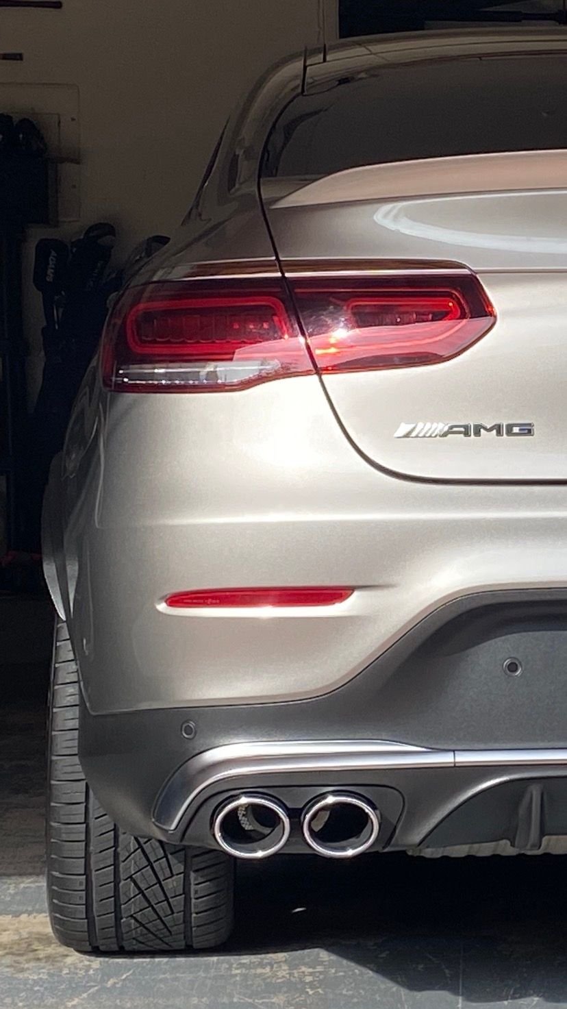

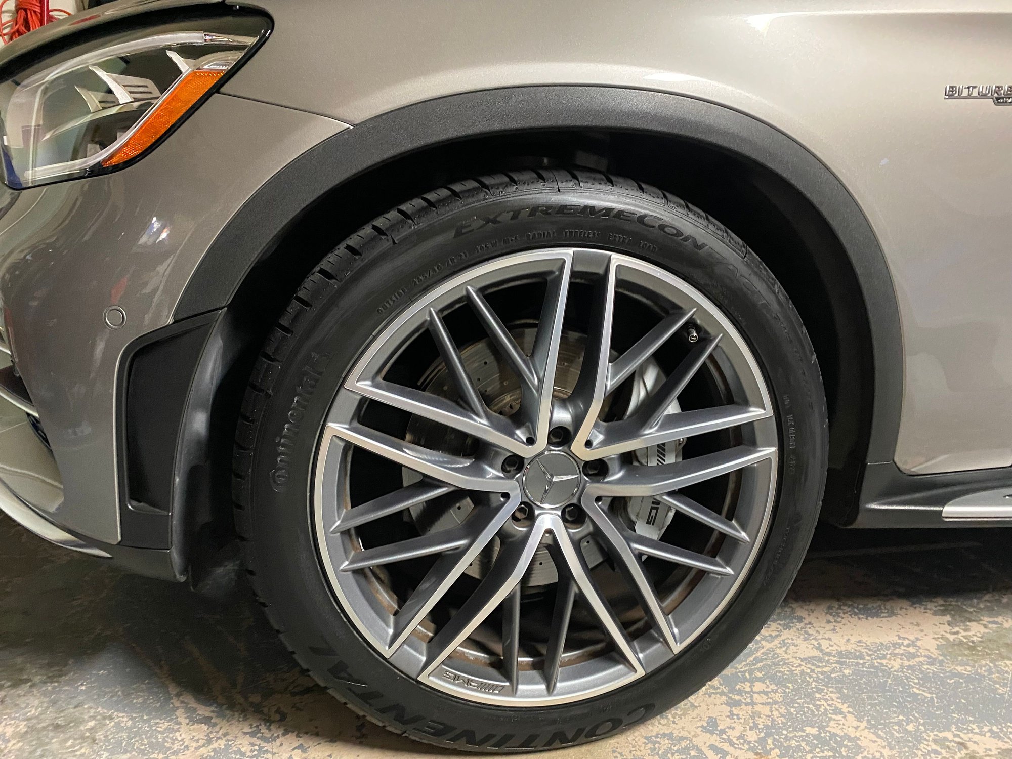

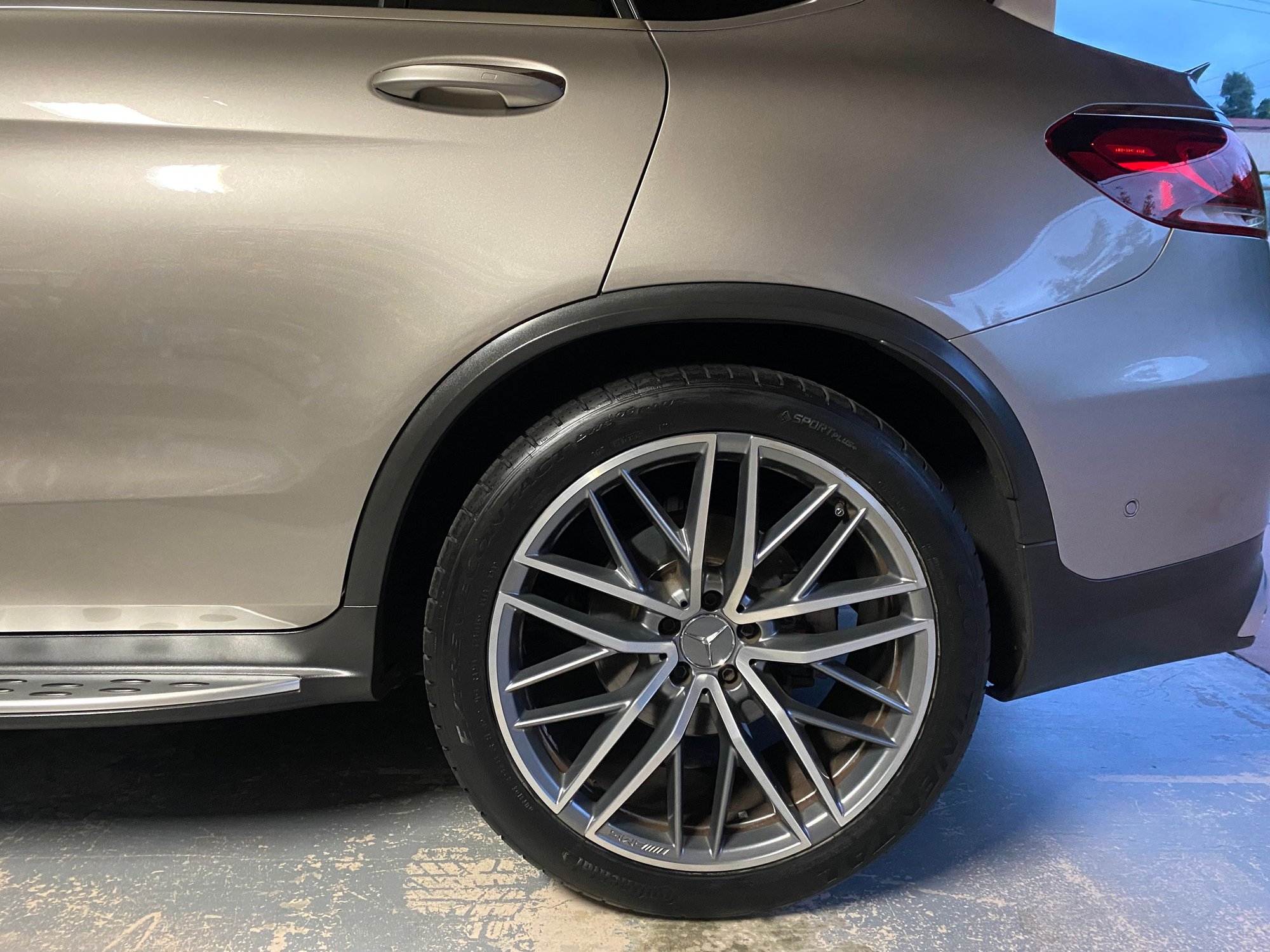

Old Nov 12, 2025 | 04:18 PM
AMG-GLC43Coupe9's Avatar
Joined: Jun 2023
Posts: 48
Likes: 8
From: Los Angeles
GLC 43 Coupe
Photos
Here are some photos.
Old Nov 12, 2025 | 07:05 PM
Winfab's Avatar
Posts: 7
2020 AMG GLC43
Looks great! Thanks for the pics!
