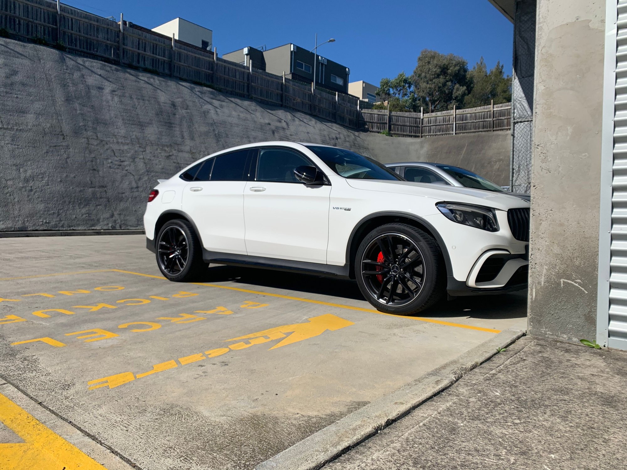

Just thought I’d ask here for more advises, I’ve owned a 2018 GLC63S Coupe for two months now, got it from a MB dealer as a 2000km Demo car. Previously had always owned Bimmers.
1. I found the interior of this Merc has so many rattles in different places at different time during the date (guess it has something to do with the temperature).
most of them sound like plastic rattles, never had these issues with my old bimmers, thought it might be because Merc has so many luxury designed components on interior, but it shouldn’t be that bad?
2. front wheels at full lock are jaddering/skipping very bad especially at low speed when it’s cold in the morning/wet on road. (“Ackermann”
is probably the only thing I can relate this problem to, but dealers seems to reason this out as a 4Matic+ characteristic). I know UK MB had already given out a solution back in 2015/2016. Just wanted to see if there are other GLC63S having the same problem?
3. In drive mode, when release the brake, a very light sound comes out if rear wheels and it sounds like when auto electronic Paking brake is scratching the braking pad when it separates from the braking pad. Not loud, but very noticeable.
Apologize if these have been brought up before, wanted to start up a discussion for any issues that we are having but unable to resolve thru dealer. :-)
