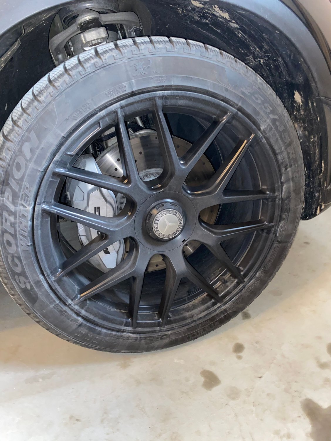

i just got new winters on my 2020 glc43
End Proctoring- End Proctoring-

Originally Posted by aviator787
I was told to get spacers for the rear so that wheels don't look too much inward.
Would you have experience with this?
I am going with 19 wheels and 255/50R
Well 20 look kind of small from the back but its winter i can manage i would say 21 would look nice. I think recommended is 19 for winter i could be wrong

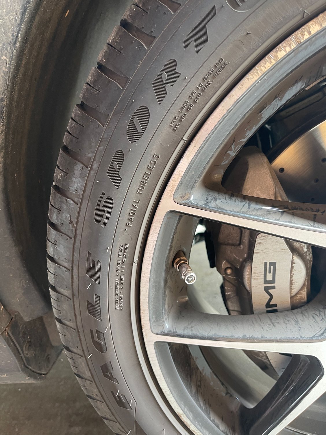

Originally Posted by 4ringsnbr
You don't have run flats-- they're not on the 2020 GLCs... My 2020 GLC 63 has Continential Sport Contact 6 tires 265/45R-20 in front and 295/40R-20 in rear. If you look on your tires, you will have an "MO" or "MO1" designator behind the size of the tire to indicate Mercedes OEM. "MOE" designator is for run flats, but as far as I know, they aren't offered as standard on GLCs in the U.S.
I hate to break it to you, but yes, I have Goodyear Eagle Sport run-flats that were delivered standard on my car, as do many, many other GLC 43 owners. Mine are 255/45R-20 in front and 285/40R-20 in back. Maybe I can fit the Contact 6 tires in the wider widths you were given on my rims, but I can't say for sure. At least that's something for me to go on. But please stop saying Mercedes didn't issue run-flats as standard, because they did (and perhaps still do). You're working on bad info I'm afraid.
EDIT: Adding a screenshot from my original build sheet, dated December 2019. I was not given any option other than run-flats - this was the only choice.
