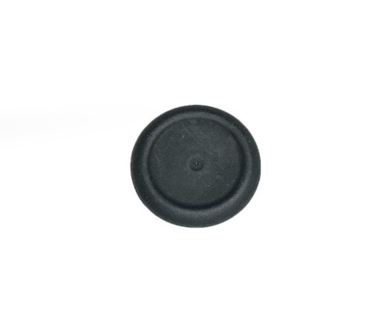

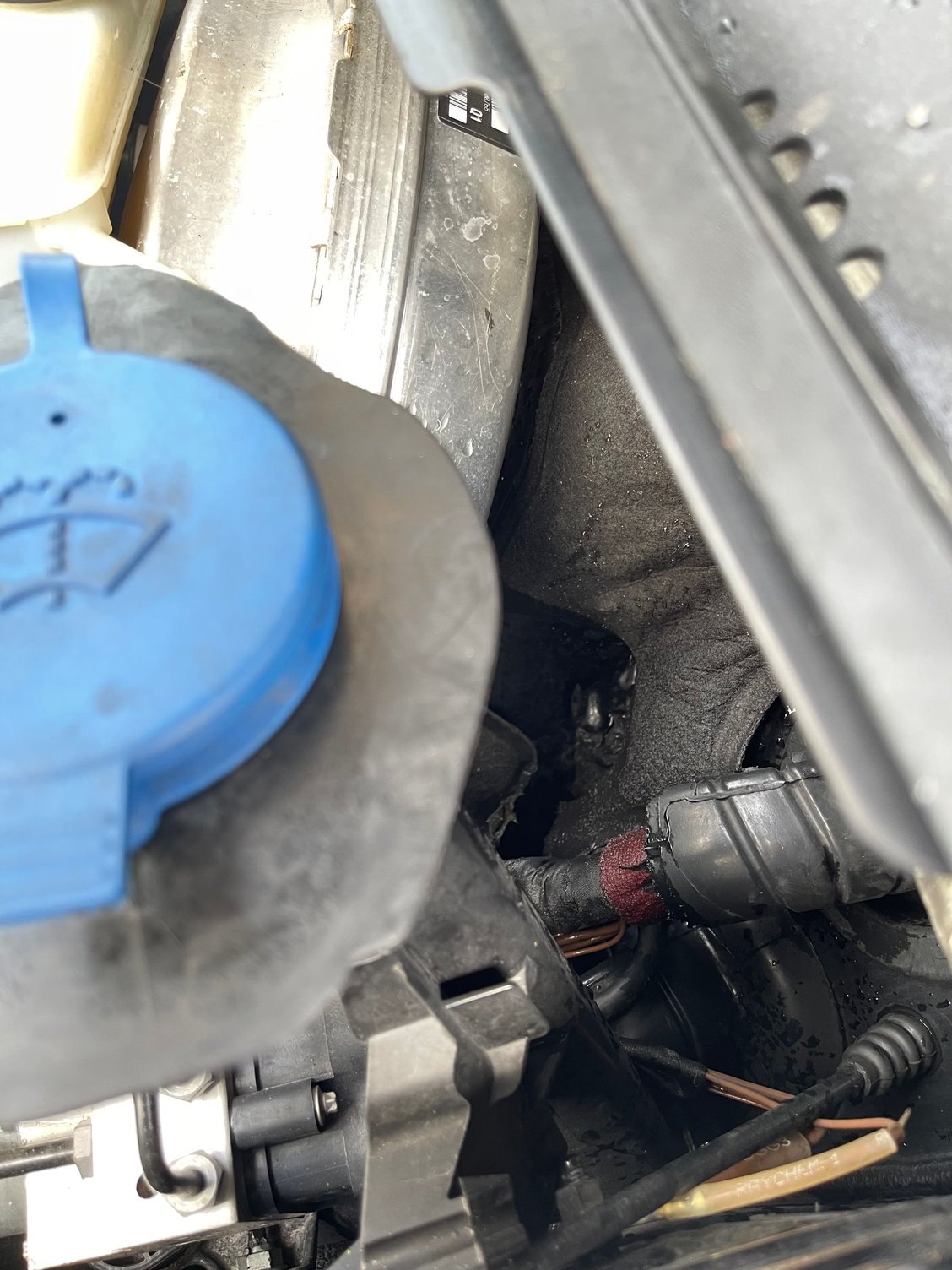

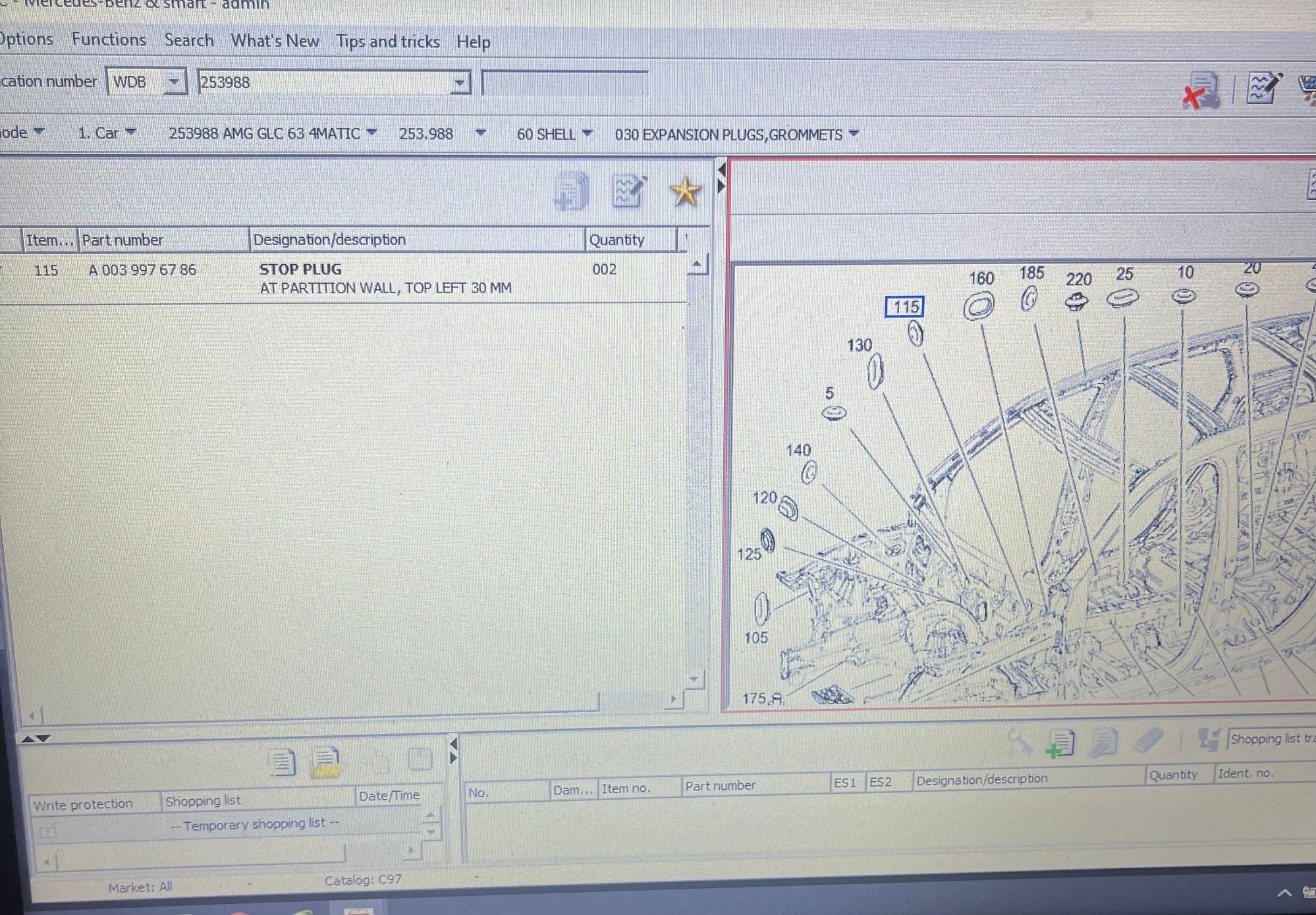

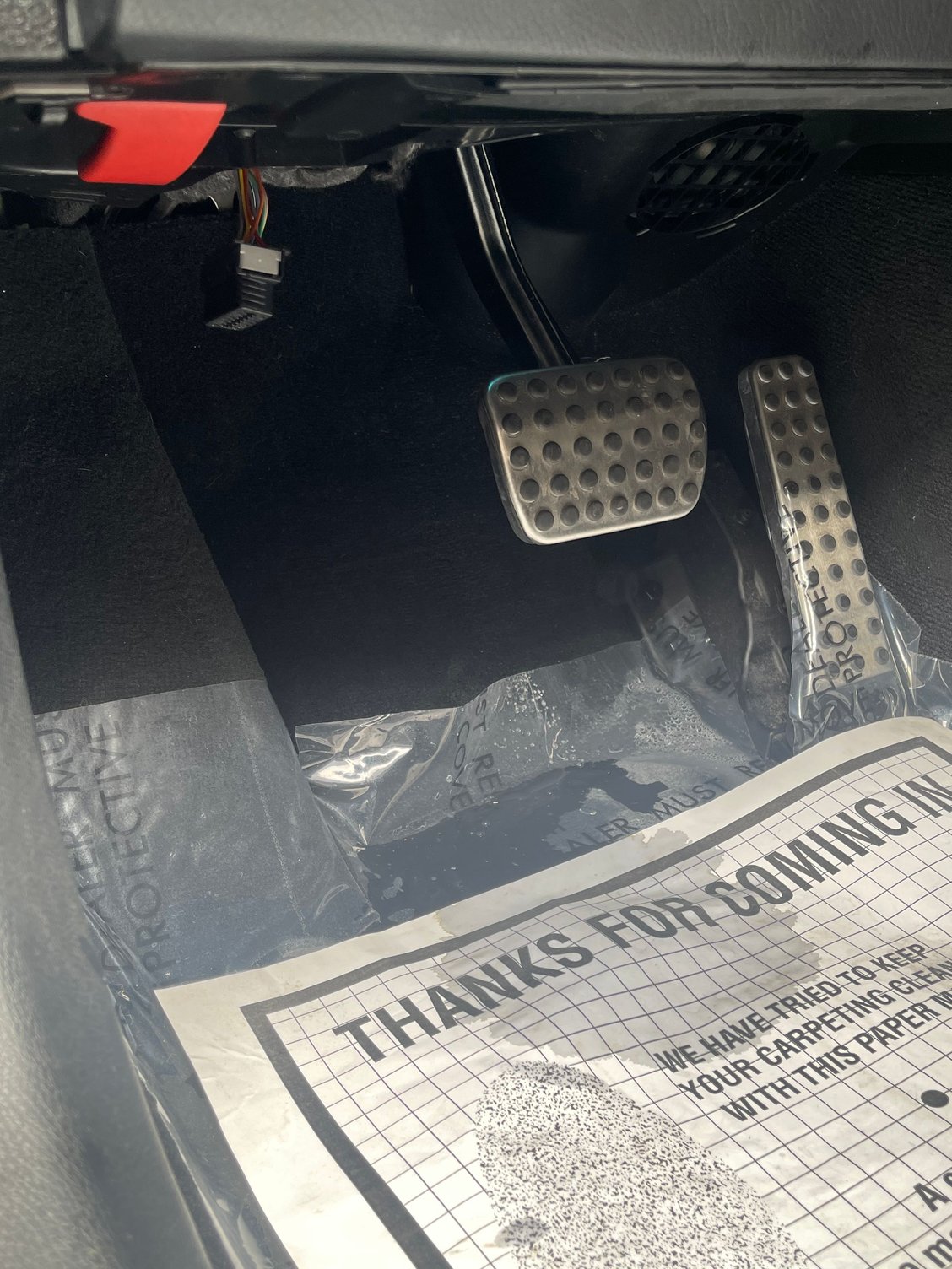

Good evening,
Attached is what I found with my particular water ingress.
Mine was on driver side only after heavy rain.
Leak on floor Leak on floor
Open hole from engine firewall to interior of vehicle.
Manual reference item 115 part# A0039976786
Image of stop plug
Image of stop plug
Old Sep 3, 2025 | 10:40 PM
W205C43PFL's Avatar
Posts: 32,375
Likes: 6,324
Originally Posted by hyde000
Good evening,
Image of stop plug
Image of stop plug
Thanks for the pictures and part number. Glad to hear no actual electrical damage.
