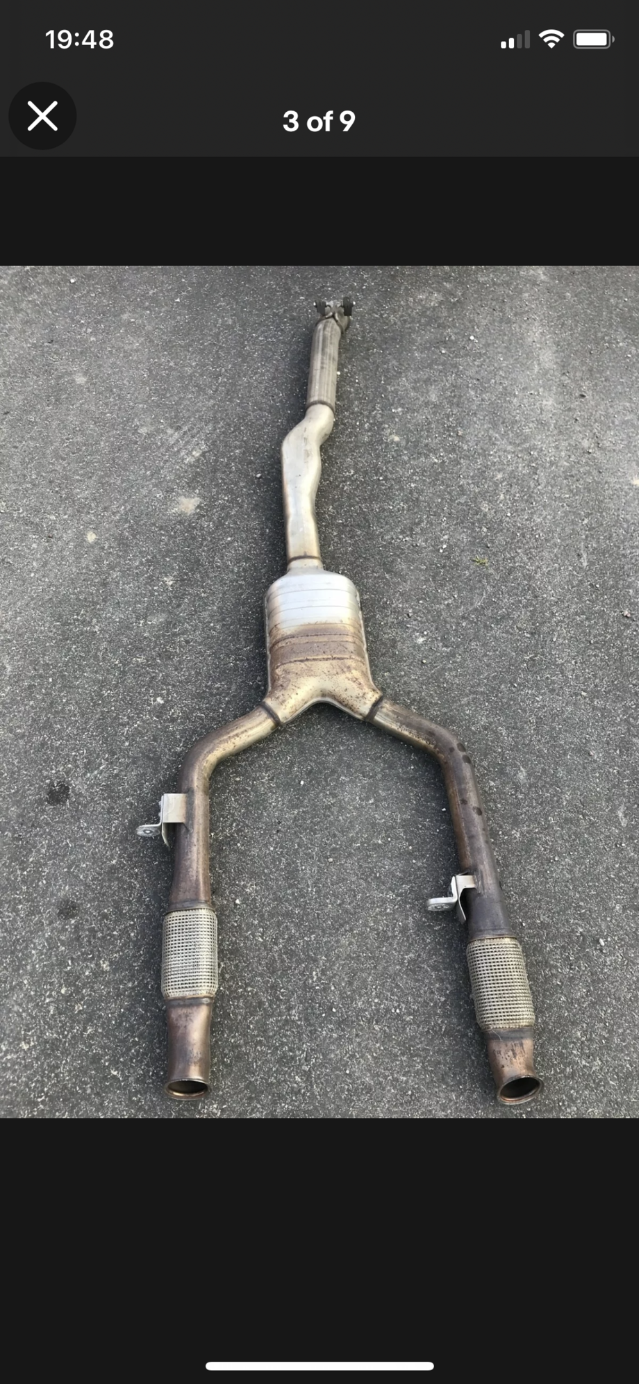

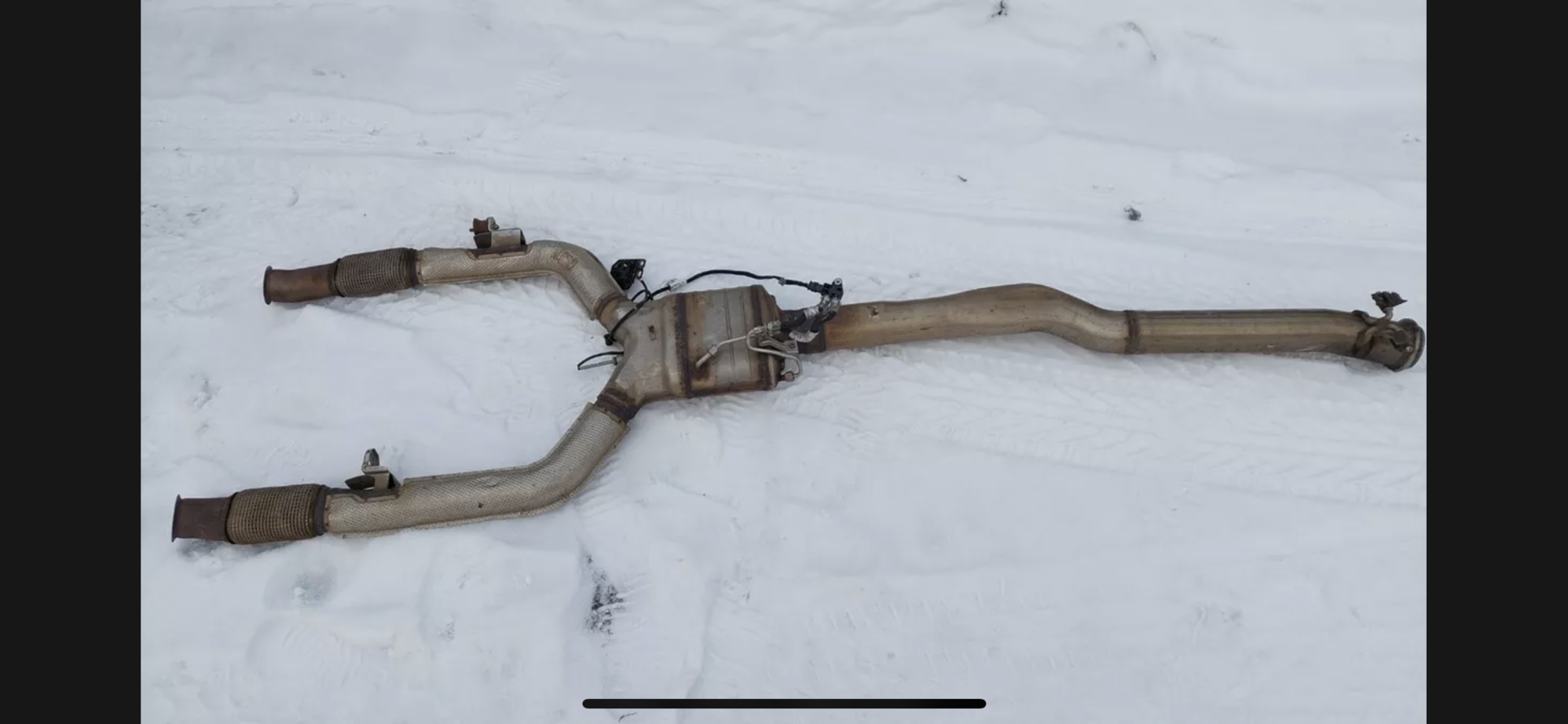

After a mistake on my part, my recent 2018 GLC43 purchase did not come with the performance exhaust. I’m feeling I am missing a big part of the AMG ownership with the lack of exhaust burble compared to other GLC 43’s. So I plan to do a resonator delete. But I do not want to butcher my std exhaust so plan to buy a used one off eBay and have the resonator removed.. then I can always go back. Problem is my std exhaust looks different to used GLC43 exhausts on eBay. It appears there are 2 types: picture 1 (mine). Picture 2 (eBay version).
My existing exhaust has loads of wires and looks totally different. The one on eBay looks like I could delete the resonator. Will it fit? What happens to my existing wires because there appears nowhere for them to go on the eBay version.

Thanks. That makes sense. I just can’t understand why my standard exhaust is different to the other std GLC43 exhausts. I’ve looked at several 43’s and my exhaust is different to all of them..
weird!

Both my pictures are std exhausts. It’s just the one on my car is totally different…
I want to buy the one on eBay and do a resonator delete but my existing std exhaust has a bunch of wires that the eBay standard exhaust doesn’t have. Very odd.

Mystery solved: the one with the wires and crap in it is a uk spec/ euro spec glc 43 exhaust with a OPF/GPF filter built into the section where the resonator would go. Those wires are attached to prongs/sensors that measure the efficacy of the opf filter.
The other one without the wires has an actual good old fashiod resonator in it.
It could be that mb had to change over to a opf exhaust mid-model run.
The same goes for the uk c43 PE. The rest of world has the resonator, the others like the UK has 2 opf filters in the place of the resonator.
Hope this helps.

thanks- that makes sense. I guess swapping the one for the other would not work as it will probably throw out codes given the opf wires..
