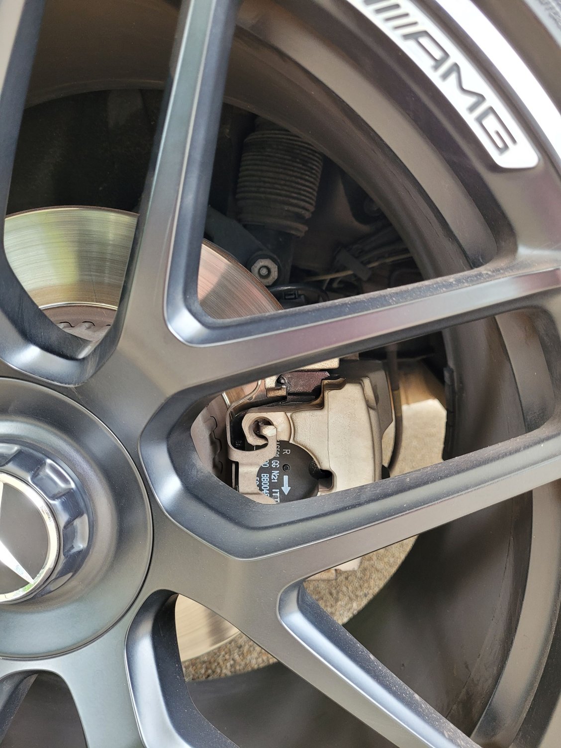

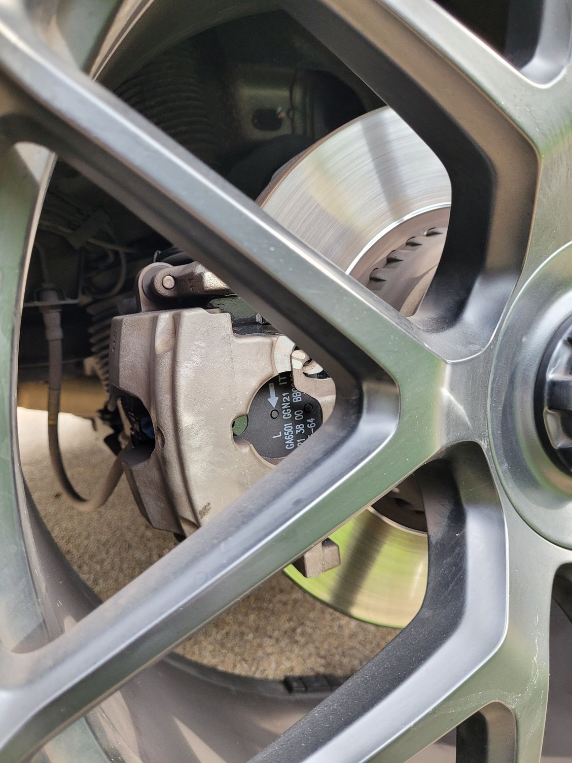

Quick question. I just had new pads all round on my glc43, but I noticed that the rear pads directional arrow indicator (Is that what the arrow is?) is opposite the rotation of the wheel (as per photos below). I understand from google that the arrow should point the travel of the wheel and the L or R indicator should be well, on the left and right of the car. Is that the case for an AMG, and if so should I go back to the dealer and 'discuss' with them? You can also see a fresh clean 'score' on the inner edge of the disc, which seems concerning, as if the pads are not aligned like the old ones.

They misinterpreted the L/R appropriate sides...
In automotive terms, the Left/Right are taken into account when you are inside the car facing the direction of travel,

Thanks. So dangerous and should take it back to the dealer? Seems like a mistake a Merc technician shouldn't be making.

You should go back to the dealer.
