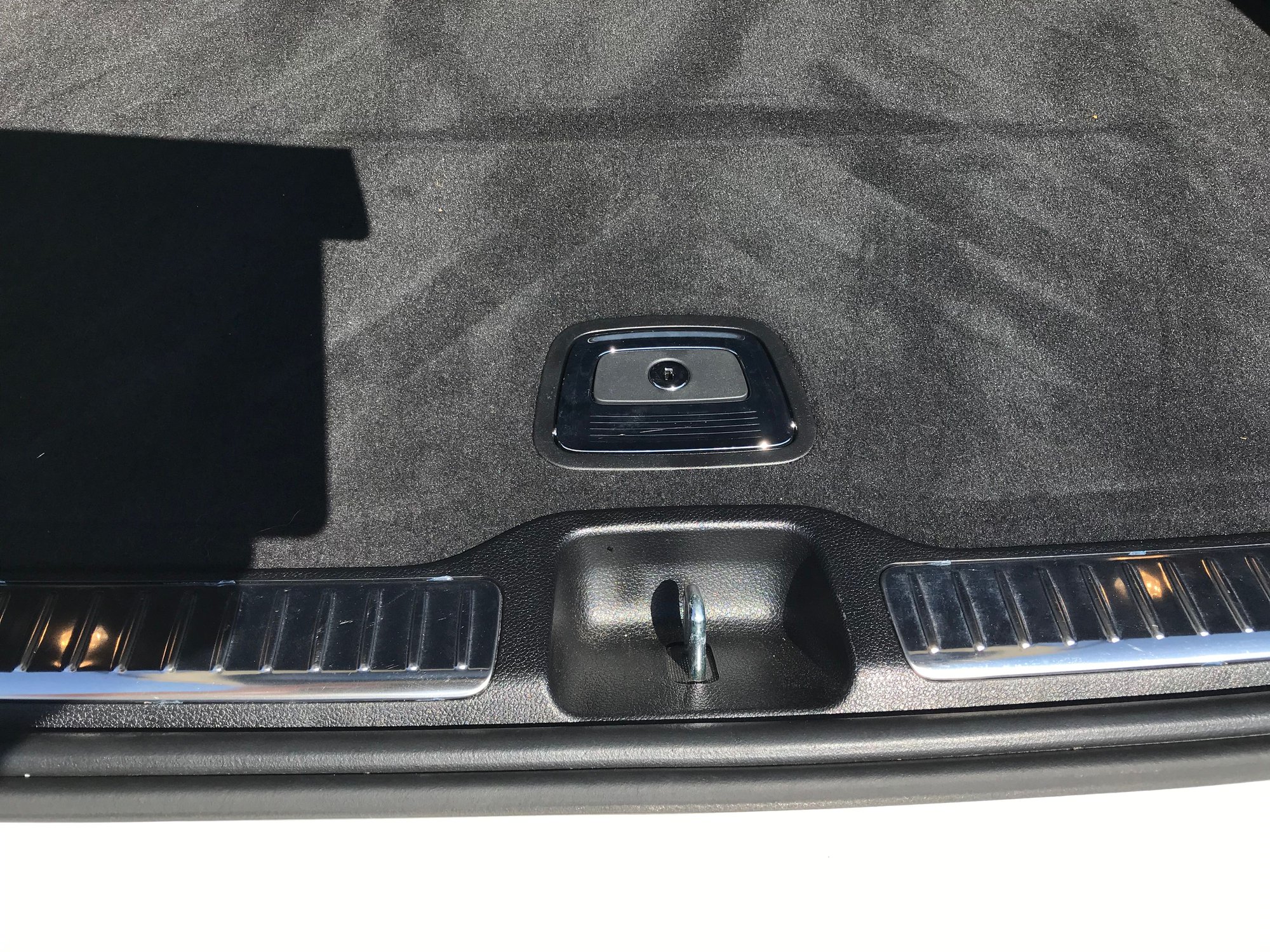

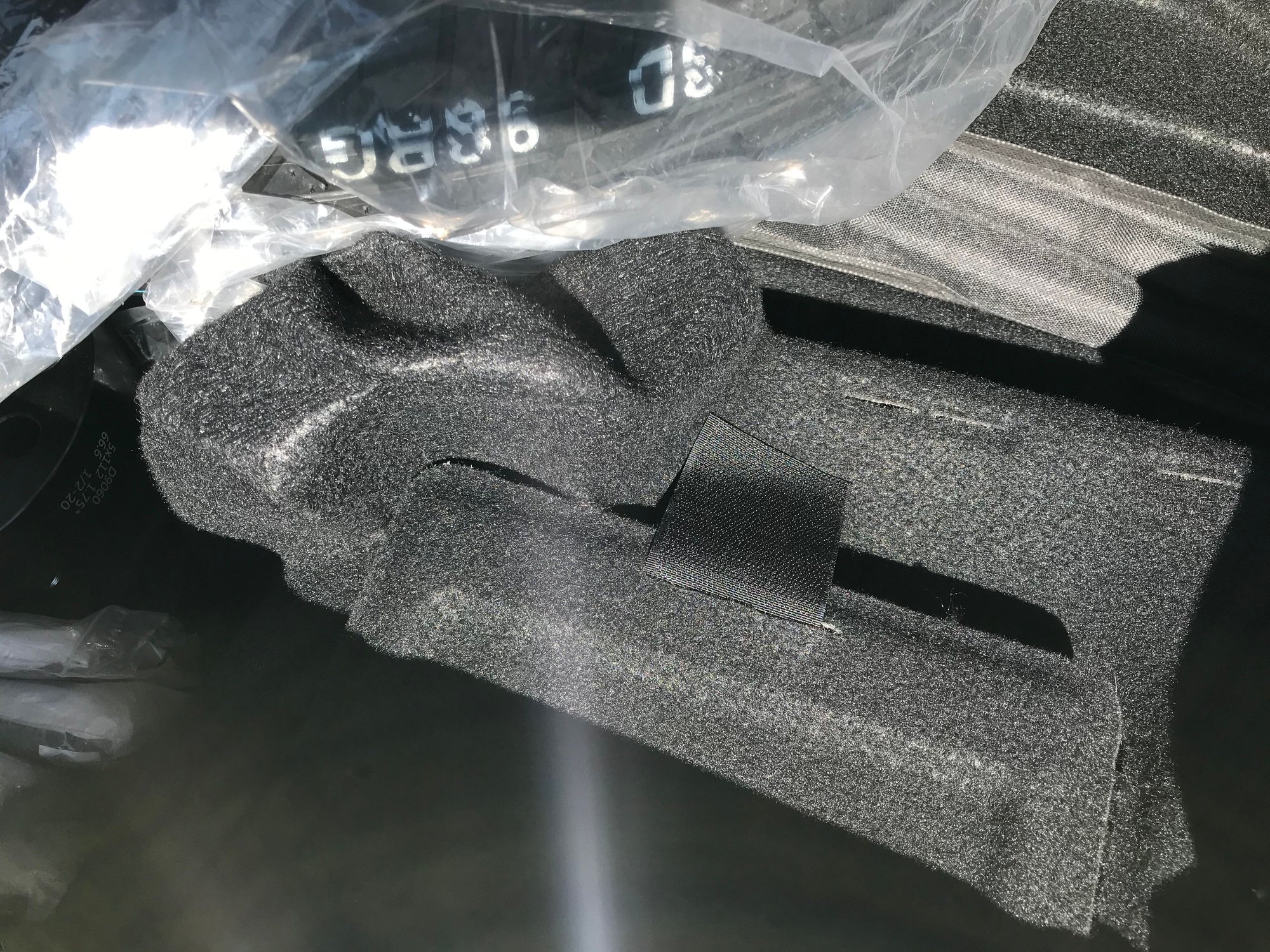

MADE IT WORK: Bought a kit from modernspare.com. Came with tire, jack, spacer, and carry bag. I failed finding a new cargo floor spare insert so I used some brute force and positioning the spare as far left as it would go and to the rear and it fits. I did have to crush part of the flooring by the fuse box but the fuse box is fine and not affected. Cargo cover closes flush.
Nice carry case that now I won’t use.
Spare and other kit parts I place as far left and back as it will go.
The housing near the fuse box is deformed from the tire but it holds it snug and I can run my fingers all around the fuse box with no part of the fuse box being affected.
Lid closes flush.
