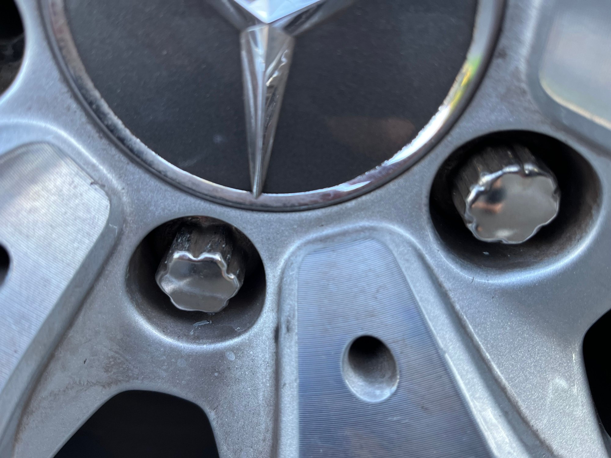

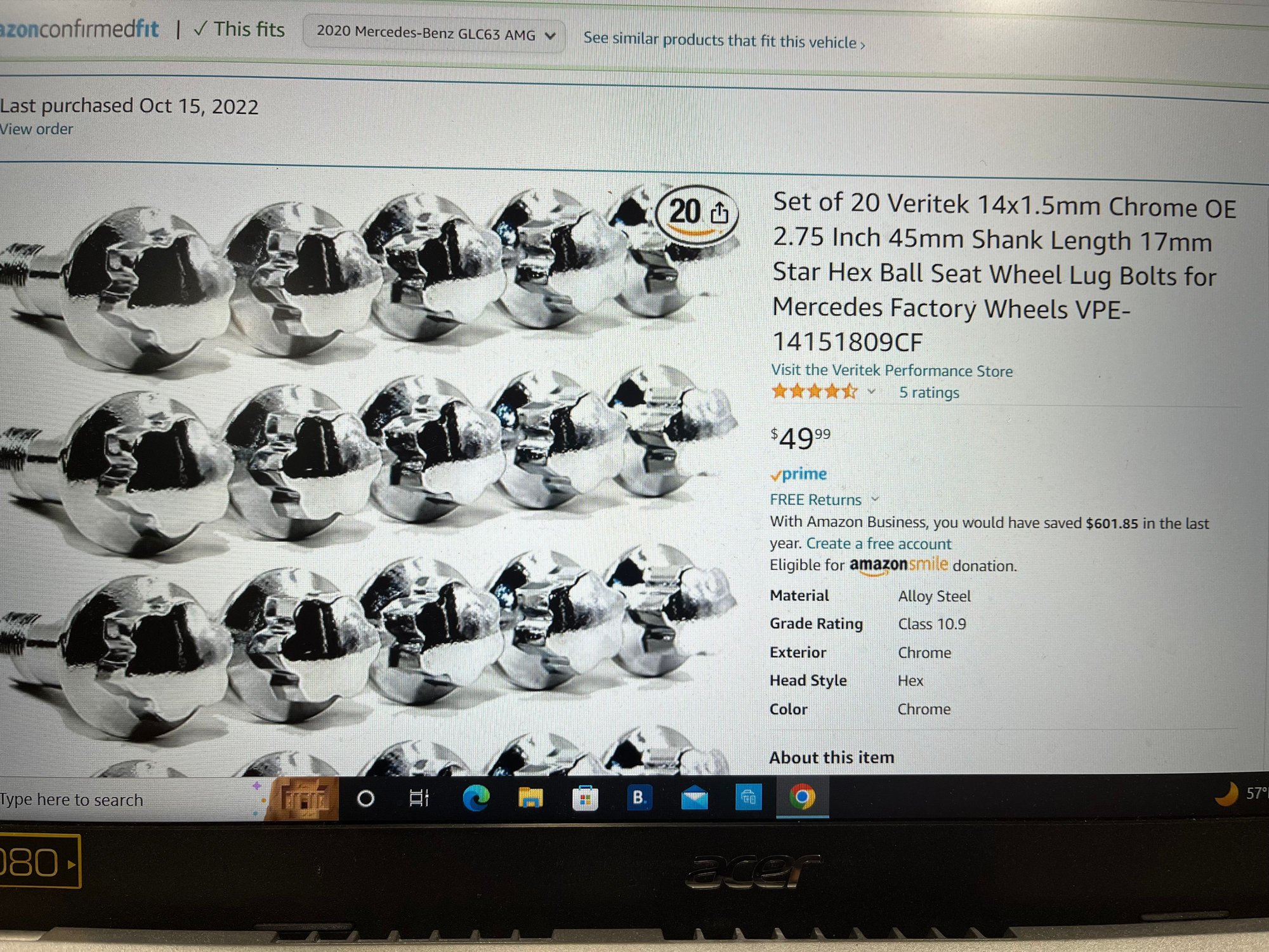

I went out to check and make sure there were not locking lugs on the car and noticed that 2 of my Lug Nuts on my passenger side front wheel were stripped.
I was shocked to find they were only in there hand tight, I was able to unscrew them by hand.
Then I noticed one of the other lugs on that wheel was larger than the other 2 lugs.
So, 3 of the 5 lugs on that wheel were screwed up. I've included pics.

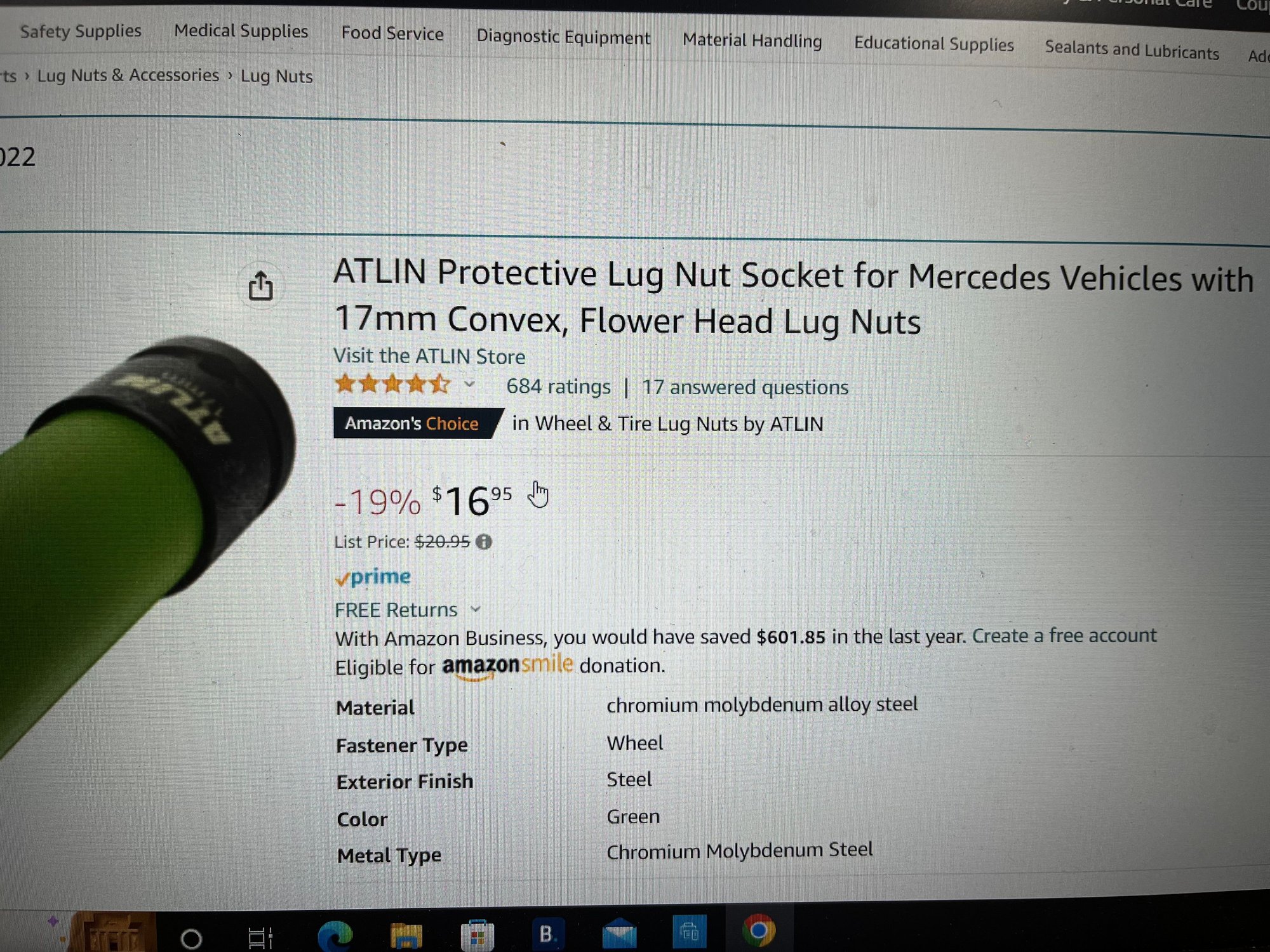

I am going to call the dealership Monday, but in the meantime I ordered new lugs.
Are these correct for this car?

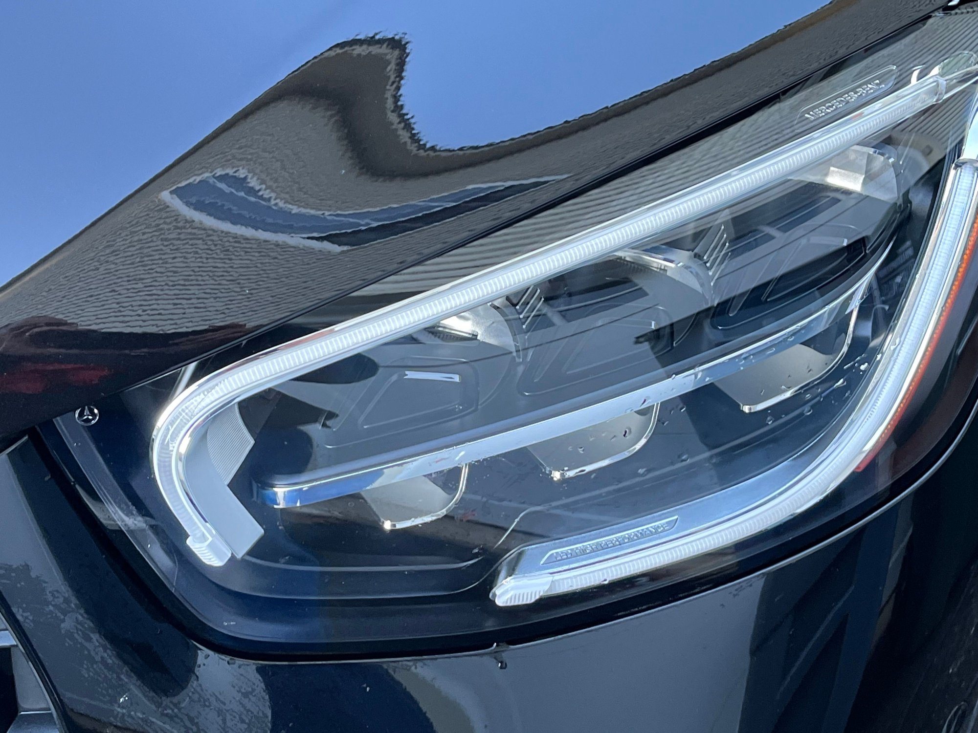

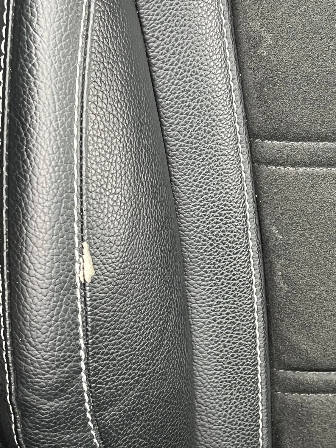

Also, as a CPO'd car I am surprised the passenger side headlight has condensation in it and there is a slight tear in the drivers seat by the stitching.
When I bought the car it was a pouring rain and the car was outside, so I missed things I would normally have caught.
The lug nuts are a safety issue and I have taken the car on the highway back from the dealer 55 miles and up and back to the shore which is 100+ miles each way, I am thankful the wheel did not come off or sheer off the other lugs.
passenger side condensation
driver side

I replaced the two stripped lugs with the new ones, they are perfect.
The larger one I believe is a swollen lug, I ordered a 17.5 socket which I know will be too small for that one, but I might need it on some others that are slightly swollen, and I also ordered a 18.5/19.5 combo socket.
I think the 18.5 will probably work as a 18mm would not fit and a 19mm was too large.
18.5 fits over the lug, but it won't break it loose, feels like it will strip the lug.

Took my garage 30 minutes to get the passenger side front wheel off due to the swollen lug.
The other 3 wheels were ok.
They then proceeded to put on all 20 new lugs.
The aftermarket lugs are a much higher quality one piece design.
