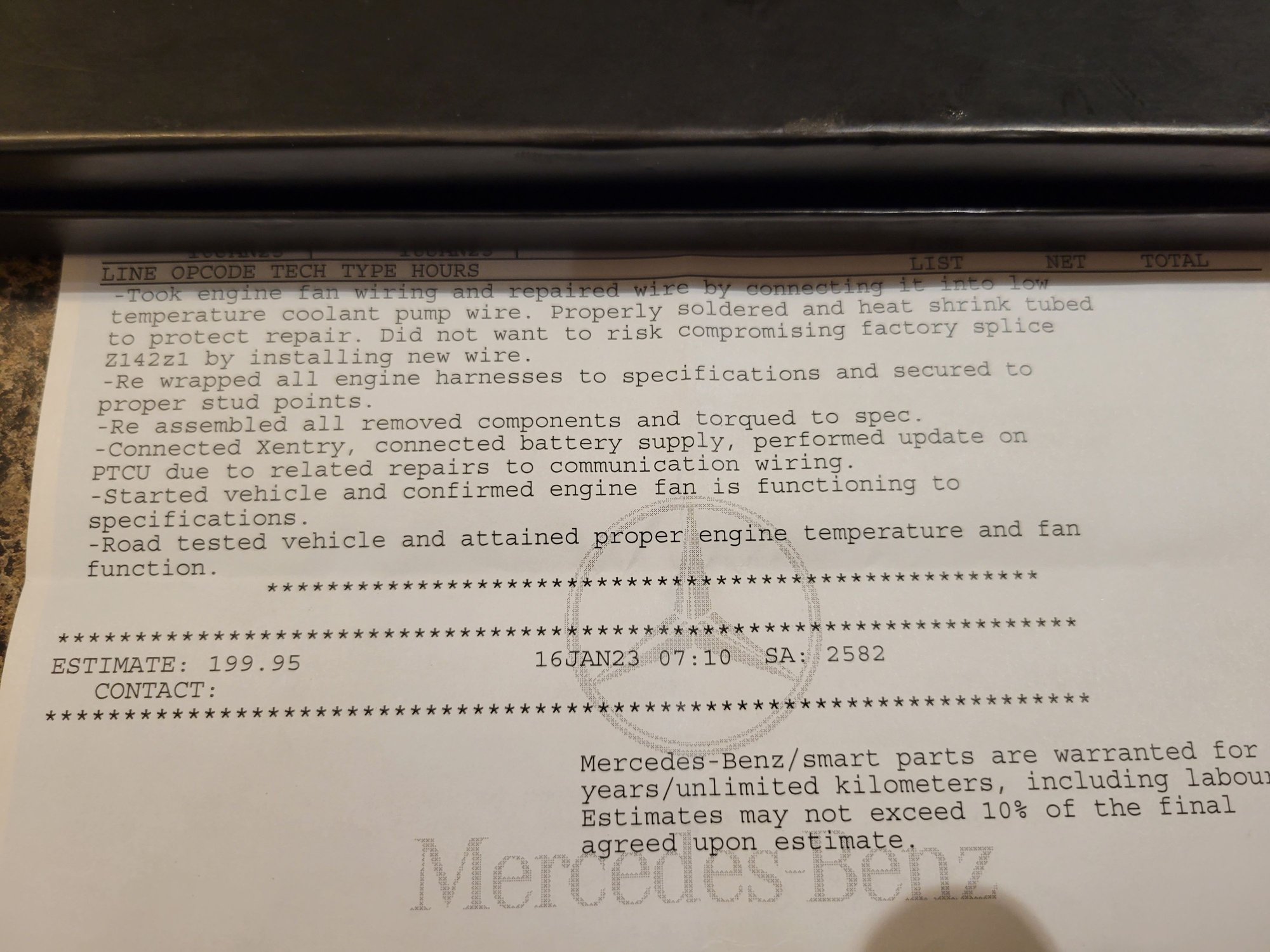

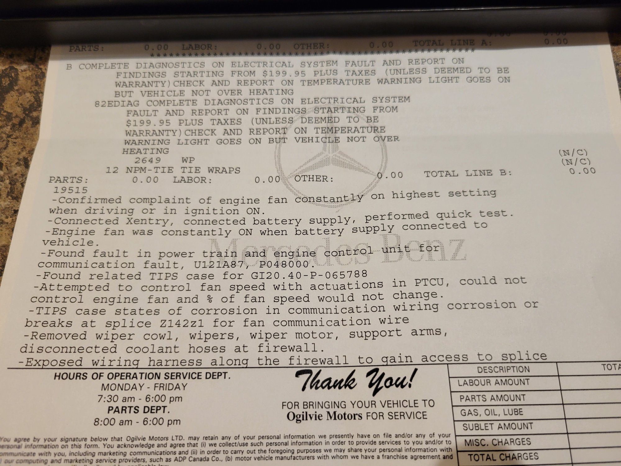

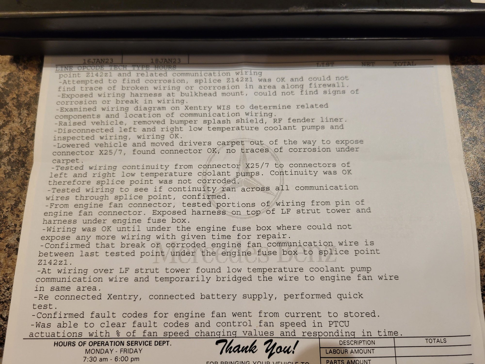

Crazy this happened to you because my 2019 just spent 2 days being ripped apart at Mercedes Ottawa Downtown, for the EXACT SAME THING! Thank Jesus for warranty. I'm going to take a pic of the work order and put it here so you can cross reference. Ended up being a bad section of wire behind the firewall. Took 18 hours for them to find it.

Old Jan 23, 2023 | 01:42 PM
