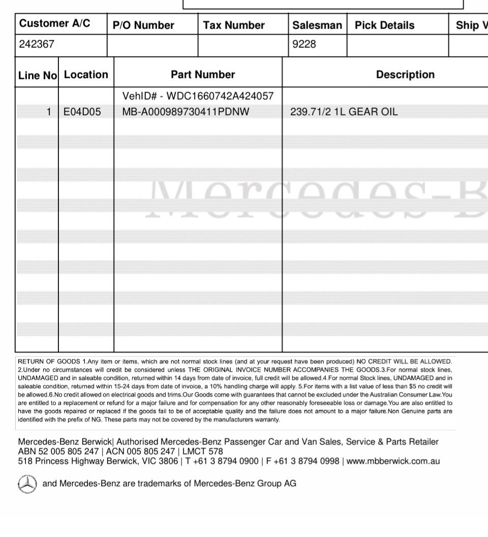

When we bought our GLC43 it had a slight noise from the rear differential when slowing down. There was an updated oil for the rear differential so I did change it with what MB parts called special oil. Well that special oil fixed the problem and it’s been good for over 12 months. So I would recommend you ask the dealer for the specific oil for the diff in your car.

Interesting! There was a big thread on this issue, when did you notice they changed the part number?
I did the diff oil change about 18 months ago.
I can call the guys at MB and find out if you think it would help.
Much appreciated, please also post the work order if you find it : )
I just called him and he looked back over my invoices and he gave me the same stuff for my 63.
There was no work order as I do all my services.
It’s about $180 a litre.
Much much appreciated!!!
