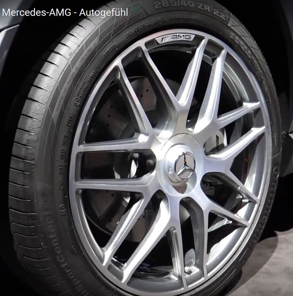

Here is a photo of the 22' from the AMG 53. If I could have these in 20' inch, I'd go get my checkbook right now. I have read the GLE 53 AMG will have 20' wheel options, so when to DOG comes out I'll be paying close attention.
Thanks to each of you who responded. I'm going to stick with the 20' to maximize the ride quality. I absolutely love the look of the 21', but... I won't notice how nice they look while I'm driving down the road.
Thank you Again,
Kind Regards,
Neil
Those are hot.

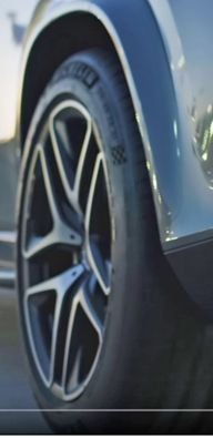

Looks like these are the 20"s for the GLE 53, whichI'm not sure I particularly care for. Does look like a staggered fitment, though?
