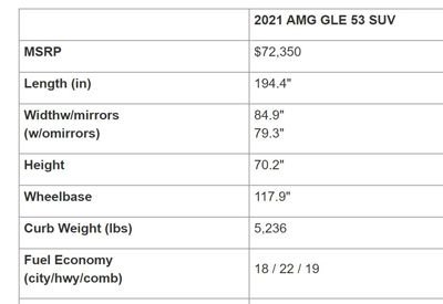

Originally Posted by Ron.s
My GLE 53 weighs just a little over 4K, a lot lighter than many comparable’s.
Did you mean 5K? According the MBUSA the GLE 53 curb weight is 5,236 lb. (and that's likely without the big brakes). Hardly a lightweight.
Old Feb 7, 2021 | 06:21 PM
Ron.s's Avatar
Joined: May 2018
Posts: 3,391
Likes: 1,040
From: Boise
2024 GMC Canyon Denali..... 2018 Audi SQ5
Yes sorry 5k...fat fingers. About the same weight as our smaller SQ5.
