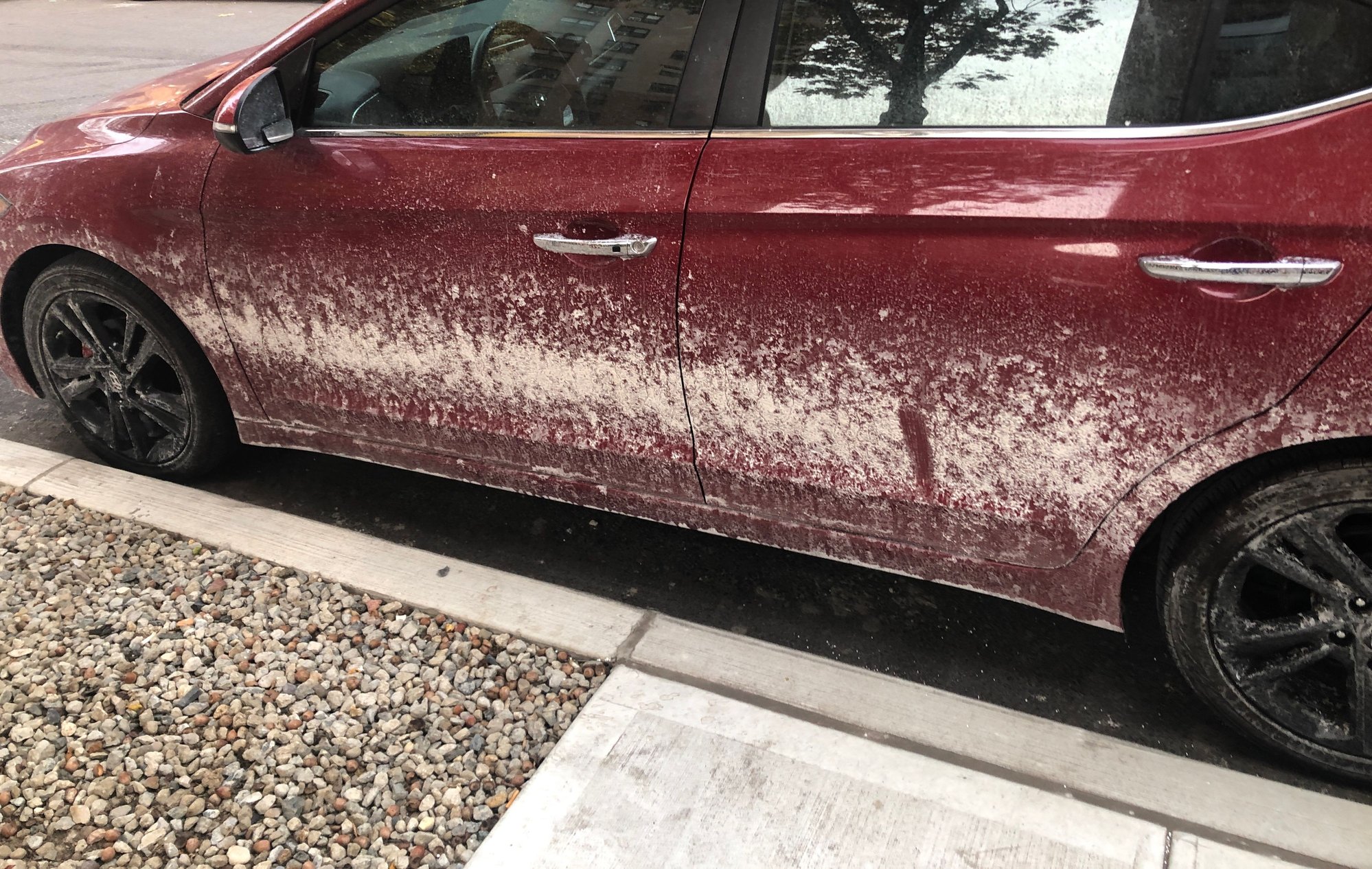

Uncoated vs coated

Just an update today, a bit over a month in. I drove over 500 miles this long weekend, transported a Christmas tree, got stuck in mud, and overnighted in a snowstorm. Today, I went to a coin-operated carwash, and just sprayed the dirt right off.
No scrubbing, no mitts, nothing at all. Everything just slid off, I am super pleased with the results. I didn't even bother drying the vehicle off, some water spots here and there but overall super clean. I've done GYEON VIEW on all windows, also awesome.
