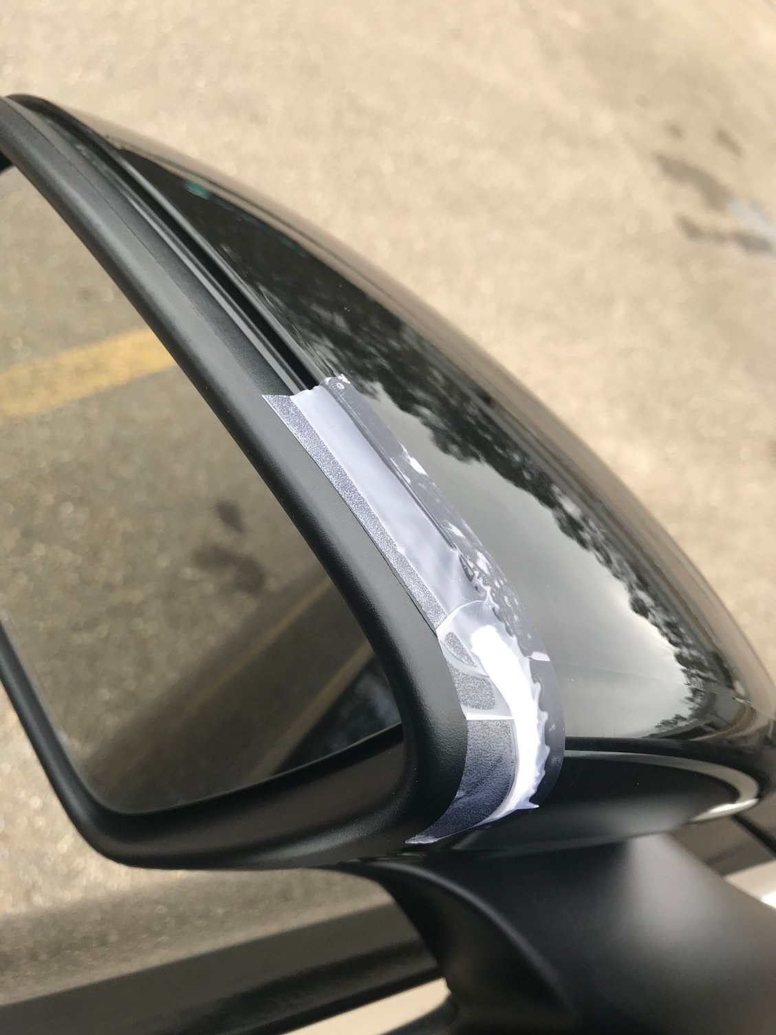

Just to verify it was the mirror... a simple piece of clear scotch tape with a part of a napkin in the corner. Some of the whistle did go away...not all
The tape needs to be wrapped around the entire gap. The oring fix someone posted will fix it and not noticeable but permanent factory fix is to seal the joint in the gap. I purchased the oring but my vehicle, a 21 GLE53 AMG Coupe does not exhibit this problem. I also believe there was a TSB fix from MB on this sealing the joint between the 2 surfaces from inside the housing. You guys need to go back and read the thread from the beginning. I am finding out that Porches and Audis are better built than MB. Wished i had kept the Cayenne. Service is much better at the Porsche store. The factory also has better support. I just don't think the rednecks in Vance know how to design and build cars even though they've been there longer than I can remember. I've learned my (102K) lesson.
