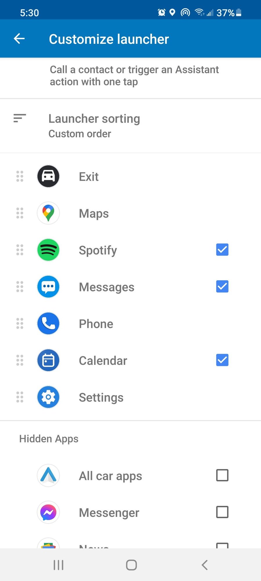

Hi All,
I am able to connect to Android auto with the new 2020 GLE, and have every application expected except Waze. It does not show in the main menu of Android auto. On Android Auto menu customization, I see Waze listed, Waze is available in AA without car connection, and works on a VW. Tried a different phone as well. Anyone have an idea? Phone, car, cable, operator?

Well was able to get this working in spare time... Need to set Android auto into developer mode to enable widescreen AA.

you have go to AA and enable "developer mode" and check option allow unknown sources, so i solved

I have a new Samsung s21, and a USA 350 gle....I don’t see Waze as an available app in AA, even when I go into Dev mode....could someone pls provide a step by step? Tax!
You also need to check "Unknown Sources" from the developer settings menu.

Yep, I selected Developer at the top and the only item.i selected was outside sources. It didn't expand the choice of apps though
