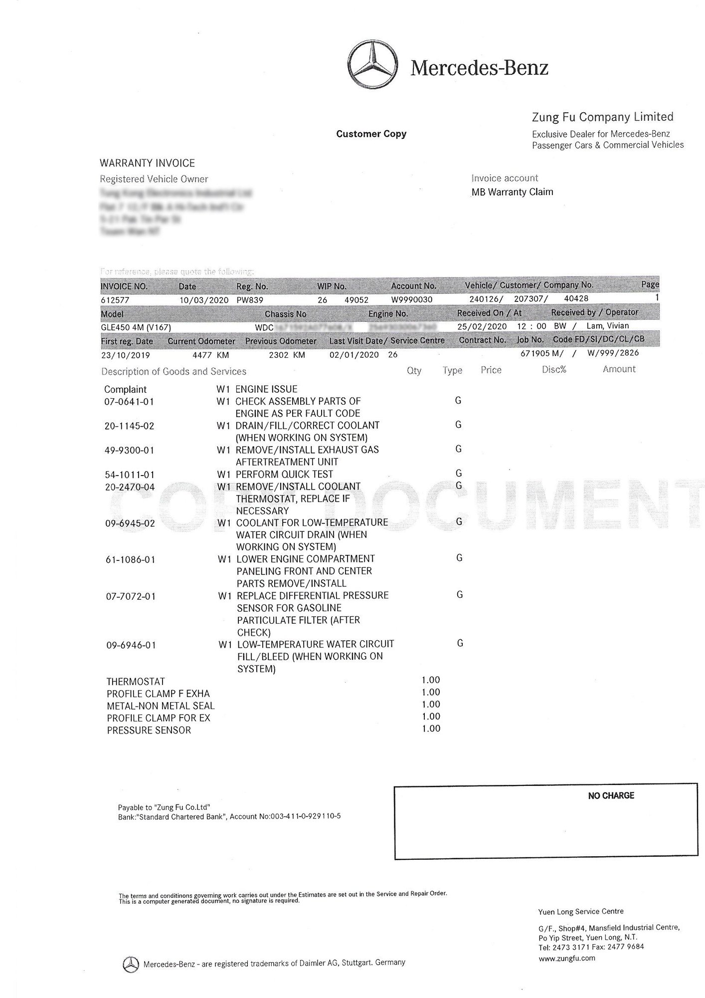

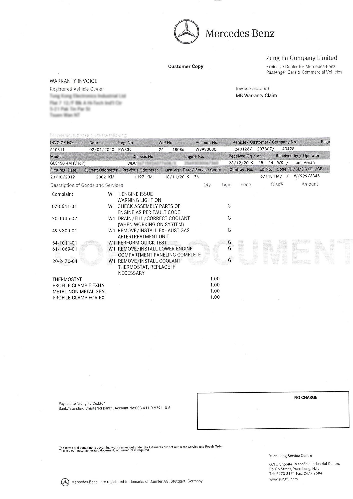

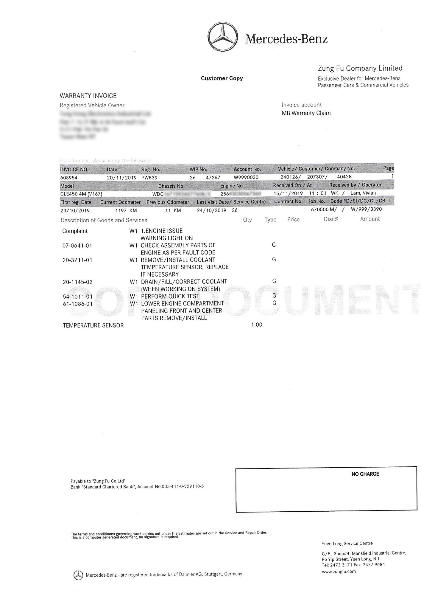

I got my GLE450 4M on 25 Oct, and I bought that for my newborn grandson
but the engine light of my car just illuminated for 4 times already. it is completely ridiculous to me.
And I think I will MB to exchange a new car for me.
here is my uploaded invoice from the MB warranty claim, you can see there are some parts need to be replaced repeatedly in 3rd time.
are there any similar issues from you guys.
I would like to know more about it.

Laoban... from what you have posted from your MB Dealer's service dept - the situation as I see it - those "components" have not failed 2-3 times - it's the electrical "harness" and "control modules" that are suspect.
Your situation "might" be related to a early 2020 GLE problem - see link below:
https://mbworld.org/forums/gle-class...e-s-450-a.html
