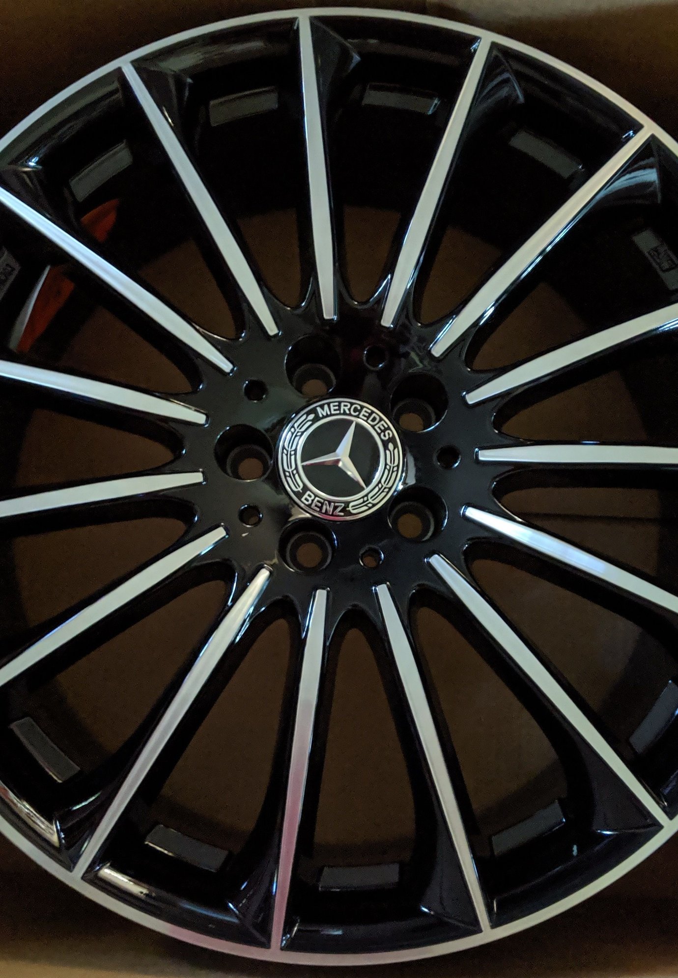

It could be that the wheel structure still doesn’t clear the brakes....not likely. Or maybe the are just pointing out the different offset. In the US we have a reliable company (TireRack) that provides good fitment advice and great pricing. The 8 1/2” wheel is narrower than the 9” that came on my GLE with AMG Pkg. You have some different wheels in the U.K. but even those seem pricey. I got a second set for under $1200 delivered with lug bolts & tax of 6%. Paid another $20 for center caps. The offset is off slightly from stock but not noticeable. Here’s a link and Pic.

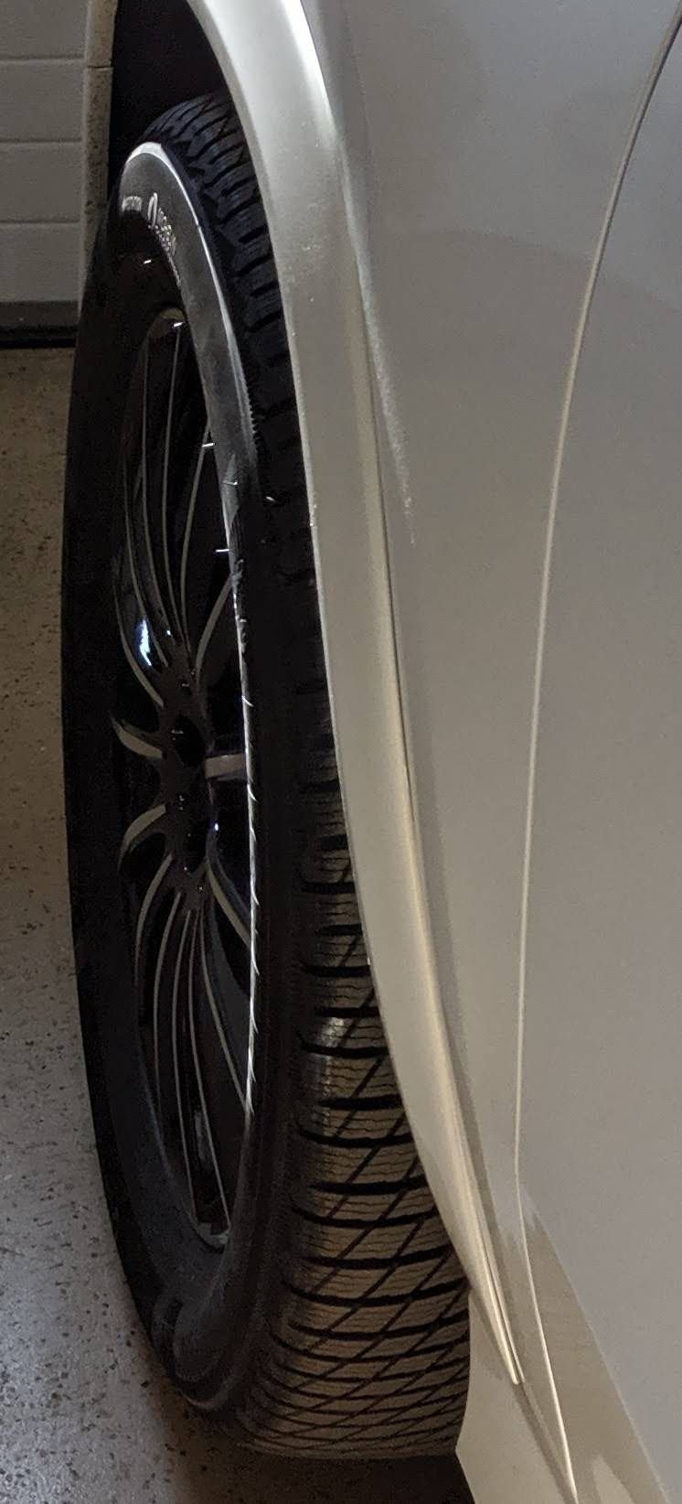

As I mentioned mine came with 9”-et 57 Fr; et 44 Rear. The 21” AMG comes with 10” & 11” wheels so there has to be some wiggle room on the brakes. Here’s a pic of mine wearing winter tires and the front where I’m about a 1/4” wider. Still narrower than the 21’s with a 10” wheel.

Yes to both questions. The wheel isn’t exclusive to Tire Rack & is probably made in China so there should be other vendors. I actually found these after a lengthy search for higher et wheels. A year ago there was very little info on fitment.

I can’t see there being a problem with the rear wheels as the ones I’m looking at are almost identical to the ones you have.
The offset of the fronts I’m looking at mean the wheel will be a little closer to the caliper than yours - how much clearance do you have left?
I suppose it will also depend on the thickness of the spokes as mentioned above.

I have factory wheels on for summer. There seemed to be as much clearance but didn’t measure.

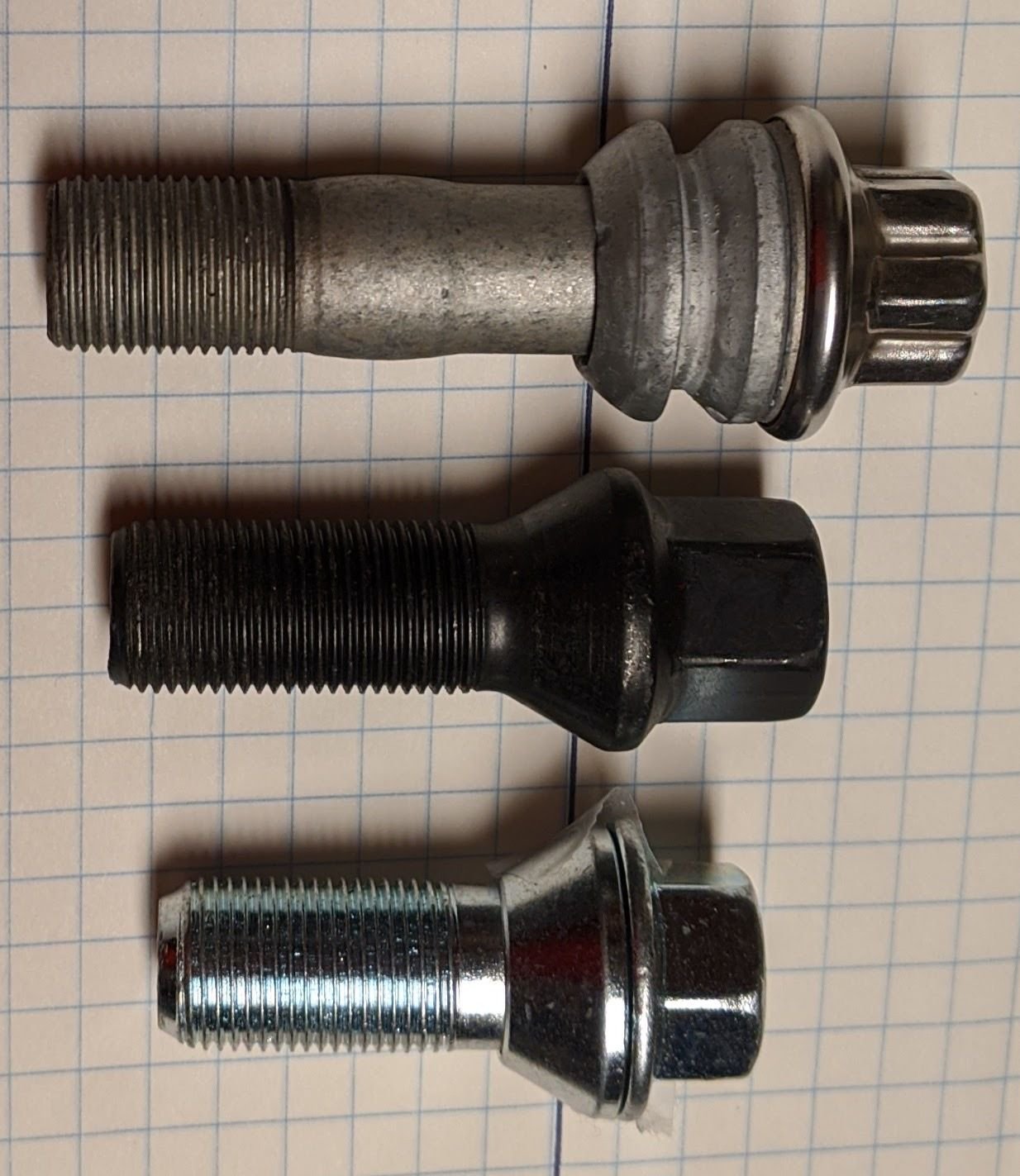

I keep forgetting one important thing. The prior Gen Mercedes had 14mm lug bolts....the new one has 15mm. You may have to drill out the bolt holes on the wheels but can probably use your same cone shaped lug bolts from the GLE V167. Most AM wheels have conical seats and will take shorter bolts. The Conical 15mm are available now But might have to be purchased separately. Here’s a comparison showing lengths and shape.
Ok thanks for your advice, much appreciated!
I have emailed Tirerack and they do actually ship to the U.K. - just waiting for them to email me back a quote of the shipping costs.
I am sure they will be able to advise on the bolts.

Tire Rack supplies bolts.
