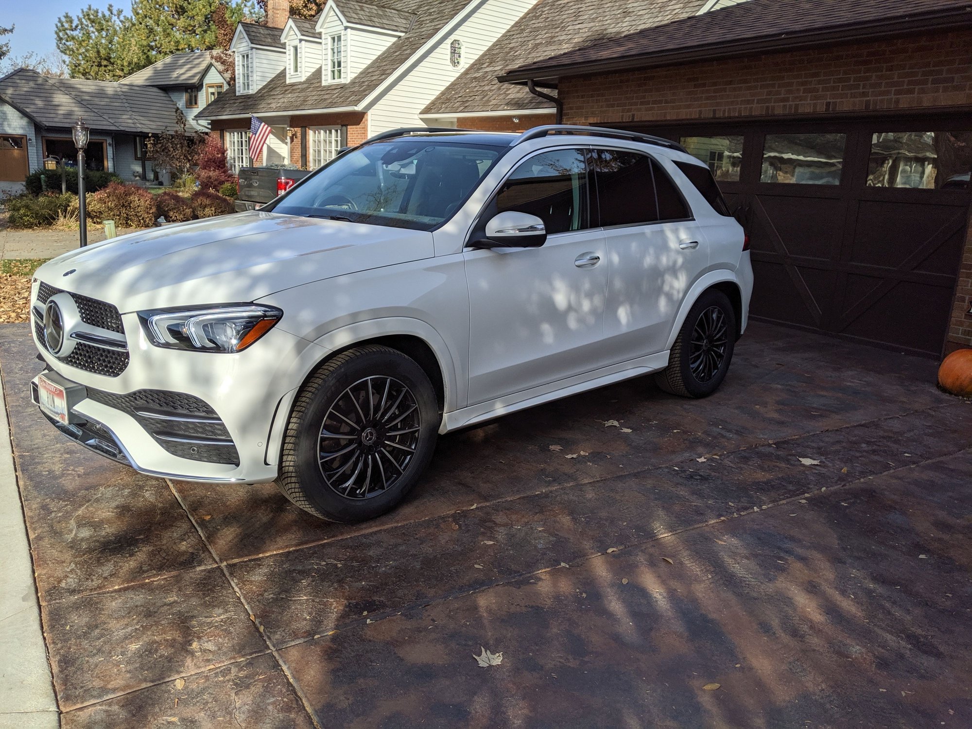

Just saw your picture Ron. Nice wheels.
I'd like to avoid having to use spacers and extra long lug nuts to clear the brake calipers if possible.

Mine were on my 450 but I have a GLE 53 coming any day and have researched fit...as well as I can without actually installing them. I have the larger brakes on my 53...same as the 63. I checked with my SA to be certain and he went into Netstar and was able to option my build with 20” wheels but it also required the Summer Performance Tire. So I’m convinced the 20’s will clear the brakes and a lower offset will move the wheel out from the brakes. I don’t know of any aftermarket staggered wheel options. I also can’t find anyone that will recommend anything but tires for the 2021 GLE AMG models.
The other issue is that the aftermarket wheels take a conical seat M15 Stud bolt. Tire Rack and a few others furnish the bolts. I bought black ones from Otis LA.

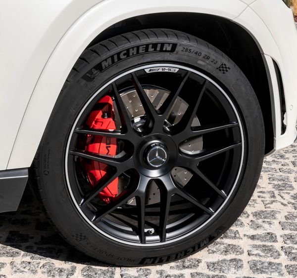

GregW, there's a poster with 63 and he states that his front rotors are 16.5" diameter (I questioned him on that and he was kind enough, he said, to measure and indeed confirm they are 16.5" and since I do not have excess myself I have to take his word). Since you've done a lot of "wheel work" on your 450, did you by chance measure the front rotors' diameter? There's no way they are 16.5" on 450, that is for sure. Are they even 15.8" on 450?
Edit:
this is that post - https://mbworld.org/forums/gle-class...ml#post8195690
Edit #2: It looks to me that for '21 for 450 with AMG exterior, they downgraded the front rotors vs. '20 - solid instead of perforated rotors, and diameters look definitely smaller than on '20. Since I never paid attention to 167 GLE for MY '20 (since there were no AMGs), but started for MY '21 (since I am interested in AMG) it seems to me that since for MY '20 there were no 53/63, maybe MB in fact did use (perforated MY '21 GLE53) 15.8" rotors on front of '20 450 ("AMG" exterior) and '20 580. However, for MY '21, at least for 450 ("AMG" exterior) that I've seen on dealer lots and on their sites, all have solid and visibly smaller diameter front rotors than 53's rotors. So "53 front rotors" were a one year run for MY '20 450"AMG"/580 but not anymore.

High Performance brakes on the AMG GLE 63...optional on the 53:
“Enormous 16.5-inch front discs are grasped by powerful 6-piston fixed calipers. The one-piece rear discs measure 14.6 inches”

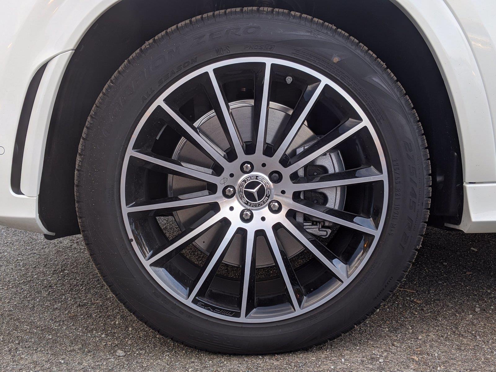

The 6/16/20 '21 GLE order guide I'm looking at still lists larger perforated front rotors for the regular GLE with AMG exterior package.
Above picture is 53 with 63 brakes. I'm more talking about 450 (since there was a mention that 20" wheels from '20 450 "AMG" exterior will fit 53/63 because of the same rotors). This is the link to pictures of '21 450 "AMG" exterior: https://www.autonation.com/cars/4JGFB5KE3MA315493
The rotors are not perforated and clearly much smaller than on 53 and on '20 450. The image is below:
Specs for above '21 GLE450 "AMG" exterior state front rotors are 14.8" (may be an error, but pictures do not lie), while we now know that 53's front rotors are 15.8" (63's 16.5" are $2,500 option on 53 or part of $5,000 package). So the only way to know if 20" wheels that fit MY '20 450 "AMG" will also fit 53 is if '20 450's front rotor is in fact also 15.8" and not 14.8".
