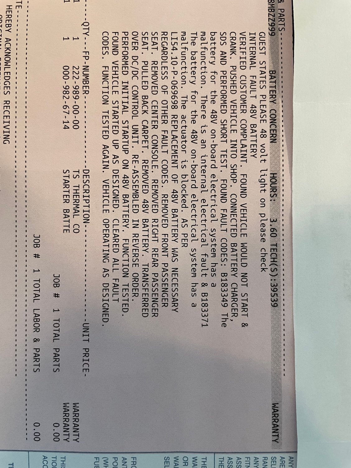

  #249
tony cls63's Avatar
Joined: Jul 2011
Posts: 73
2009 Dodge Viper 2019 GTR 2017 S63 coupe 2014 Rubicon X 2014 GL63
Here are the parts they replaced on my 2021 GLS 63 with 194 miles
Old Aug 4, 2021 | 04:03 PM
  #250
tltworld's Avatar
Joined: Aug 2021
Posts: 15
2025 S 63 E, 2021 GLS 580, 2008 S550
Thanks Ron.s and tony_cls63. The part number for the problem battery was reported to be 000-982-68-1 so the number you provided may be the replacement battery, although you would think it would be a higher sequence number. Something else to ponder…..
