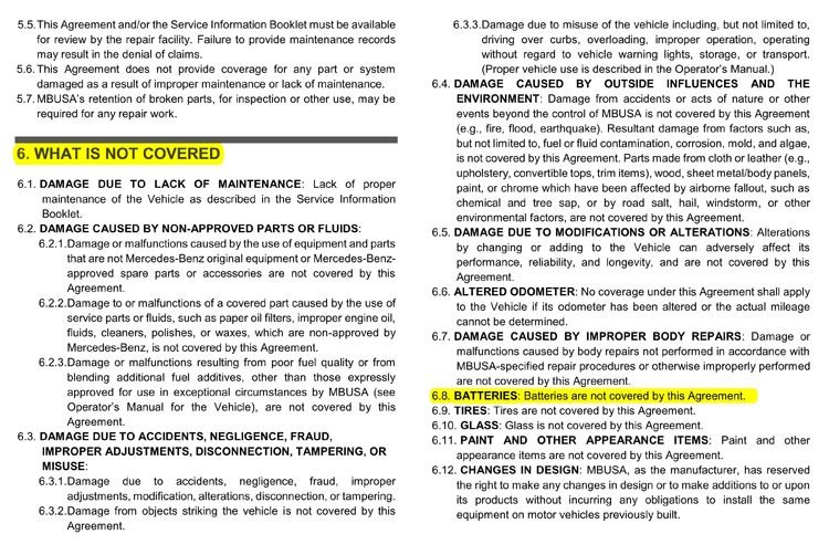

Just went into the Mercedes USA website. You have to hunt a bit for Extended Warranty details but under EXCLUSIONS the first item was batteries.
Toban
Toban
If you purchased an ELW you should have a written agreement as part of your contract. This is an excerpt from mine:

There is also an additional exclusion for electric drive vehicles. Our 48V Mild Hybrid should be between uncovered normal 12V battery and full Electric/Hybrid battery.6.14. ELECTRIC-DRIVE VEHICLES: Maintenance, service, and replacements of/to the Vehicle’s lithium ion battery are not covered by this Agreement.
I presume our only course of action when the time comes is to petition an early or reliability failure like the other owners experienced during normal warranty period. Lets see what is ELW for the new EQS.

Yes, we all know "batteries" are not covered. They are operating under the assumption this means 12V and are telling me as such. This assumption can only harm me, so I'm pushing for an answer as hard as possible.
When I called the Mercedes Care earlier today, they told me they only deal with the factory issued warranty, not ELW. So back to the dealer I call and get ahold of my salesman. I'm hoping to have an answer tomorrow.
The primary issue I have is, how can they sell me a warranty without being able to tell me what's covered? Disingenuous, deceitful, misleading. Had I known there was a 48V battery in the car I would have asked.
