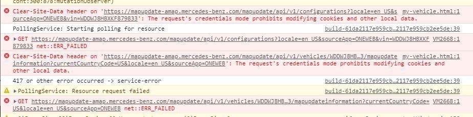

Ok, figured out what's going on. It works with Firefox, but not Chrome or New Edge. Was looking at the errors and one error is due to the way Chromium handles certain requests, so I figured those who are saying that it works for them must be using a different browser. It's downloading the maps now.
Been waiting for weeks for this upgrade. Just succeeded with Edge. Just curious. What were the specific problems with Chrome/Chromium that you found?
It throws all kinds of errors in Chrome, but below is what appears to be the main issues for why it's failing. They are trying to clear/modify local data that Chrome/Chromium does not permit. I assume you had success with legacy Edge, because New Edge is based on Chromium and doesn't work for me, either. I no longer have legacy Edge on my system.
