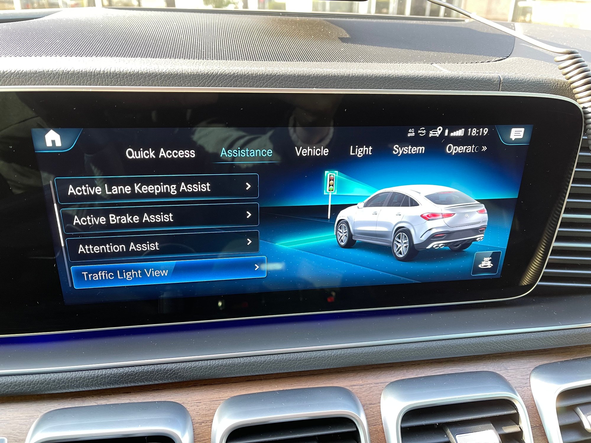

Yes, you can turn that off here:
In my car there is not such option under the Assistance menu and it is part of the augmented reality features and to access this feature you need to go into the advanced settings menu under the navigation.
I guess the difference is in the MBUX software, my car was built around Nov 2019.
My Version is: ntg6_fup2/063
What is yours?
What is yours?
You're right. Mine is a tad newer:
