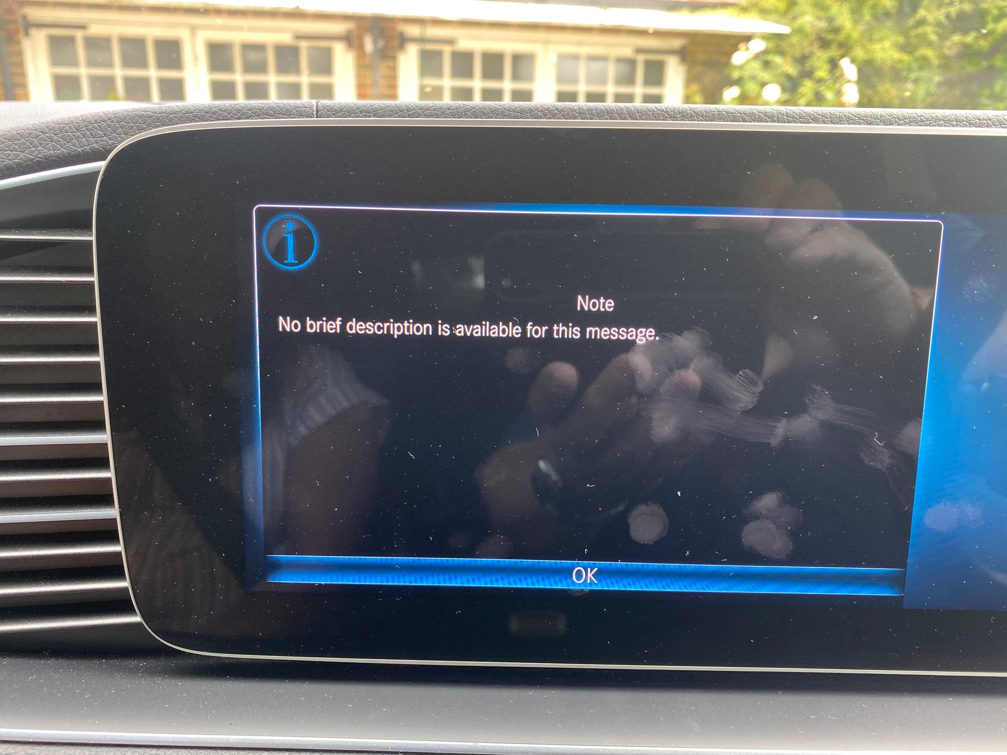

If you swipe left and select the 'i' instead of the 'x' to dismiss the message, do you get more information?

I tried that and the main screen tried to open a URL but the URL wasn't found or it said no more information or something like that. It didn't answer the question.

Got the message again today and selected the i as you mentioned and got this..
Message received after you select i after the yellow thermometer message.

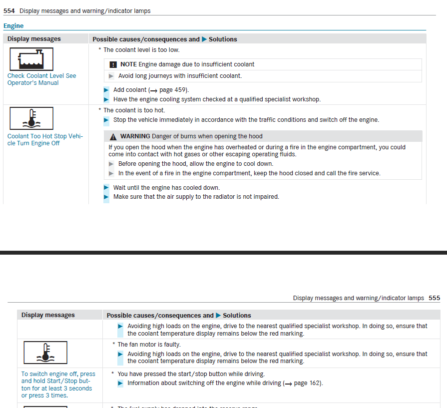

According to manual, the icon (without text) could means the fan motor is faulty.

I don't think it is the transmission oil temperature? Based on the one above (same icon, but with text), it said "The coolant is too hot" which kind of point to the engine temperature? But I could be wrong.
