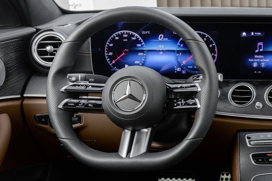

Yes, I believe the E-Class was the first to debut the wheel with the capacitive sensors on the wheel and buttons. Should make it work much better, but doesn't help those that don't have it.
New wheel looks like this:
