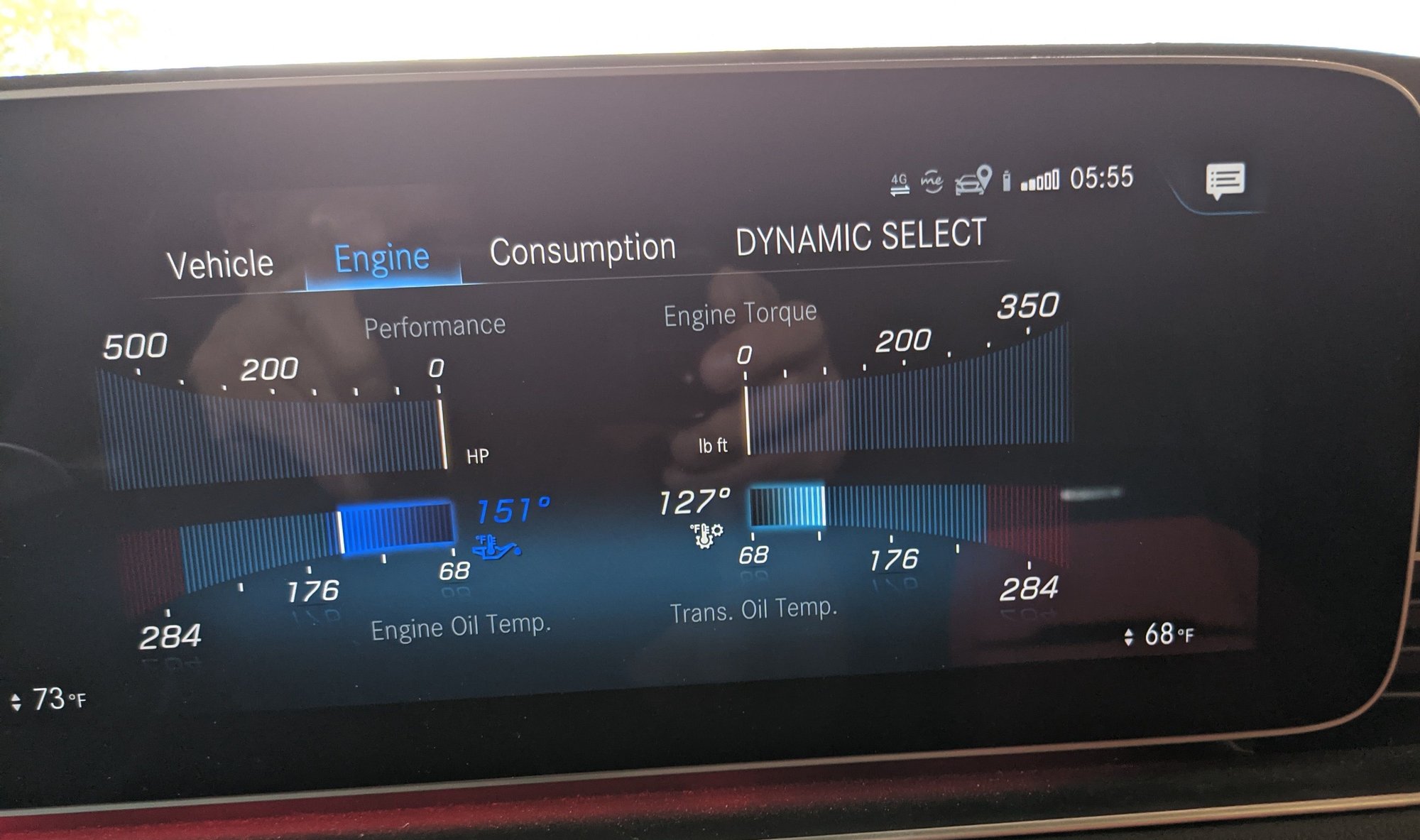

Yes, I don’t recall there being anything on my GLE 450. Excuse the reflection of my hands, but here’s a screen shot. There is some useful AMG info but as usual it’s not always easy to get all info that you want at the same time.

Another way to find it would be in the DYNAMIC Select - Engine Data screen (for COMAND at least). I don't quite remember what are the menus to go into for MBUX which your car has though.
Edit: Nevermind the post above me shows what I am talking about, thank you Ron.s for posting.

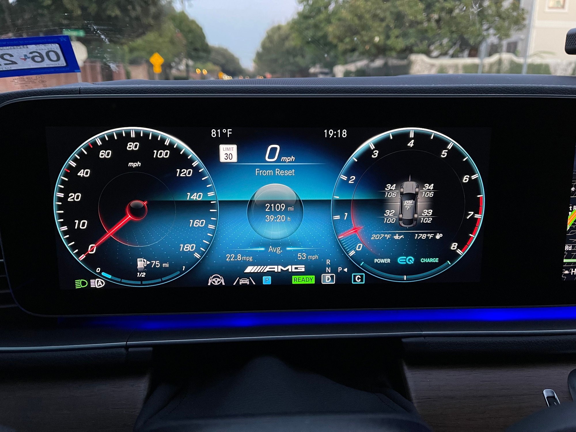

Update. Temps weren't as bad as I first thought.
After checking my displays, I was reading the temps incorrectly. It was the WATER temp that was high, not the trans fluid. And the max temp for the coolant was 236, not 276.
Much ado about nothing, and I remember now how a quick glance at instruments needs to be confirmed with a longer look! Which explains how the temps "quickly dropped to 210F."
At least I feel better about not finding a transmission dipstick, cuz there is none!

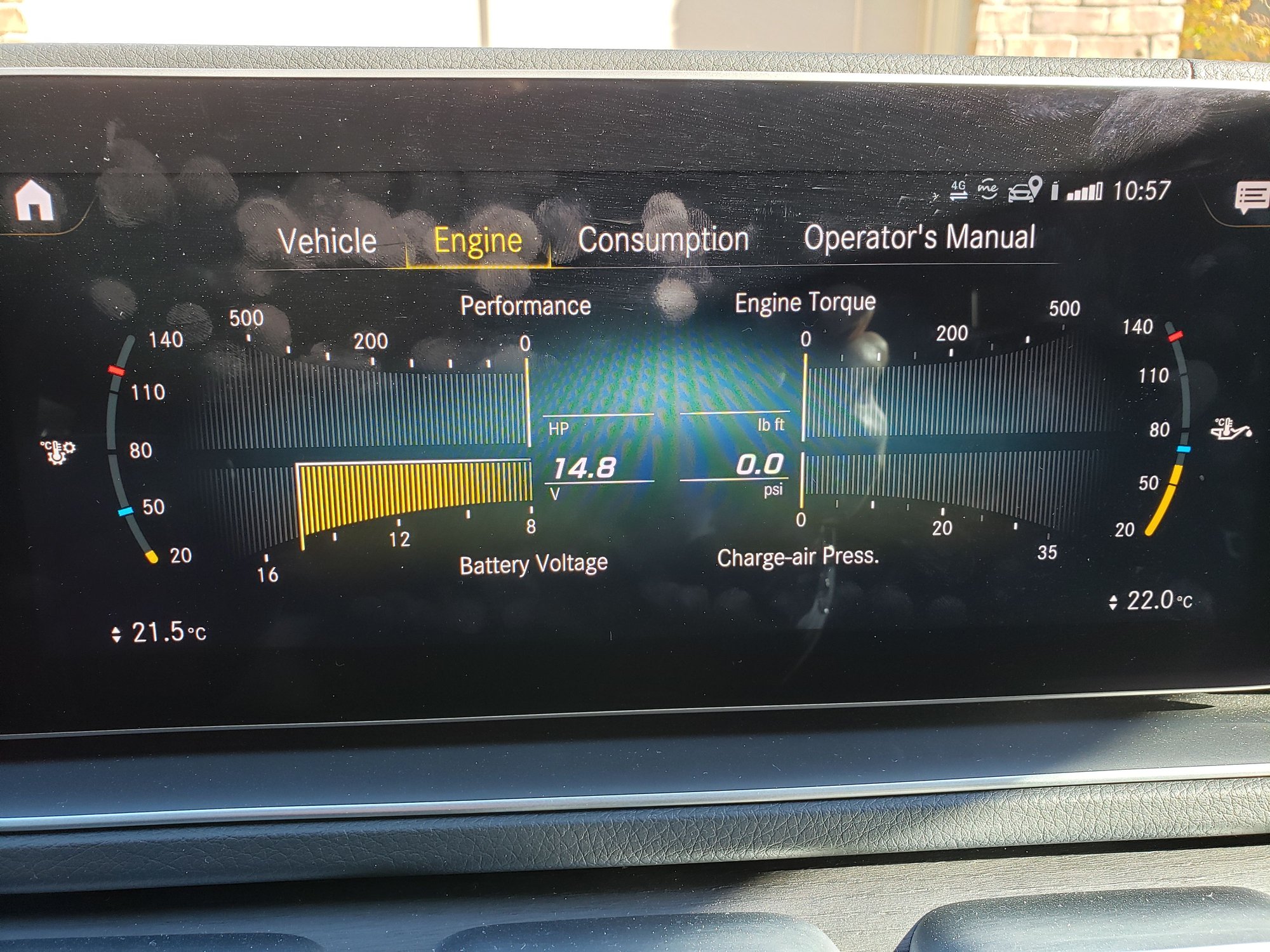

Where do you find the battery charge voltage gage on the AMG? My guy says the AMG does not have battery charge or voltage gage. Can you give me a pic of it on the AMG cluster?
Doesn't the display you posted in Post #11 show what you're looking for?
Other than that, I don't know of a voltage display. I set my radar detector to display voltage, which is at the cigarette lighter, but I'm not even sure if it displays "system" voltage. I'd like to see the 48v status, too.
Thanks for the answer Mikapen. Yes it does show voltage for the 12V system on the GLS580 but I am looking at the AMG model and comparing the differences. I was surprised to hear there is no voltage gage at all on the AMG version.
I agree, it is in that picture.
