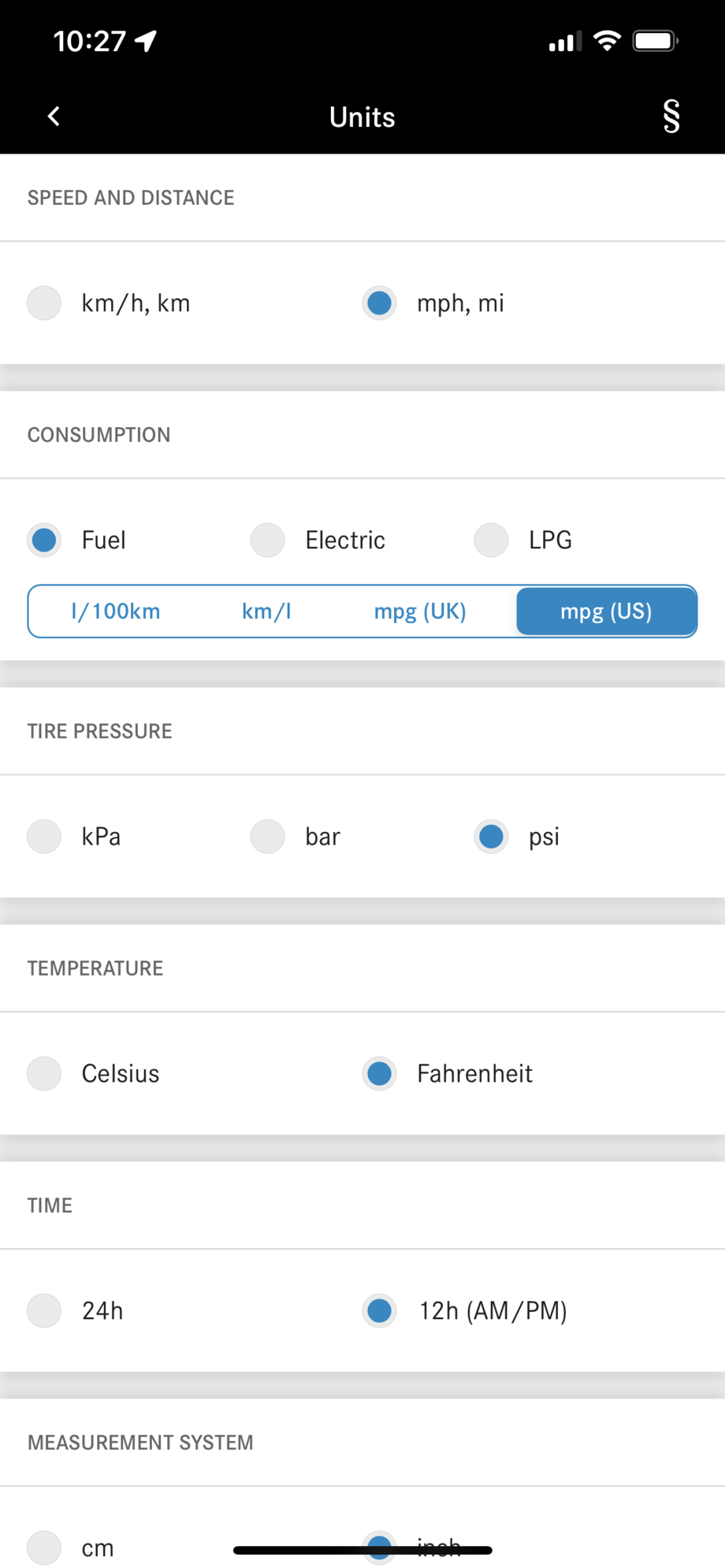

Anyone know how to change the units from Celsius to Fahrenheit in the app? YES, I see the option in settings to change it, however even with it on Fahrenheit it still shows temp of car while Remote started in Celsius. I have signed out and back in and I think I even deleted the app and reinstalled but temperature of car still shows in Celsius.
THANK YOU in advance.
EDIT- let me also add in the car itself everything shows in Fahrenheit. It’s only the app, after remote starting shows temperature in Celsius.

You need to change the unit settings in the app. In the App, click the three bars on the upper left of your phone screen then click settings then click units.

Thank you. Yes, I tried that multiple times. It’s on Fahrenheit but still shows Celsius when I start the car and shows the temperature of it.

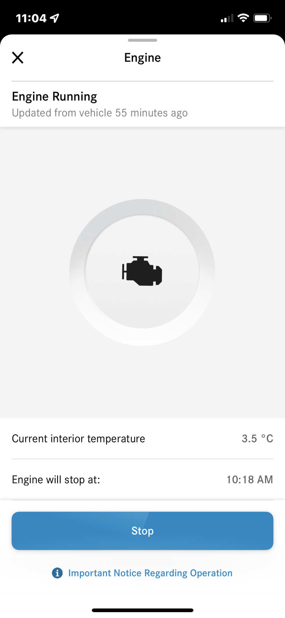

Everything in car shows Fahrenheit. Settings in car as well as my profile shows Fahrenheit. It’s only when I start the car it tells me what the temperature in the car is in Celsius in the app.

Mine does the same thing. At this point I'm waiting for MB to update the app to hopefully fix the bug.

I see, it only does that on the remote start app screen...agree it looks like a glitch in the app.

You probably need to contact the support to report the issue.
I have to do that a while back where they display the range wrong (the number showing is in km, but unit showing is based on the unit you have selected, so it just say 555 km or 555 mi depend on the unit you selected, but the actual "number" part is in relation to km), and it took them like 3 months to get it fixed.
