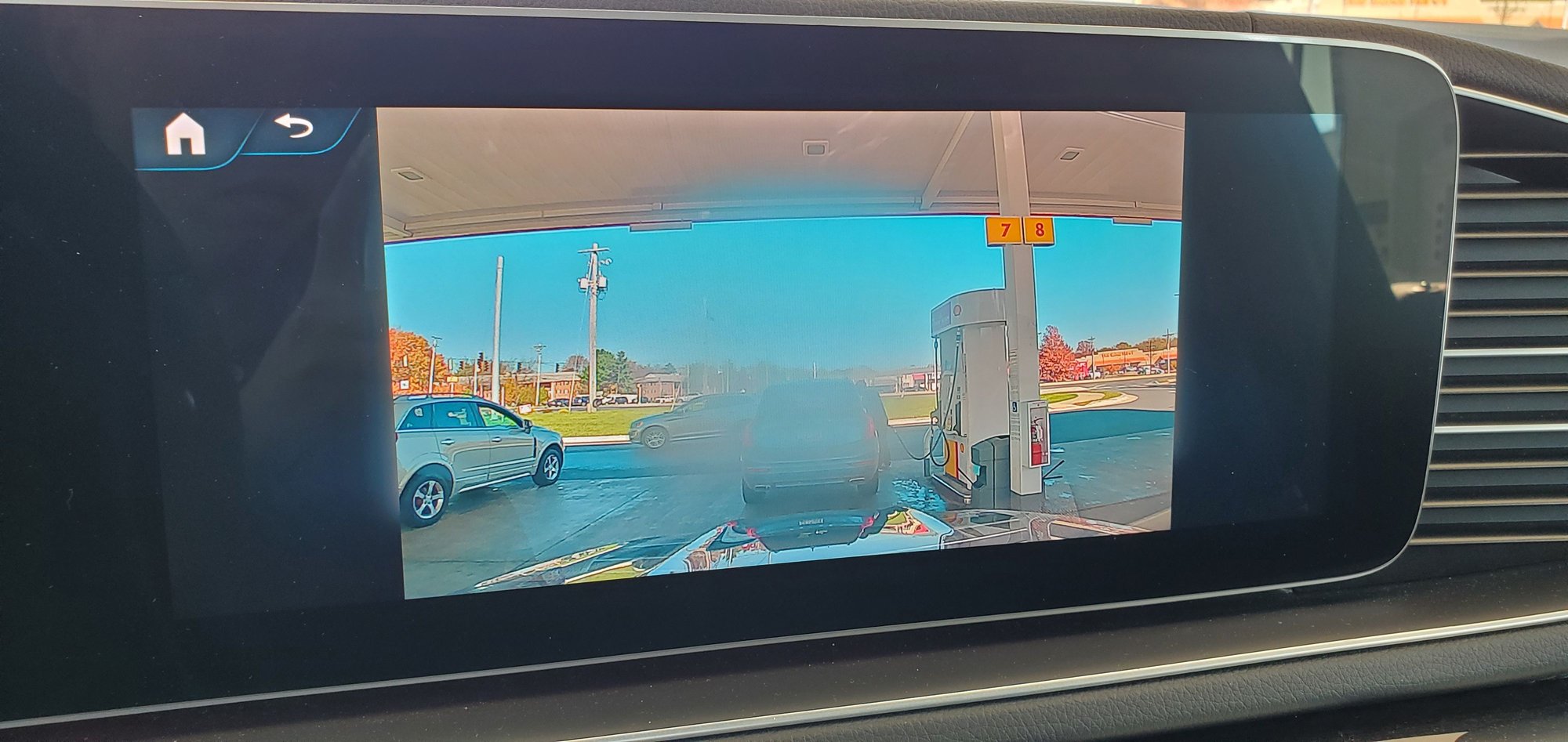

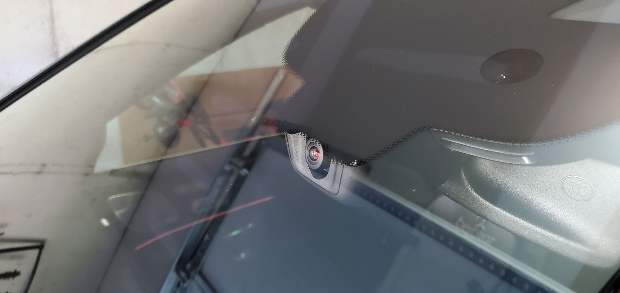

I had similar issue with condensation at the camera in the center right below the mirror.
I was driving on the highway with driving assist on, and when I am near my exit,I found that the buttons does not deactivate the cruise control (cancel, on/off, set buttons on the left side of steering wheel). I have to step on the brake to "cancel" it as I was getting near the exit.
At the traffic light on the exit, after the car come to a complete stop, there are multiple warning light, don't remember the exact one, but it was related to driver assist, speed limit assist, lane keep assist, etc. I also notice that the "traffic light cam" has a bury spot in the middle which is an indication of moisture in the lens.
When I first visit the dealer, they couldn't found the condensation, and I don't blame them, as it only happen on a very humid date, and with temperature difference from inside the lens and outside.
The next time I notice the issue, I have to take a close up picture of the lens which shows a "fog" spot in the middle of the lens, and the dealer replace it.
Here is the photos I took: (back in November of 2020)
This is picture I took right after the exit at a gas station
And this is a close up picture of the len, notice the small white fog in the middle.
I think what happen in my case, is that the len wasn't seal correctly. It was cold and humid outside, so I have heat on when driving to work. After I parked the car, it starts to cold down, and the "unseal" len start to draw moist air into the len. After work, when I start driving (heat on of course), it start to heat up the interior, and as the area around the len heat up, because of the cold and humid air inside the len, it form the condensation inside.
The weird part is that I would expect myself still be able to cancel the cruise control using the steering control even with the len partially blocked, but wasn't, and the lane keep assist was working up to that point.

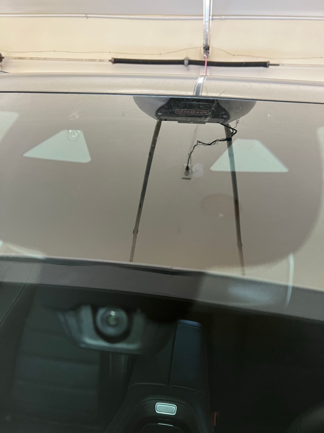

Ron, I have had that problem with two cars, but the solution my Dealer found was different.
Our 2020 GLE450 built 2/20, was awful, dangerously braking in heavy traffic when it saw a sign on a frontage road. I complained, they replaced the camera, but it was just as bad. They found a Tech Bulletin about the cameras being shipped from the supplier, with haze on the lens. The solution from the TB was to clean the new lens with alcohol and reinstall. It worked. This was October 2020. Although I seldom use the automatic feature, the speed limit display was no longer fooled.
On our 2021 GLE53 built 2/21, we had a windshield replaced (July '21, at the Dealer with M-B glass) and there was a problem separating the camera from something, so they replaced the camera. It failed their checks, and they found that the new batch (not included in the original Bulletin) had the same haze that the earlier ones had. Cleaned with alcohol, reinstalled, no problems since. (No problems with the 53 before the new glass, either.)
So in my case(s) it was not outgassing, it was a supplier problem, or packaging from that supplier.
EDIT FWIW: We bought a '14 ML Diesel that the High Beam Assist worked erratically. It came with aftermarket glass (a CPO shouldn't have that as I understand now). OE glass fixed that problem, too.
Mike,
They did the alcohol before with no luck. This time the work order also referenced using isopropyl alcohol to clean things prior to installation. After an all day drive it appears to have mostly resolved the speed limit errors. I got one error where it read the lower sign limit for trucks instead of the top one for cars…but got about 10 others correct. It also read another sign warning of reduced speed ahead as the actual and changed route based speed both times. But in all cases it read the sign speed number correctly.
My head scratcher is wondering what outgassing does to the camera that requires replacement. I can’t complain about getting a new
camera, just curious how it damages the camera.
