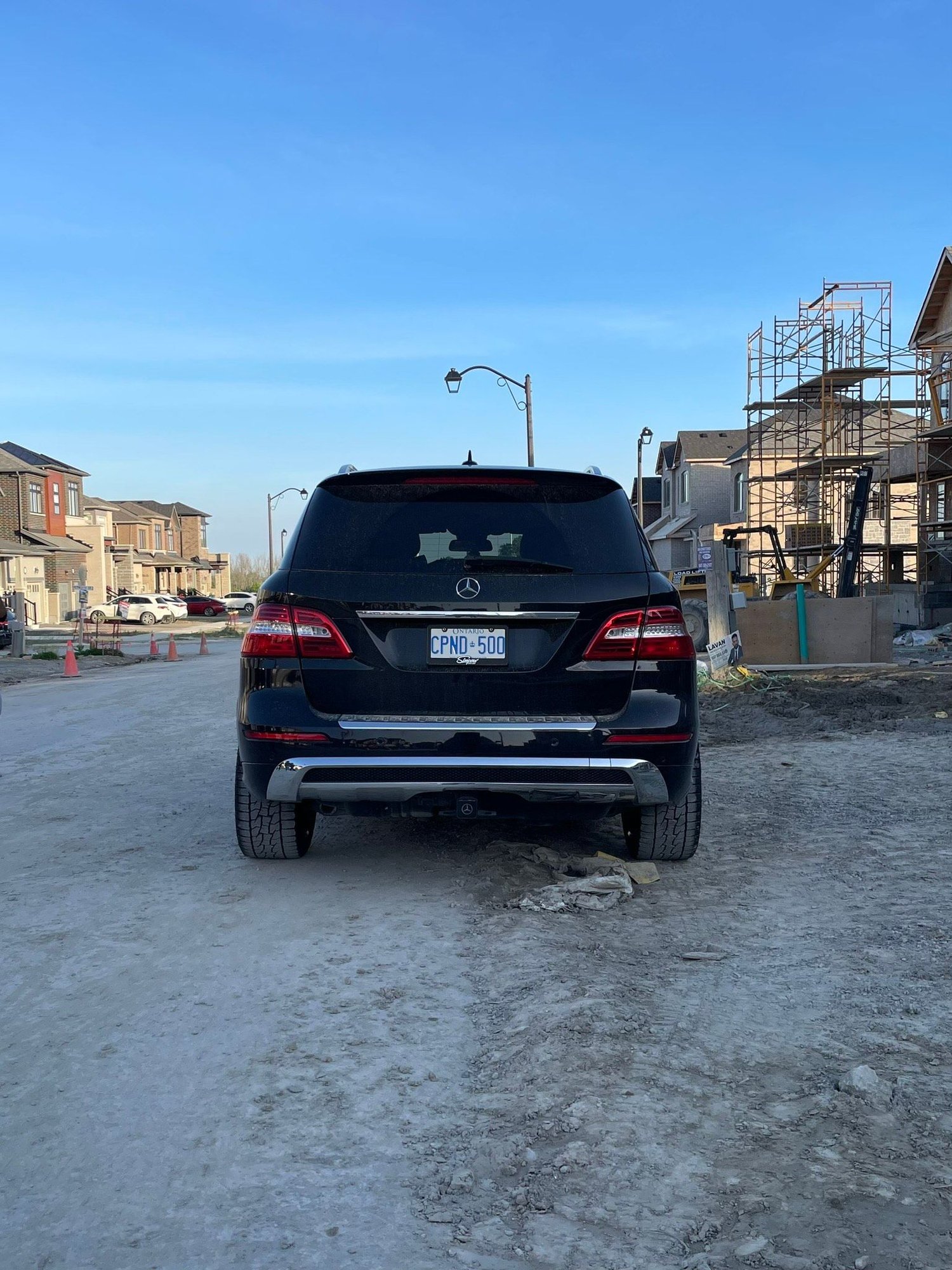

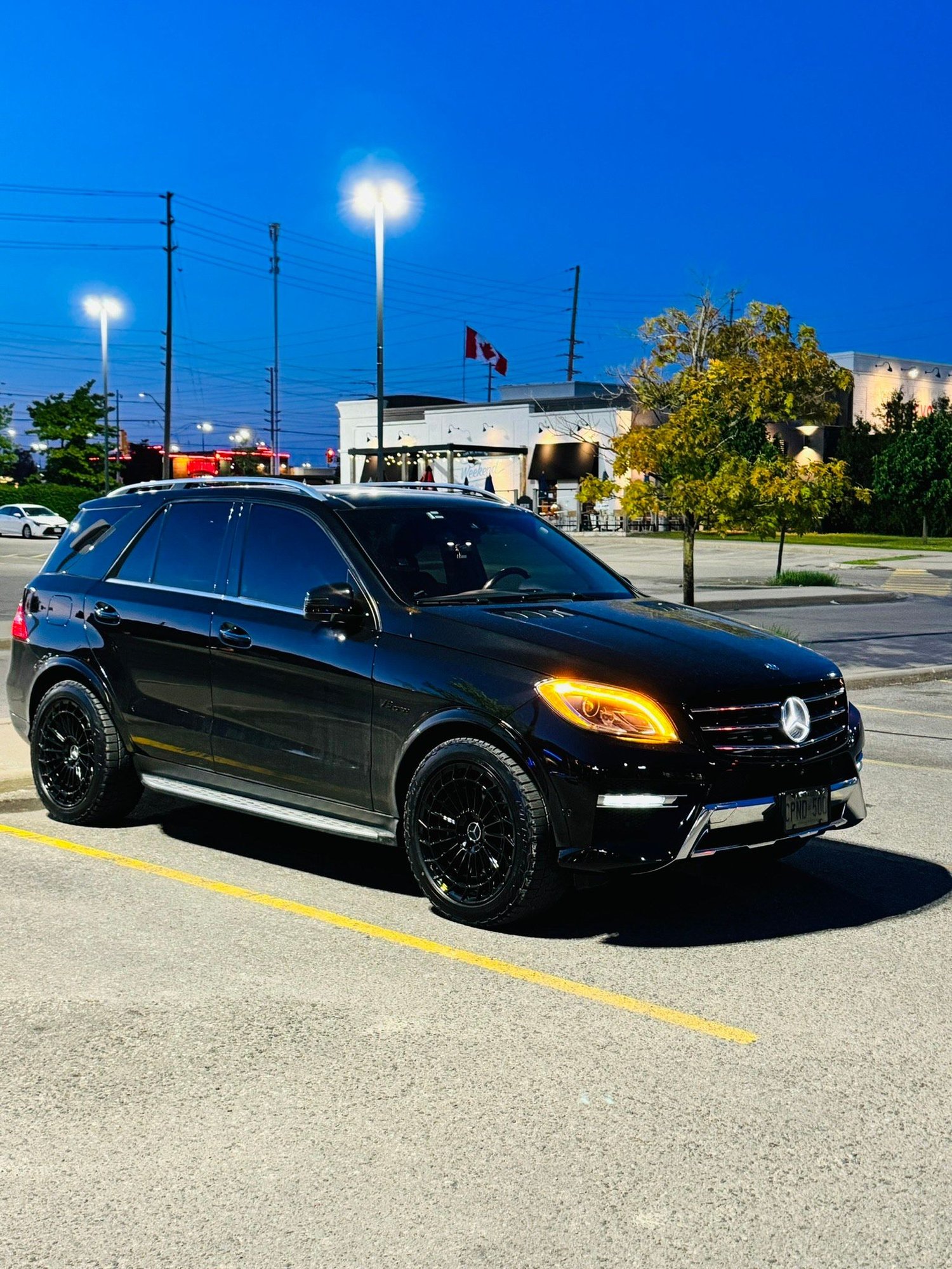

Old Jul 27, 2025 | 11:01 AM
mike919's Avatar
Joined: Mar 2014
Posts: 170
Likes: 61
From: Toronto, ON
86 190E 2.3, 2014 ML350 Bluetec
Falken Wildpeak A/T Trail - 275/45/20
