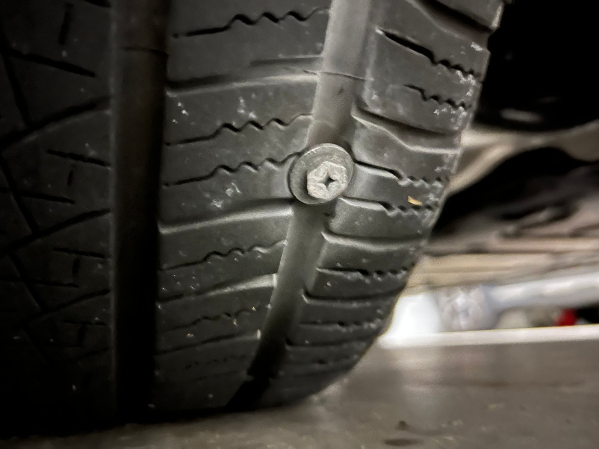

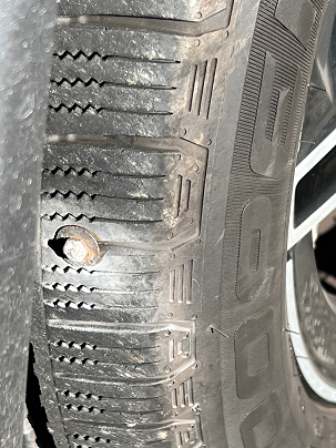

[QUOTE=mb2be;8691218]Wife called saying she had low pressure message. Da@@ only 7k on the clock. Looked it up to see where has one in stock. Some do but they’re all for customers. Ready for repair and order a new one. The tech checked out and said, “I can order you one but you are totally fine with the repair.” So I went with it. They took it off, repaired, re-balanced. What do you guys think about this? Safe for long distance? He said I would be fine. Would you replace?
On the way home I realized how luxurious this thing is (I only drive once in awhile and have not driven for two months). Such a fine vehicle. I just drove below speed limit and enjoyed the Christmas music. Tried to find a reason to drive longer. Filled her up even with 3/4 full. Merry Christmas folks!
You're fine, the location of the nail is center tread. Mine came with Run Flat Tires, and I got a nail in the same location (Rt Rr Tire) at about the same mileage. Had it plugged and put 30K miles on that tire with no issues.

I wouldn't replace that tire, that's easily repairable. If they patched it from the inside, then I wouldn't even give it a second thought because it'll basically be like it never happened.

Tire is fine with a repair in that location. Tires don't "pop" like a balloon. They leak slowly thus the TPMS does a great job in that regard. Did my part recently to help keep the streets clean and safe by removing and having one less nail on them. This one was not repairable because of the location.

@mb2be I was in the same boat last Saturday afternoon. Dealership was closed, so I went to local mechanic. He plugged and patched it. I questioned why both, he said it was better. Probably just another way to double charge me - LOL. It was only $35.
Plug & patch is pretty standard. There is a local tire chain here that does it for free.
The patch seals the leak, and the plug prevents water intrusion that might compromise the patch.
Tiny holes might not need the plug, since it's a tradeoff by reaming the hole to enlarge it, to accept the plug.
A good tire person will know the best way. Unfortunately there aren't many left these days.
I always thought that too, but my tires hop INSISTED one time they could patch a hole in that spot, and since I was there to buy 4 new tires and they were convincing me to let them plug it for free, I gave it a shot. Got another 20,000 miles out of that set of tires and the patch held.
Same here. I did look at the site and saw mine was in the repairable zone. But because this is family's long distance vehicle, I was ready to go in to plug and order. He convinced me not to unless I just wanted a new tire.
