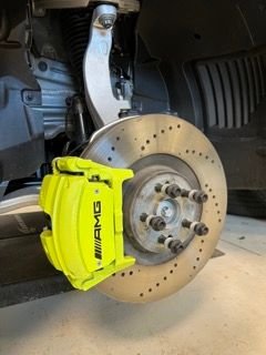

Are the stock brakes 4 pistons? I read on MBUSA that they are advertised as dual pistons......definitely pretty crazy. I think all of the stopping power is coming from the tires, if you go with the 21 inch option the tires are much wider than 20s.
I have the stock and decided to paint my calipers, definitely regret not upgrading based on looks alone as they now seem comically small for my car. Performance wise the brakes are soft but they're sufficient.
Dual piston means 4 pistons. Each side of the caliper has two pistons, so total of four. There's an inner and outer pad. 6 piston rotors means 3 pistons on each side, but nobody calls them triple piston.

The red caliper brakes are not just a different color caliper. They are yet another upgrade. The silver brakes have 15.75 single piece rotors like the standard brakes, whereas the red caliper brakes have two piece composite rotors with aluminum hat and they are 16.5". The silver brakes are the standard 63 brakes and the red ones are the standard 63S brakes.
Here's a side by side comparison of the different AMG brakes. This is not from the GLE. Different models have different size rotors for each one, but it's still the same 4 braking systems.
Ah I see, thanks for clearing that up. Yes I realized the $2500 upgraded silvers were different to the red on the $5200 package given the difference in diameter.

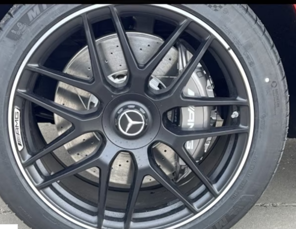

Here's are photos of what the High-performance AMG brakes in "silver" look like. On the MB website, they have the wrong photo which is the standard AMG GLE brakes. These upgraded brakes look more pewter than silver. Personally, these upgrade brakes should be standard on the GLE 53. The standard GLE 53 brakes are really the GLE 450 brakes just with an "AMG" cover on the caliper. The GLE 53 is the only AMG that gets a regular fixed 2 piston caliper standard instead of a Brembo monoblock with 4-6 pistons. I have never understood why... especially for the price.
