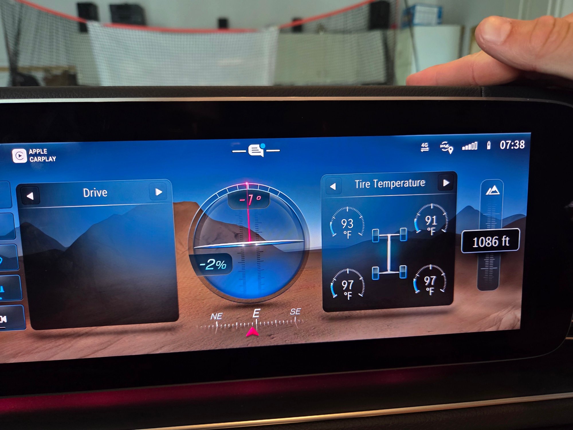

The car is at the shop now and I know the tires aren't changed yet so I was able to take a picture from my app. I would like to know what you think of those numbers, I appreciate any help. For a while I was getting some harsh replies, maybe my style of explaining things is terrible, but I'm self taught in English, realizing i may be all over the place. I am a "stupid girl driver" and only came here with my story to see opinions from knowledgeable people who know these cars. I do appreciate all the replies though.
I never pull anything with this car, i only do local driving, 12 miles to work (90% highway), I take my son to school/ sports on local paved roads, never dirt ,I do running around like shopping, appointments, and such,nothing serious. We do not use this car as our out of town car, we take my husband's truck or Toyota Highlander 2019. On the day I took the car to the dealership i took pictures of tire temps, I do not know why , but I guess just in case, but my husband said temps were normal.

Those tire pressures seem high. My GLE 450 recommends 32 psi front and back. What are the pressure recommendations on the gas flap. Over inflated tires will definitely wear faster.
