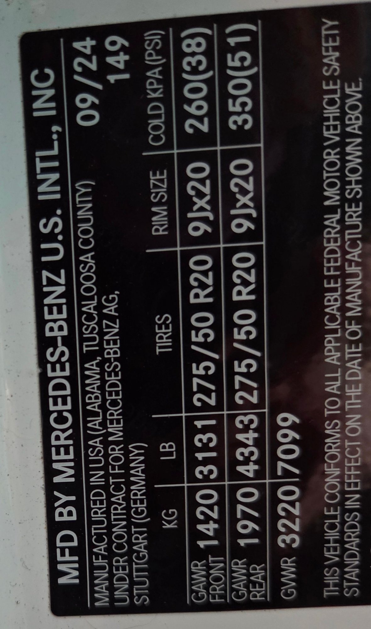

She has a 2025 GLE 450e. It has no tire pressure sticker on the gas flap.
The service manager says that Mercedes no longer puts stickers on the gas flap. (I'm pretty sure they still have to post the sticker for emergency responders. Batteries, airbag locations etc. QR code.)
So the question is, does Mercedes no longer put air pressure stickers on the gas flap on 2025 models?
#2 does anyone here have a 2025 GLE 450E who can take a picture of the gas flap? Hopefully one with 20-in tires?

PM from @Lena (strange that this is how she can post now)
She saw a similar car and it asked to take a picture of their gas flap.
Here it is. They inflated her tires to full loaded specs. She never tows or carries a load she said.

According to the latest owners manual available at MBUSA.com, The gas flap is still supposed to have a tire pressure table.
She’s checking the gas door and not the charger door, right???
