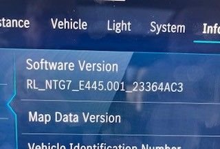

If the software revisions are sequential, mine is newer and has this "undocumented feature".
I wonder if it is possible to downgrade to an older software version. If that stopped the camera problem it would be a pretty simple fix
Interesting thought. If so, I wonder how far back you can go? I'd pay to roll the whole system back to what I had in the 2023 and 2020 GLE. This new version is so dumbed down and a major disappointment.
The pre-facelift runs different hardware you can't go back below MBUX 2.x with the current setup.
Yeah, I figured that.
Hey Mercedes! If you want to develop some add ons of different instrument cluster appearance packages or enhanced infotainment and sell them as a download like you've done with the dashcam and trailer maneuvering, you might make some extra sales and happier customers.

For what it is worth, the 2024 model year GLE I hear reports of not having this behaviour but not sure what software version that was updated started this behaviour.

Originally Posted by arnautovica
Strangely, some vehicles are not affected. It might be useful if people with and without problems could note whether they have a DA package.
Yes anyways, here is also the software version that doesn't have this issue: https://mbworld.org/forums/gle-class...ml#post9124214
I have a 2024 GLE450. I don't have the problem, and I do have the Driver Assistance package.
Thanks. So it is not a DA package. My software is RL_NTG7_E505.404_24441AC3
