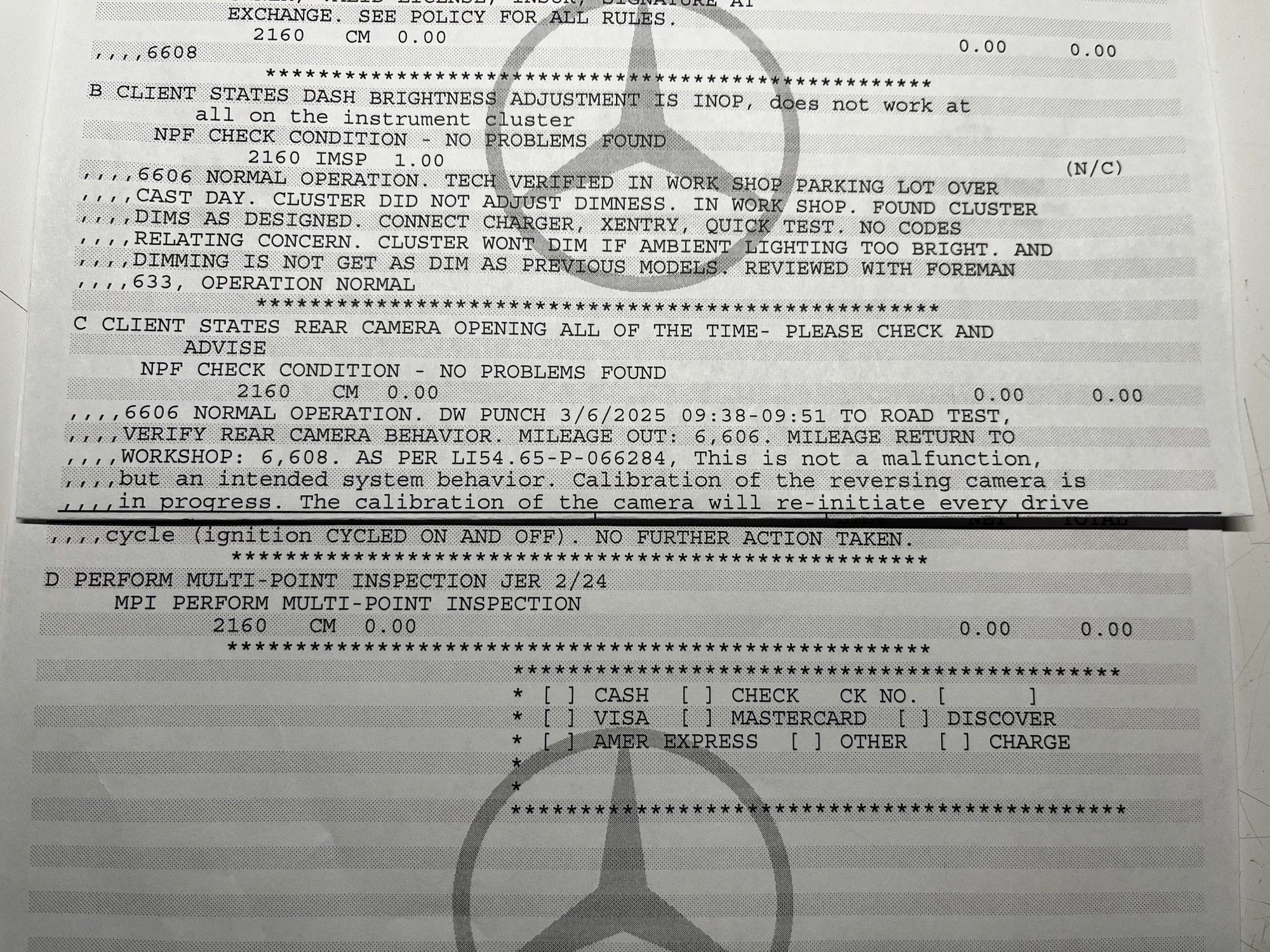

Just an update. Had my car in for this complaint and MB is still saying it works as designed. Don't hold your breath waiting for them to do anything about it. I also complained about the dash brightness, it's blinding at night. The control in the settings only affects the infotainment side of the screen and not the instrument side. The small roller wheel near the headlight switch affects the backlighting for the steering wheel controls but has a minimal effect on the instrument screen. Again, MB says this is normal...suck it up.

That is a disappointing answer.

Since my repair order referenced a LI document, which as I understand is their version of a technical service bulletin, wouldn't all dealer service centers be bound by the same policy from MB corporate?

All dealers follow the same playbook. The insulation helps only about 10%. Mine told me recently they were aware of the complaints and that nothing was going to be done. I even tried to trade and the offer was terrible. They must be glad to have sold another GLE with the problem and don’t want it back. They say it is performing as designed to prevent lawsuits.

True, I should had paid attention, that stinks : (
The other problem with the camera popping out sound is especially true for an SUV like a GLE where the cargo shares the room with the cabin so there is no trunk to isolate the sound. It is annoying to hear it all the time when the GLE is so isolated, those sounds are like amplified.

Reason why I suggested trying a different dealership was because experiences vary from each one due to being independently owned but in this particular case is there is a XENTRY Tips document stating it is normal behaviour then it would be no use going elsewhere.

Kind of blows my mind MB spent the time in explaining with a XENTRY TIPS document and didn't just issue an update to stop the behaviour. Unless I am missing something?
